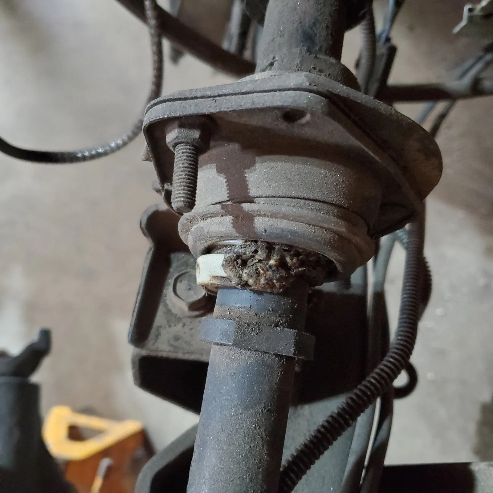

That bushing can be totally shot and it's not gunna wobble or anything . The bushing is just to support the steering shaft.
Mine was melted from the headers on my V-8 and all I noticed was a little rough as the steering wheel rotated.
You need to find out what is moving as the steering wheel turns and why the shaft isn't turning.

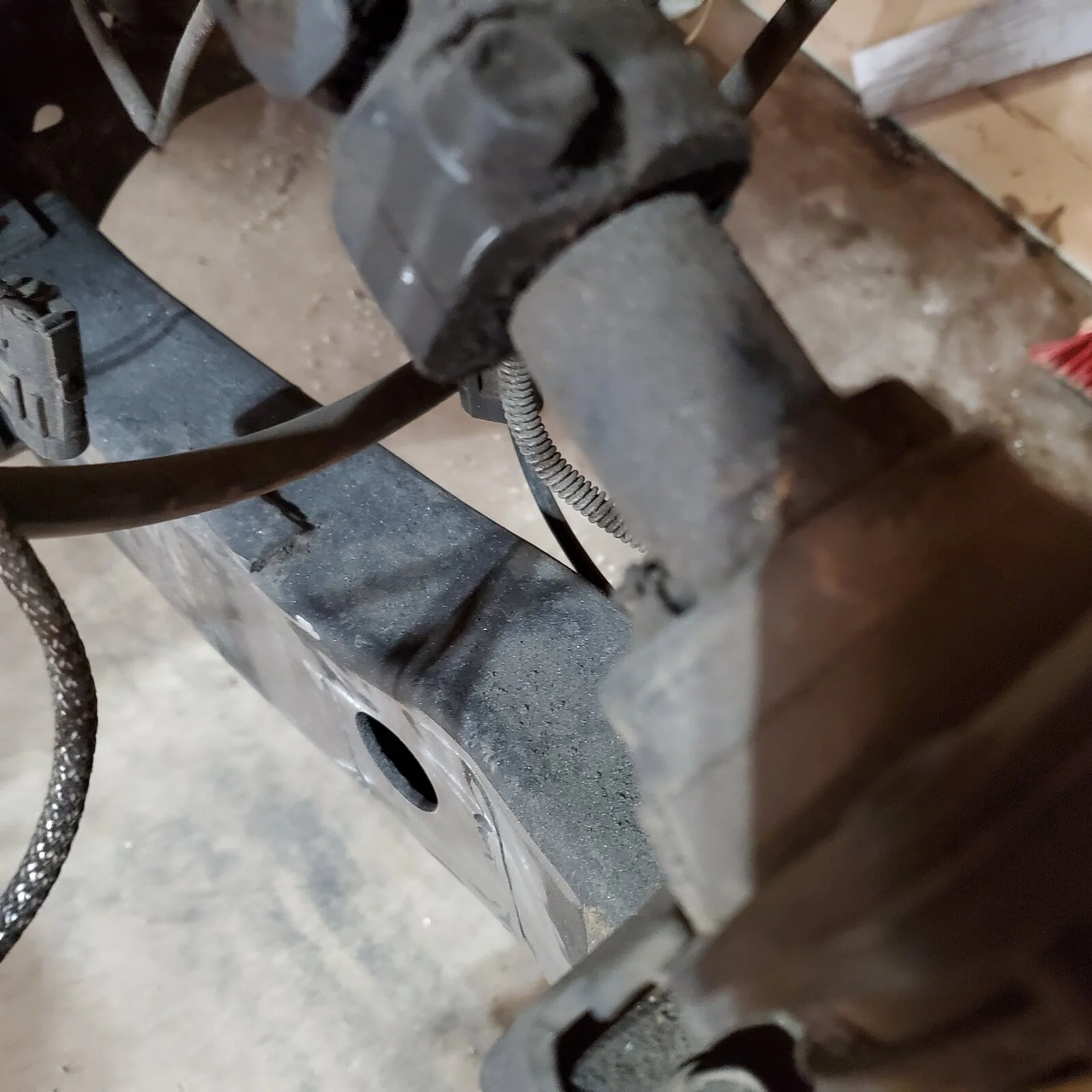

Okay so I found that when I turn the steering wheel in the slop area, the entire shaft is moving, as well as, the steering box. It’s a new/refurbished box but I’ve heard they can crap out fairly quickly. Does it sound like that’s the case? If so, is there a better, heavy duty steering box that can handle bigger tires? Thanks for the help!

I’d lean toward the gearbox on that much dead space, but may be wrong, good to check those connections, the steering wheel diameter magnifies any play for sure
