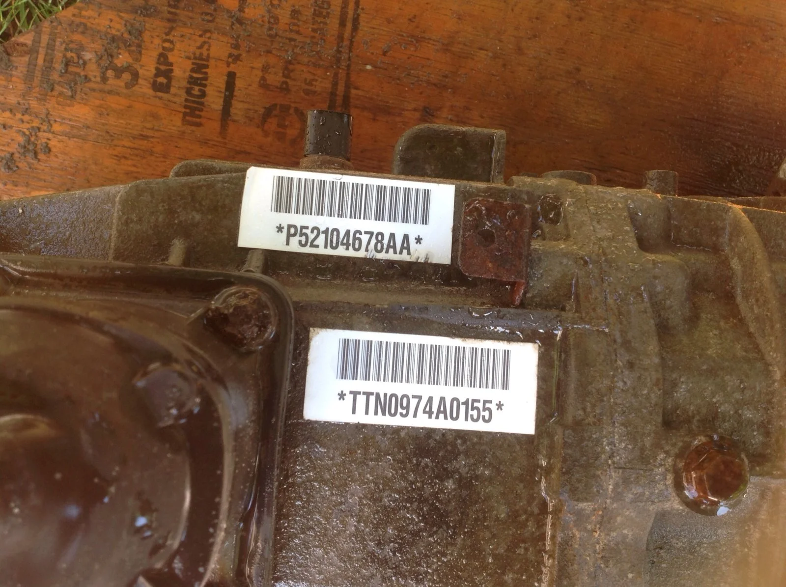

This is the tag on the train is this how you tell them apart and can somebody identify these tags

Thanks for the all the information I had to replacing the transmission kind of stinks hers had 74,000 i purchasing one for 750 with 124,000 I was wondering since it had more miles I would like to do some type of flushes does anybody know of anything to add or I'm just going to put the oil in the transmission then I will change it after a couple of weeks thanks again for all the help
I have everything put together I'm just waiting for my u joints they were supposed to be here today
