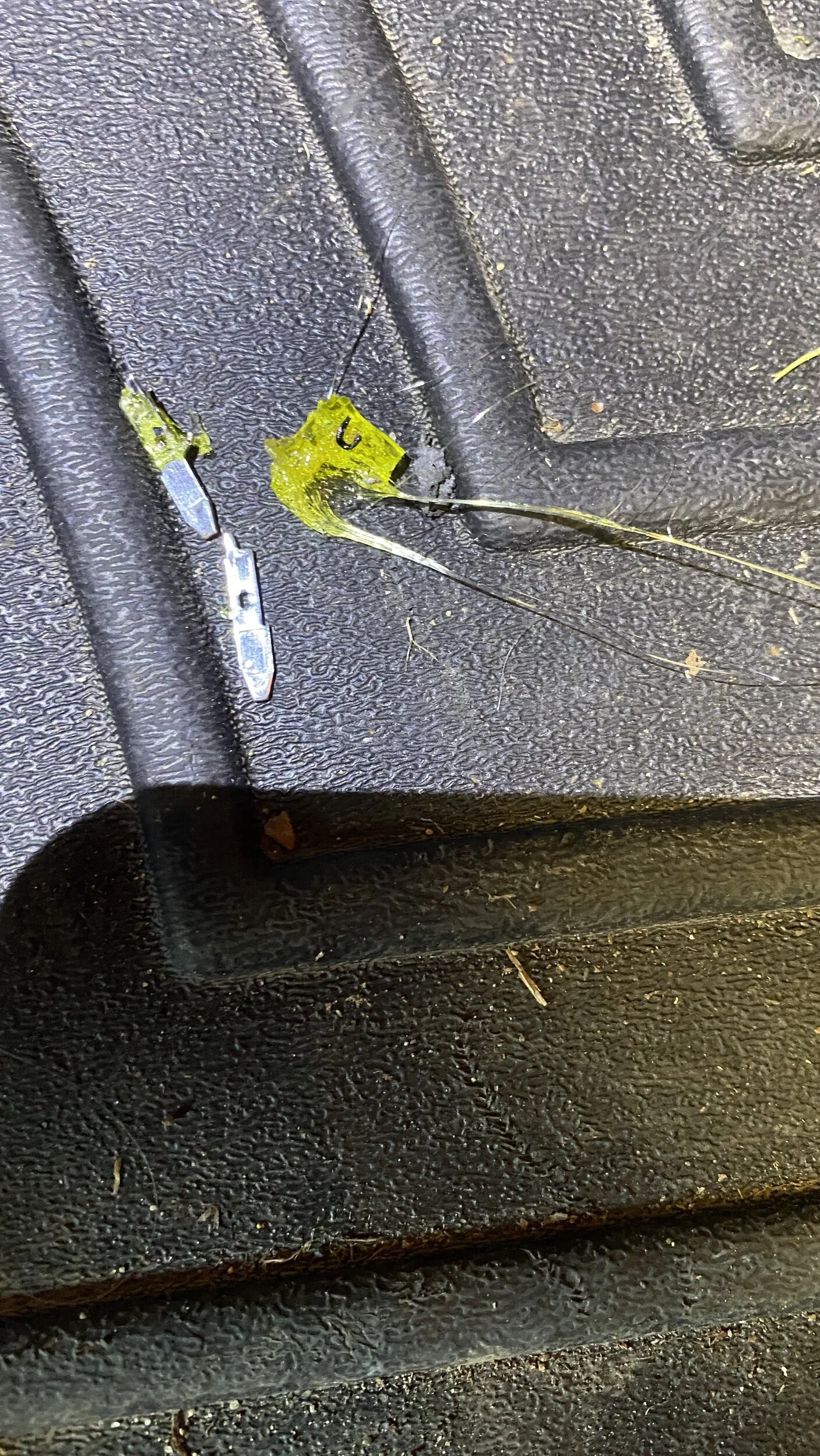

Fuse #1 was glowing and I removed the fuse quickly. It was extremely hot and blown. I put another fuse in and the sequence is it gets hot and starts melting the plastic, then blows the fuse, but keeps glowing and melting the plastic. I cleaned the fuse blades and fuse holder as well as I could with no change. When I put a new fuse in I see a spark in the input side and it Immediately gets hot.

If the tension in the fuse holder is not good then the connection will not be good, and heat will build which can blow the fuse.
Aluminum oxide can also build up on the fuse blades causing a poor connection with the same result.
Not sure how to fix the tension in the fuse holder. I can get better fuses with a thicker blade for a better connection, but the original fuse was a good fuse. Some of the others I tried were lower quality Amazon bulk.

I’ve read that:
