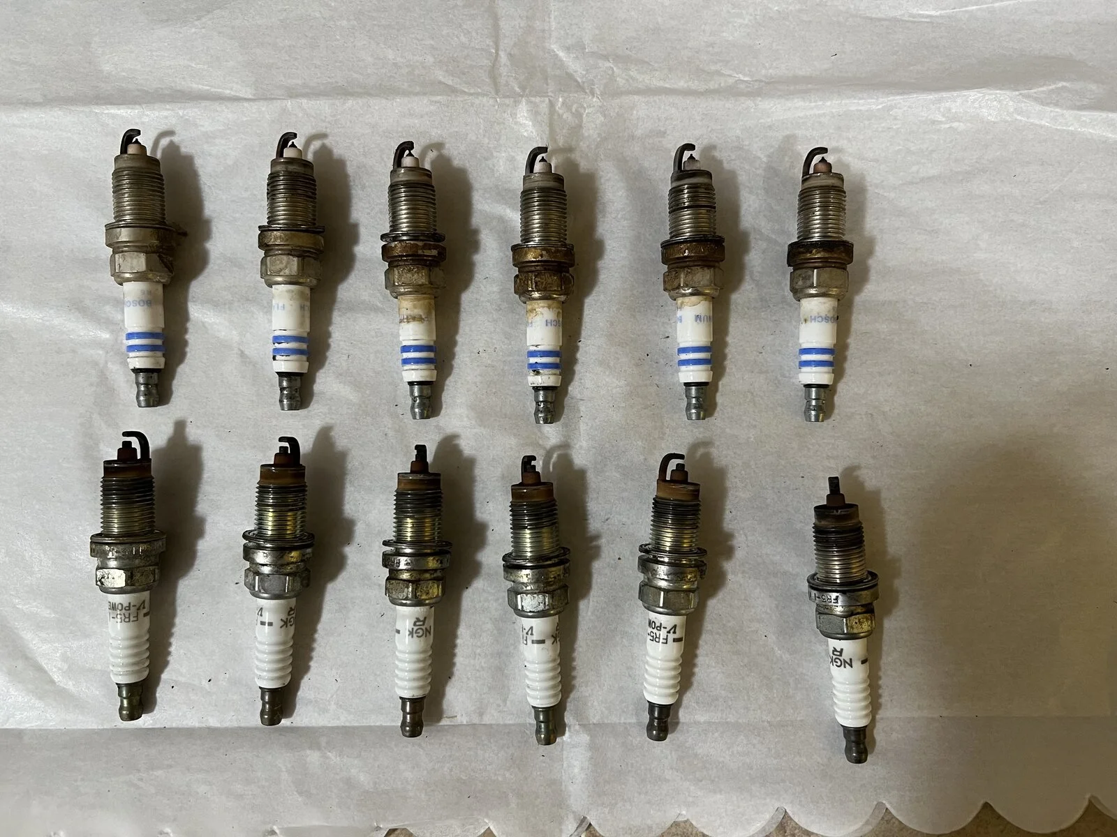

Pulled the spark plugs and while there is no damage, they are all much darker than the previous plugs I removed 10,000 miles ago. Considerably darker. What’s interesting is that the #6 plug from the older plugs is the only slightly darker plug, consistent with a single misfire.

So I guess my question, based on the color of the spark plugs, are we thinking too cold of plugs causing it to misfire? Hoping this mess is behind me, but I’d like to understand the cause.
Plugs on top are the older plugs. I have no idea how many miles on them (previous owner). Plugs on bottom are around 10,000 miles.
