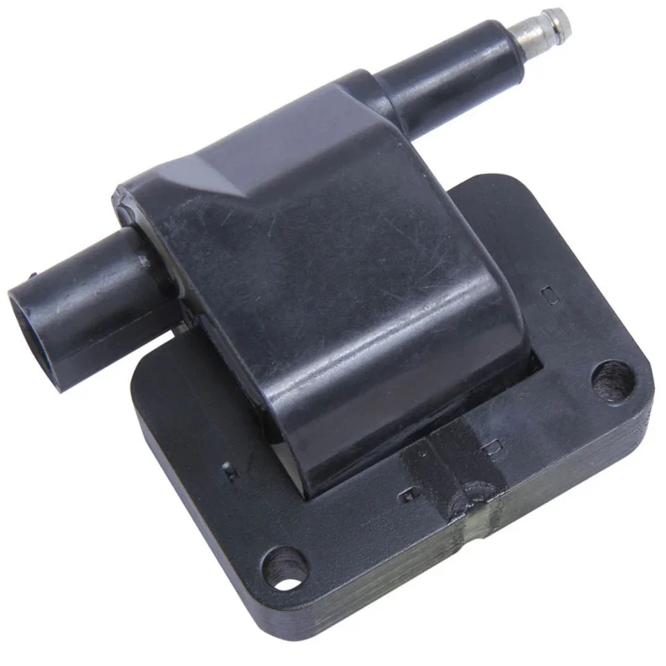

Did you try replacing the coil?
Not yet. That was a thought I have a half hour ago. I will try that.
If that not fix the issue, I suggest to start thinking in replace the PCM. My TJ 2.5 1997 had 8 different codes and no one can be cleared after replacing parts or sensors or trying restarting many times the PCM with the scanner, no luck. When I changed the PCM with a new one rebuild, start working perfectly, just get 2 new codes, 1 already cleared replacing the part and the other one will be cleared changin another part that works only with mopar brand (suggested in this forum), the engine start working fine and I had a "no gauges light" also the oil gauge start working again.
