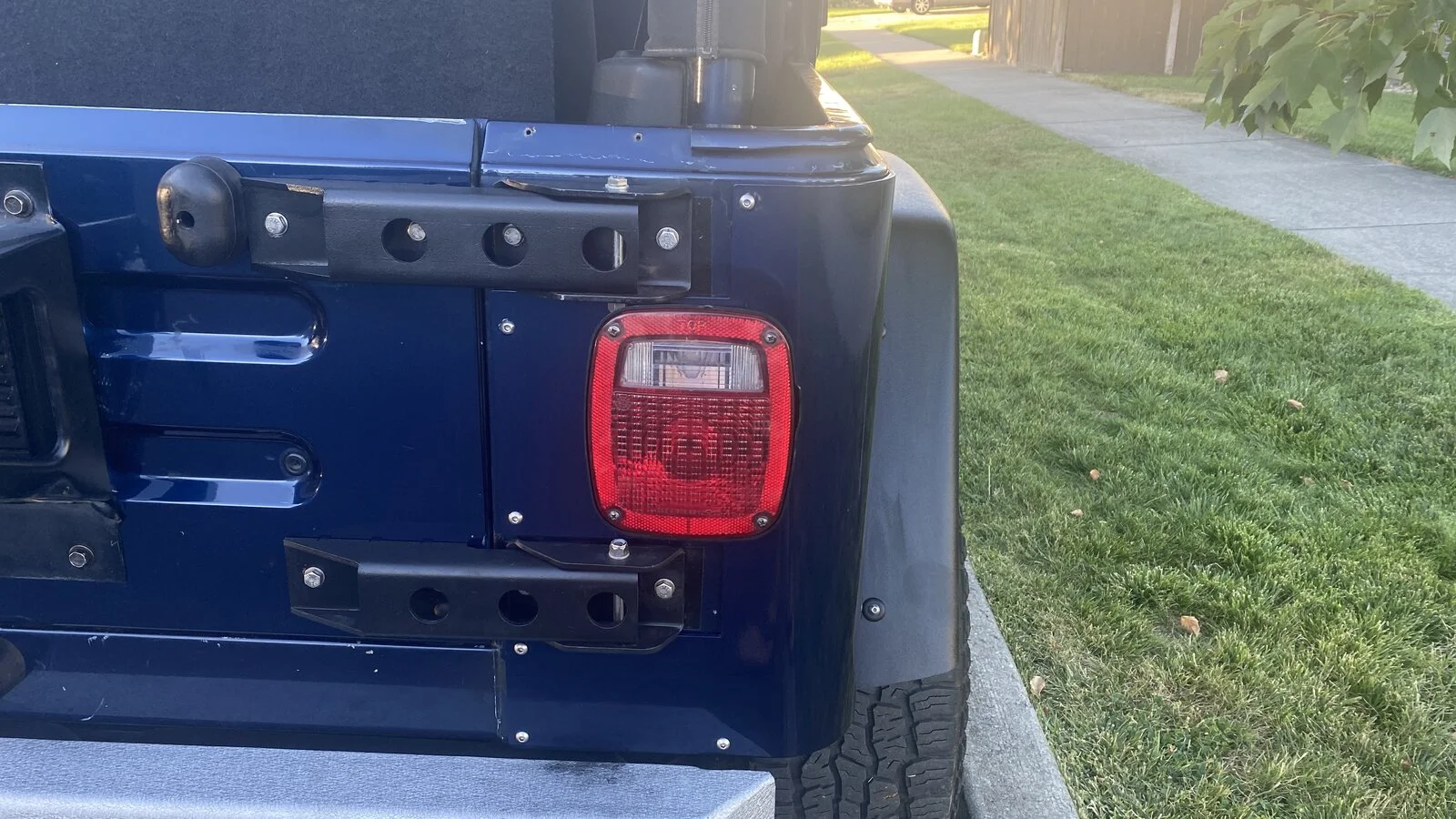

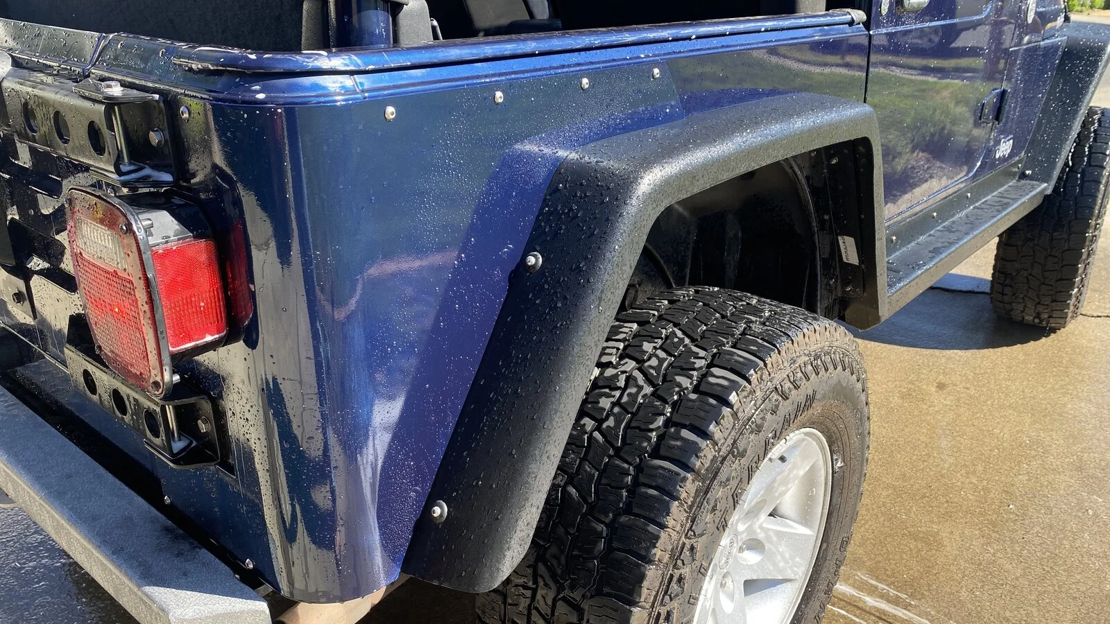

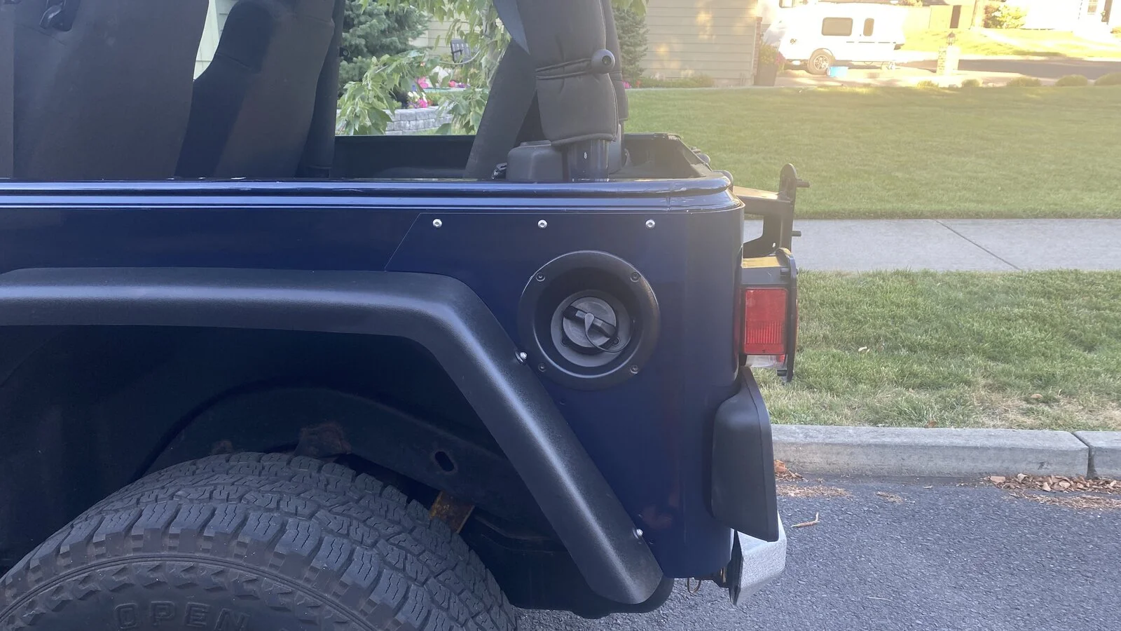

However, I do think that while prep might be the same for both, it is much easier to get monstaliner to look good than it is a glassy smooth glossy clear finish. I'd be inclined to say that the sanding needs to be finer for a glassy smooth glossy clear finish. There's just so much that goes on to get the paint to lay down just right without orange peel. I've had some good results. I just think (no experience) that laying down monstaliner would be easier and require less to get it to look really good. I also sometimes think they look really awesome and can stand up to trail abuse. My .02c
My good results on some corner armor (doing a whole Jeep would be a ginormous task for me): these armor pieces had Primer by ERA, Perfect Match by Duplicolor and 2K clear. EDIT: just noticed the first pic they are wet. That was the first bath they were getting. Still helpful I think. Reflection is pretty close compared to the door which is factory.

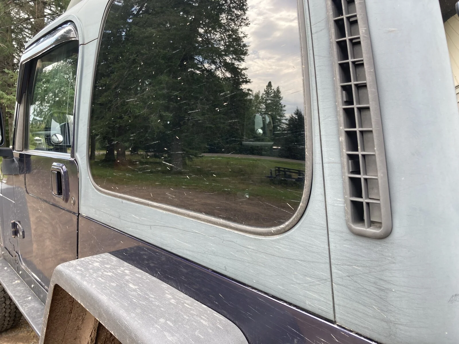

My Jeep is a little dusty and dirty right now so it harder to see, but this section of my hardtop is about what the rest of the Jeep looks like too. And there is a small branch hanging off my passager side rear view mirror as we speak!.....lol
  • Wow
Reactions: RINC and JMT
I think that pic alone sells the whole bed liner outer coat. And you can see the beating the paint has taken. To re-paint and put it right back through the same stuff that did this and expect a different result is the very definition of "insanity". I like the mantra of having a purpose behind every mod, well you have your declared and proven purpose right there. 2 cents given and spent ;-)
