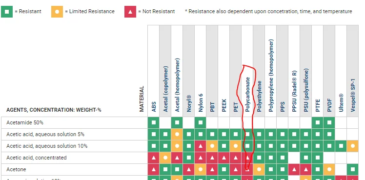

It depends on the plastic. The term plastic is far too generic to make generalized statements about the effects of acetone on plastic without know which plastic we are dealing with. PVC, ABS, and similar types will melt and smear, polyethylene, polypropylene and similar don't care. We have to know what the flares are made of before we assign any answers.

How fast it dissolves or alters it has nothing to do with whether something is acetone resistant or not as the chart shows. Acetone is bad for polycarbonate.
