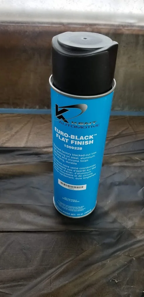

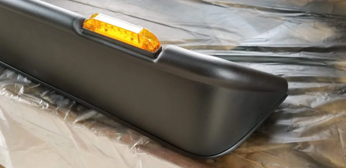

Well we're done. I just finished painting the flares after putting down the adhesion promoter. I used satin SEM Trim Black. And it appears to have taken perfectly. Most all of the dye came off with grey scotchbrite pads and water. Dried them. Used something to wipe them down. I forget. It wasn't lacquer thinner but something similar. Then I laid down the promoter. And then 3 or 4 light coats of the SEM black paint. I also used red paint can nozzles from a seller on ebay. Which improved the coverage IMMENSELY! I can't recommend them enough. I've used them in the past. And they really get the paint from the can onto your surface to be painted. Also in nice long even coats. Each cap has an adjustable fan spray. You can lay it down vertically or horizontally.
https://rover.ebay.com/rover/1/711-...0001&campid=5337789113&icep_item=253074790739
They look just like the SEM paint can nozzles. But the spray is not the same. The red caps lay down the paint MUCH better than standard spray nozzles.
There hanging in the garage drying. We're gonna put them back on tomorrow. Thanks again, @06TJ35's !!!
To the guy that didn't use adhesion promoter. I wouldn't worry about it. I'm just being anal. And it's too much trouble to bother yourself with stripping them again and repainting imho. If your using good paint. It should hold just fine.

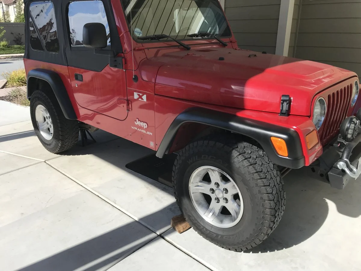

I painted my original flares before buying new ones (mainly because as they age and wear, the texture comes off ) and they just start looking like crap even with a nice new paint finish. But it lasted about 8 good years with driving, washing and shining them up on occasion. They're about 4 years after paint in my avatar pic.
Same method (I wouldn't change a thing):
Remove
Wash well with Dawn
Wipe down with Wax & Grease remover
Adhesion Promoter
2 coats of paint
