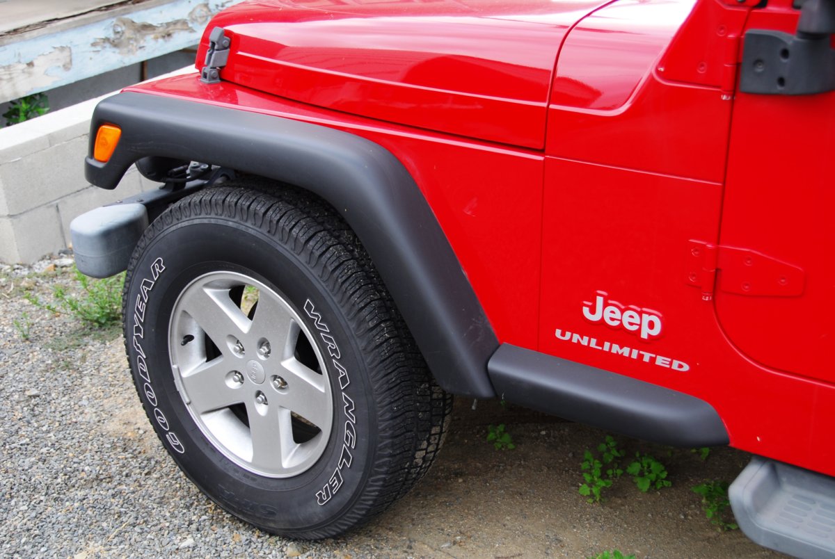

Plastic adhesion promoter for painting fender flares?
Which is splotchy. And, all you're doing is migrating the plasticizers to the surface where the sun can get to them and ruin the appearance even faster. It is a short term half ass solution at best.
I did it about a month ago, no splotches, perfectly consistent.
Given you're at best batting a 500 on this, I'll wait and see if your longevity concerns have any basis in reality.
Good luck.

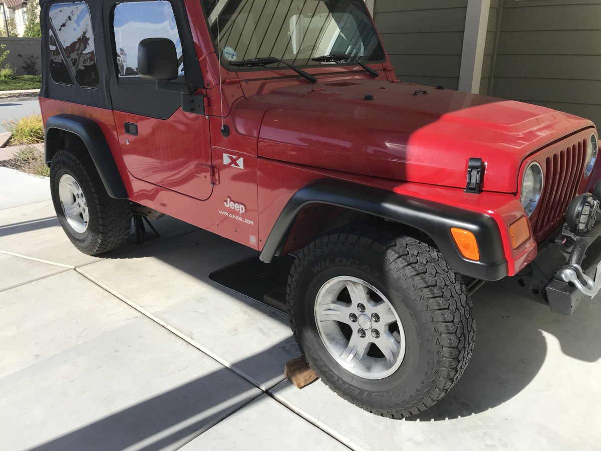

Any pics?
Yep, now pics and pics 6 months from now after being in the sun. This is a couple years in the SoCal sun, closer to 3 done with SEM color coat and low luster clear.

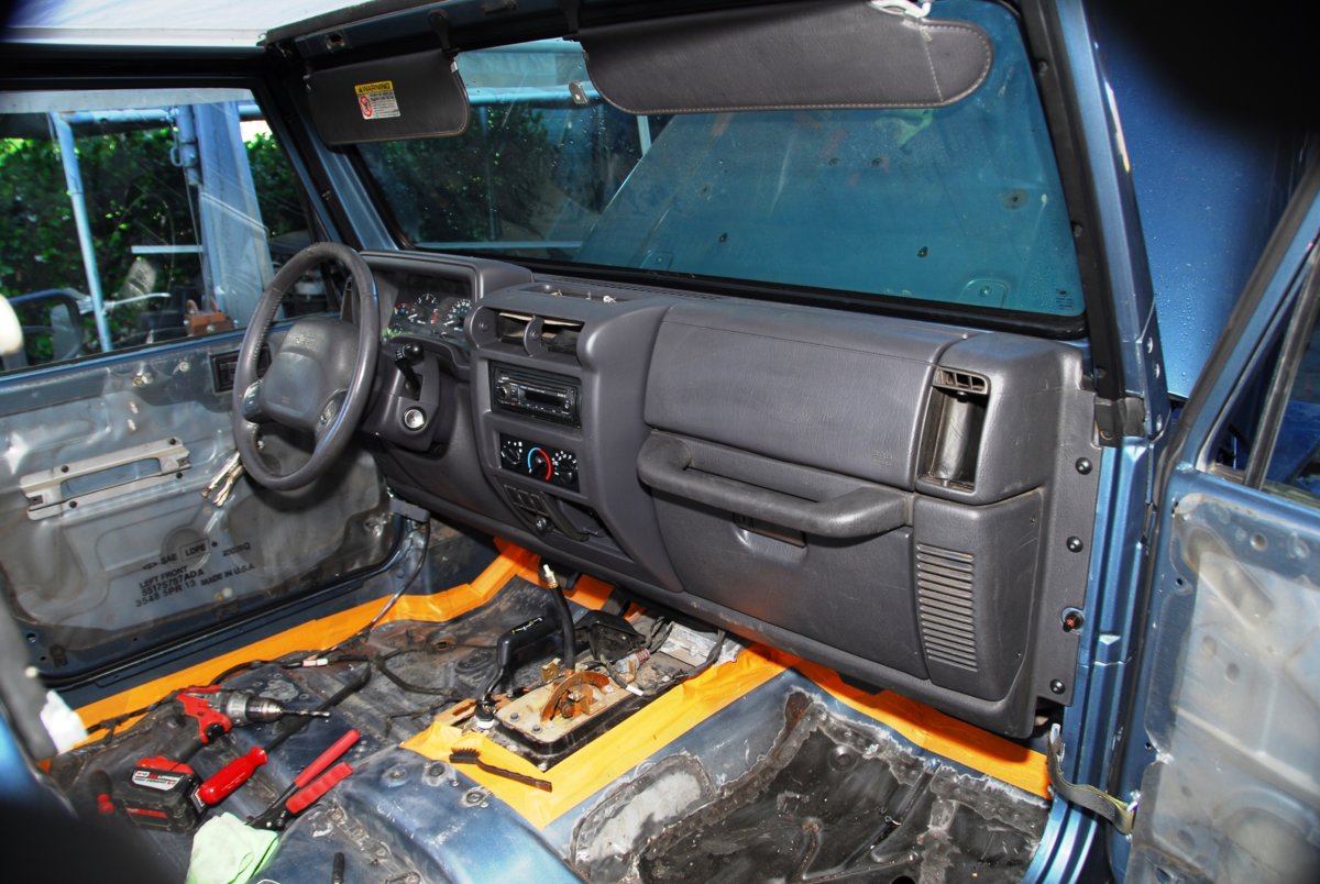

I just finished a set of exterior plastics. I'm refurbing one that I sold. So far on the interior I've done the steering column clamshell, the instrument cluster, the defrost dash trim, door panels, and the center dash bezel. SEM is pretty good stuff. About as good of a match as you will get with a rattle can.
Reactions: Aloha Joe
What color did you use for the door panels? When I did my half door project, I did not use SEM on the inside panels, and was very disappointed with the results.

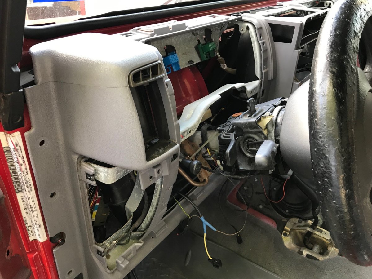

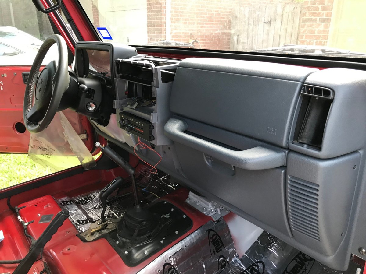

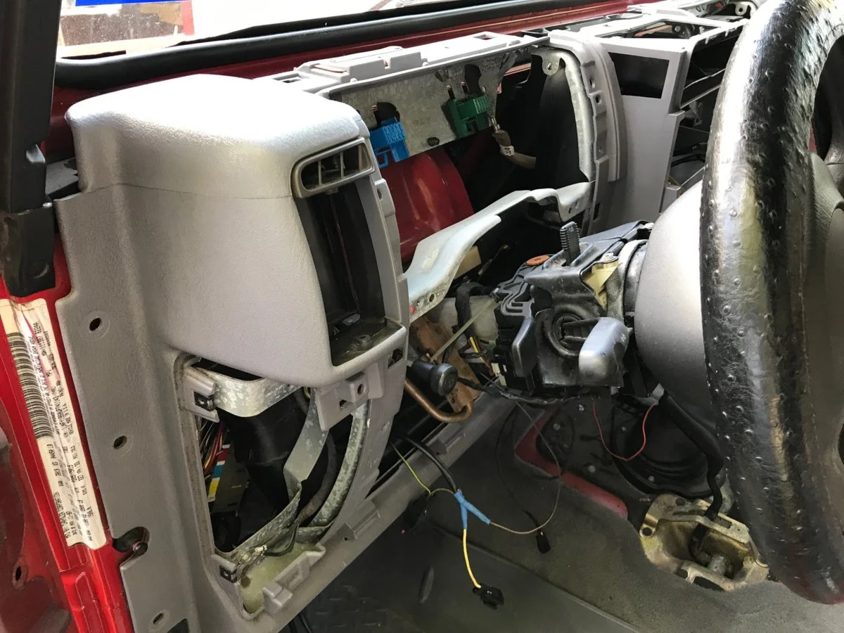

In the process of doing this to mine. I think me and Mr. Blaine were sniffing fumes at the same time. Went darker but used all SEM products except for the wax & grease remover.
Before (light gray, but faded)
102353
After (Graphite)
102354
That is the SEM Classic Coat in Dark Slate Gray. To be clear, I didn't paint the glove box door, knee bolster, air bag cover, speaker vents or the main dash. Just gave them a good scrub in hopes that some sort of Armor-all like surface treatment will make them presentable.
I'll get a side x side of the door panels to show the difference.
That looks really good. Which SEM, Classic or Color Coat?
Thanks, as you know it's a lot of work but results are satisfying especially in these older vehicles. I'm using Color Coat here. Jeep was repainted last year and this darker gray looks really good against that red. But i've used the Classic Coat on my F150 with good results as I stayed close to the factory color there.
