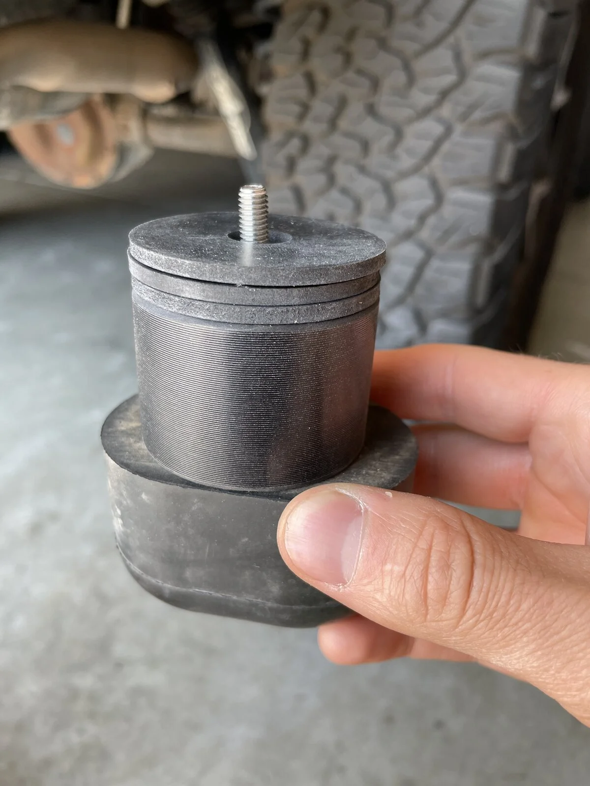

Depending on your setup your rubber snubbers may not be long enough. I used rubber mallet heads from harbor freight and drilled holes in them and then you can cut them to length.

That’s a good idea. I got on McMaster and ordered a 2in diameter rod of solid PVC and used that as spacers. It worked well.

That’s a great idea. What worked for me was buying some rubber washers from Lowe’s that are the same diameter as the spacers that came with the Morryde kit. This worked very well as each snubber had to be extended to a different height. This will all depend on what tire/wheel you are installing.

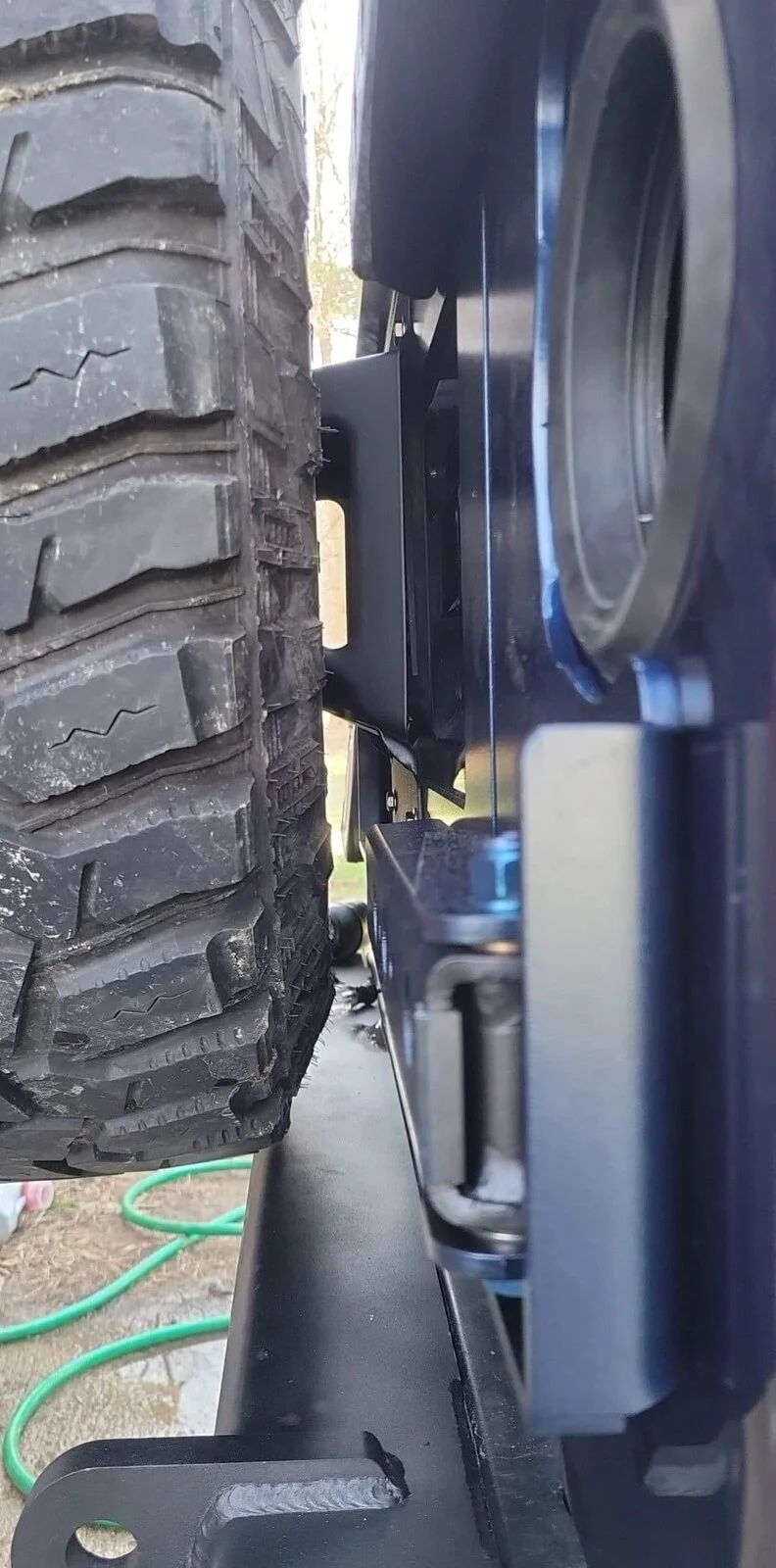

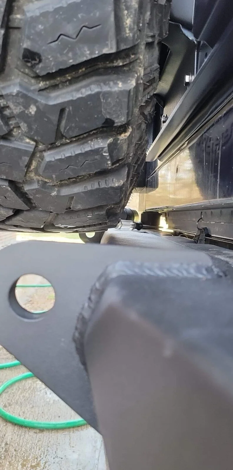

35, stock carrier, without the brackets to raise it. As others said, did have to adjust snubbers.
