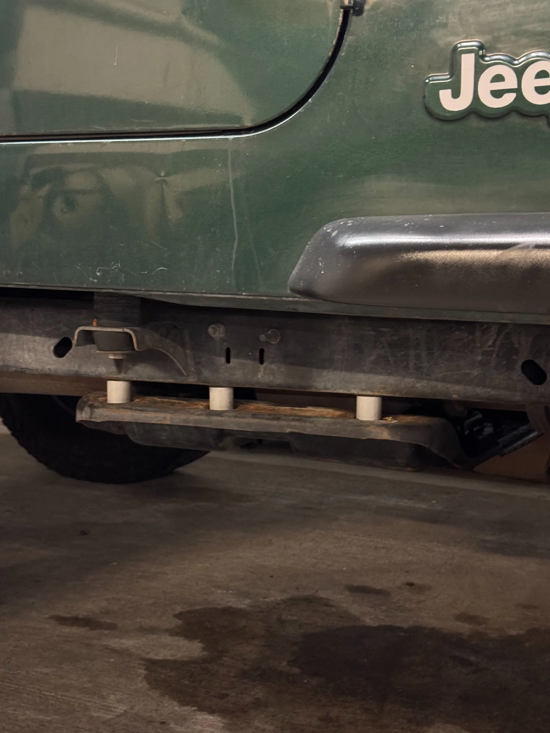

Hi everyone,
I'm about to replace my worn out motor mount, and I'm trying to understand what benefits I'll get from motor mounts 1-inch lift.
I have 2001 4.0, 2 inch lift and 1 inch body lift.
Do you recommend the motor mounts lift? what's the pros and cons?
If I lift my motor mounts 1 inch, does it mean I can get rid of those ugly skid plate spacers? (see picture)
Thank you guys, I appreciate it!!
If you do this, try to get OEM mounts and simply add a 1” MM spacer. If you have vibes due to the 2” lift and that’s why someone added the TCase skid spacers, then it might work out that the 1” MML raises the engine and tilts the rear of the transfer case down enough to eliminate any driveline vibes due to the poor angle. Many people have had success with this type of modification. If you do the MM alone then you will have to move your Fan shroud up 1” to clearance the fan and this will require you to notch the fan shroud so the upper radiator hose clears.
I did an Anchor 3 piece kit off Rock Auto...two motor mounts and a transmission mount for like $25.
Then I used JKS's 1" MML spacer kit. (And a Black Magic Brakes 1.25" body lift... probably not necessary in your case.)
I removed my 1" transfer case spacer by installing a SYE - slip yoke eliminator, a new rear driveshaft and upper adjustable rear control arms.
-Mac

I have the exact same parts and I’m trying to figure out how the motor and tranny can be supported during install. Any pointers?
Support at the transmission bellhousing
