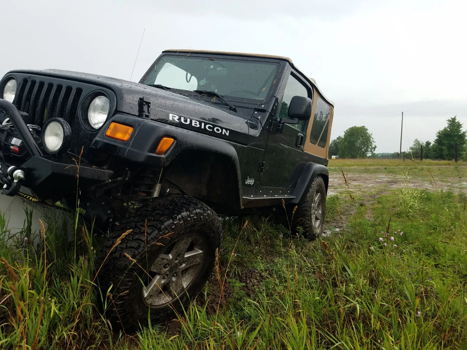

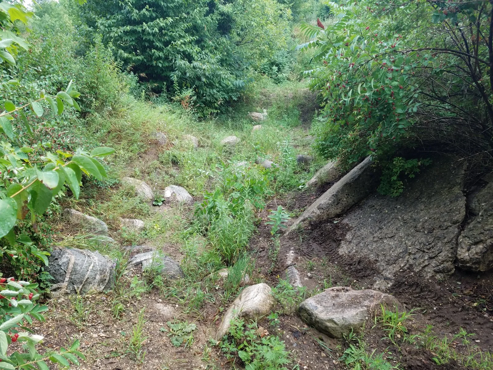

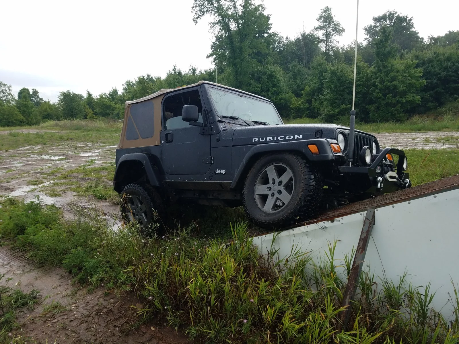

Did a test run today at an offroad park called twisted trails. Lots of hill climbs and sand. Weather was rainy, so it was pretty wet. This was the first time I've really wheeled the jeep since I installed the lift and stuff. It did very well. Everything just seemed to work. My lockers are not working correctly, but I didn't really need them today.
The trails were either really easy, or way too difficult for me to play on, rolling solo. Still had a Good time.
Little flexing...
One of the few moderate areas I went through. Had a buddy riding shotgun, so he spotted me through.

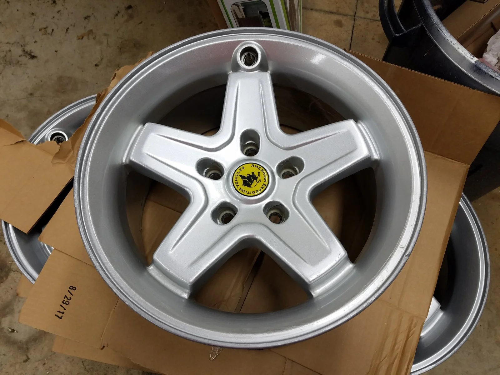

Big day today for the jeep. Ordered a couple second hand locker pumps from davey's jeep. Mine were acting funny last time I was out and they are super rusty. The end caps have fallen off and exposed the pressure switches... so I figured it was time.
I also took a little bit of a drive, and picked up these bad boys!
5 of them, plus two 285/70r17 General Grabber AT2 tires for 300 bucks. The tires are in decent shape, so I'll keep one as a spare and sell the other. It's funny how patience works. I gave up on getting Pintlers, kinda. I couldn't justify the prices they were getting, plus paying to ship to me. I did find a set close'ish, but they were pretty beat and dude wanted a lot for them. I respectfully declined. Well, about a week later, he asks if i was still interested, and gave me a price I couldn't say no to. 5 wheels and two tires for 300 dollars. I'll need to refinish them, and the rim lips are rough, but they will clean up nice and I won't feel too bad when I scratch them up wheeling.

Oh, hell yeah!!! Nice!

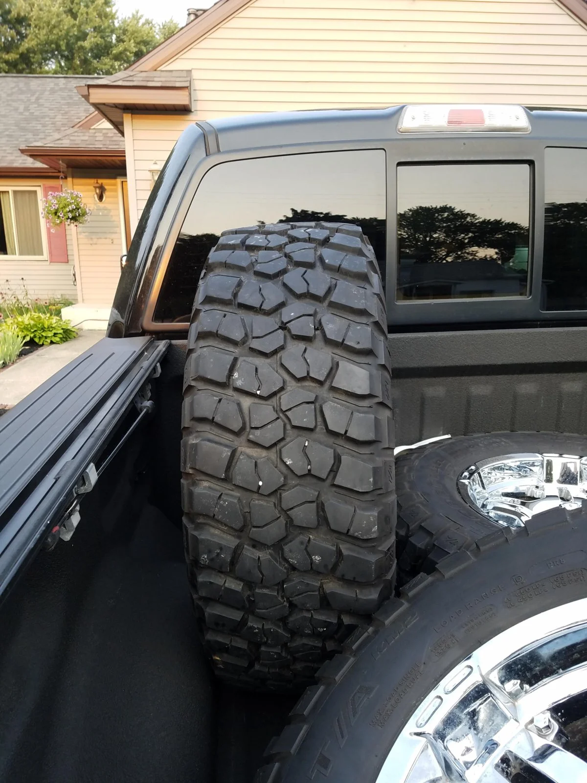

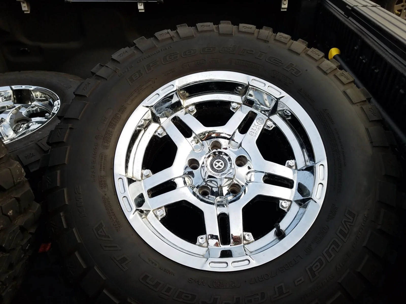

My new wheel and tire setup is getting closer to completion. I had to have one of the wheels welded... Had a small crack in the lip from dropping down on a rock. That is finished, just need to pick it up. I also picked up a new to me set of tires from an older gentleman tonight. He and his wife had a JK that was totaled out earlier this year. He had some aftermarket wheels and tires for it that he ran in the summer... Well, since the Jeep was totaled before he put the summer wheels on, he listed them on Craigslist. I was the first caller... Picked them up tonight.
Tires are around 13/32 tread depth, so plenty of life in them. BFG KM2's . Load range D, 285/70R17. I was really leaning toward 35's, but after keeping up with all the guys on 35's on my last trip, decided I didn't need to go down that road. My Jeep is built around a 33" tire, and that's what these are. They look quite a bit bigger that my 32 x 10s too. The wheels will be going on down the road... Though my wife said she liked them : puke:
Anyway, if someone here likes them, let me know...I'll make you a good deal. They have about a 5" back space, 5x5 bolt circle, 8.5" wide, and 17" diameter. With a standard adapter, they should get you around the magic 3.75" backspacing you need for 12.5" wide tires on a TJ
Edit: almost forgot the best part... The price. Guy was asking 800, but he sold them to me for 680... Because I didn't have a 10 and fiver for 675. Once I sell the wheels...I'll have a pretty cheap set of tires!

Yes. Sell the rims! LOL Just not seeing those on a...well...on anything! ;)
Geez, I’ve been missing a lot. Nice moves, and no exlax required, though I vote for the bro rims and passing the Pintlers down the line, to me preferably. Should come out good on those tires when the wheels are gone! Great stuff!
