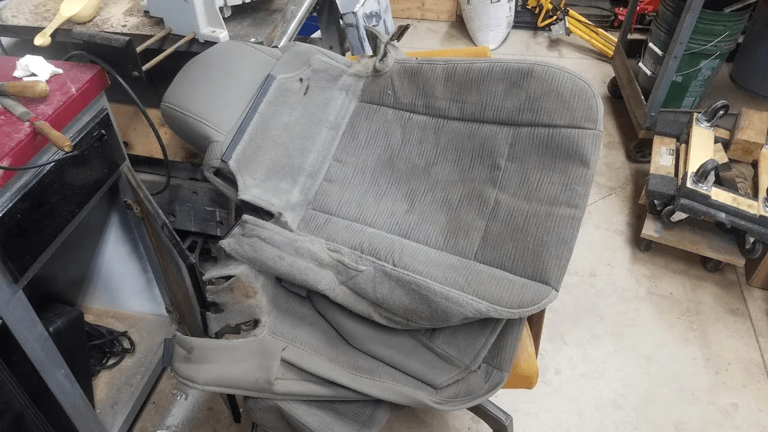

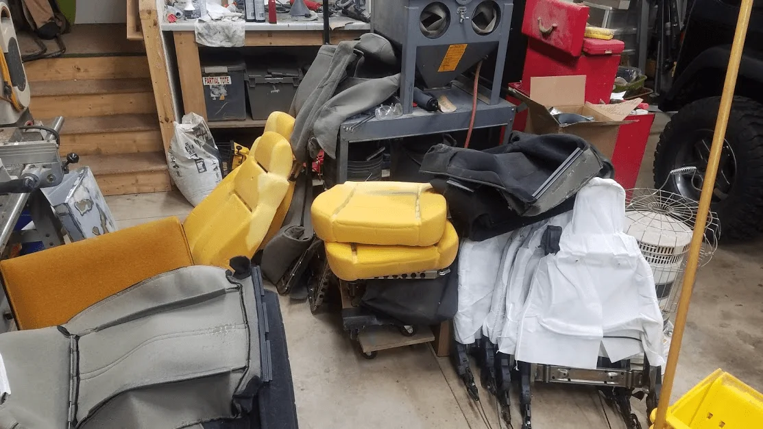

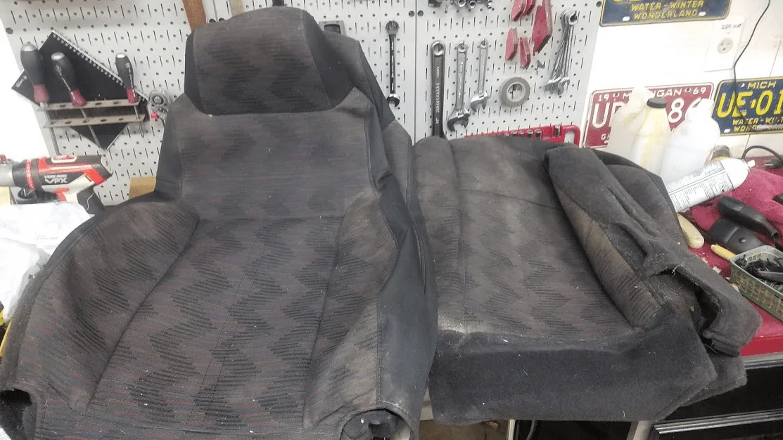

Today I started working on my front seats. I've been noticing that after an hour or two in the seat, my hips start to ache. This is a rather recent development, as I've driven my TJ for 10 hours at a time with no issue. I just figured the foam was finally worn out. The ol girl does have nearly 140,000 miles on her...Plus I'm not a small guy. So I've been keeping an eye on the local classified for something that might work. On Christmas eve, I noticed someone post a set of factory seats from an 05 Rubicon. No bases but I have bases...I gave the guy a shout and asked some info. His Rubi is a trail rig and they put Corbeaus in...so these only have 60,000 miles or so on them. Score! No rips or tears either (not exactly true, as one of the anchors underneath had been cut). Anyway, we made a plan to meet after Christmas. I picked them up for 80 bucks.
I started to disassemble the new to me seats, in case I messed anything up. They came apart pretty easily and I didn't break anything. Then I pulled my seats from the jeep, removed the bases and pulled them apart as well. It looks like my workshop is turning into an upholstery shop! There are frames, covers, foam, hogrings, etc everywhere!
As I got my drivers side seat torn down, I figured out WHY I was so uncomfortable. The seat designers did not properly reinforce the foam against the frame, so the foam is tearing from the pressure of the steel frame and my fat ass compressing it.
The foam itself is still pretty pliable and resilient. I'm going to probably rebuild the khaki set of seats with the old foam, advertise them as "rebuilt" with 140,000 miles of seat time, and try to get my money back. In the meantime, the covers will need to be washed. They are filthy (both sets, really). I'll also have to sew a patch back on one of the anchor straps from the Khaki set, as it was cut during removal, I believe. The rest of the parts will need some lite refurb. I'll clean and regrease the tilt mechanisms, paint the raw steel (jeeps are no place for raw steel, even in the interior), and just make them better than they were from the factory.

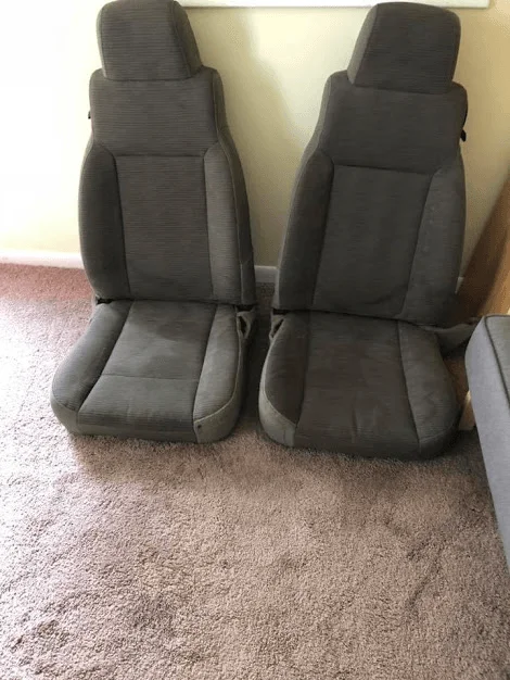

Here are the seat covers, waiting for their washing machine ride. Figure I'll throw them in on the delicate cycle with a scoop of Borax Laundery booster. If it can keep my Hockey gear clean and not smelling of death, it should be able to handle a couple dirty seat covers.
Dark Slate Gray
Khaki

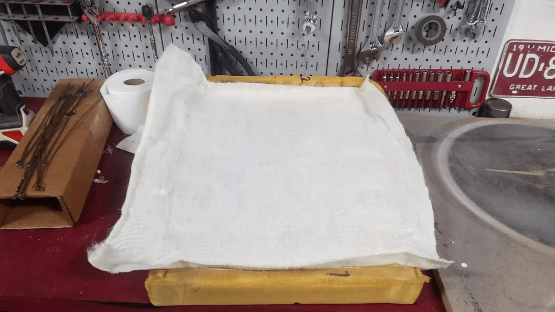

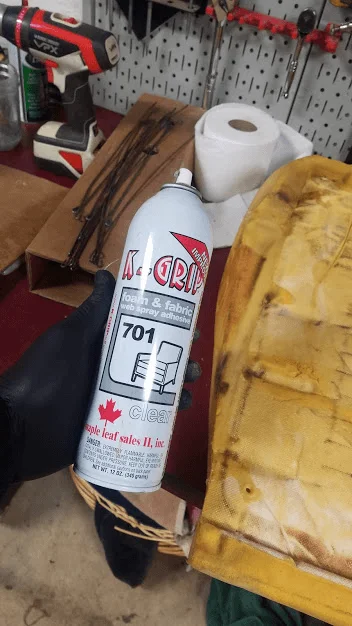

Today I repaired my foam seat lowers. I stopped at an upholstery and mattress shop on my way home from work and talked to the guy there. Ironically, he's a jeeple too. Anyway, we talked about what was going on, and he sold me some of the facing material they put on box springs. Very tough stuff. Gave me a couple yards for 2 bucks. Of course, the adhesive was pricey at 15 bucks a can. I got all of the foam repaired. I also got all of the reinforcing material applied.
Here is the adhesive I used...Oh, Canada...
This is your friendly public service announcement. Get into your seat cushions and put some reinforcing fabric on the bottom. Even the newer seats were starting to tear at the same spot.

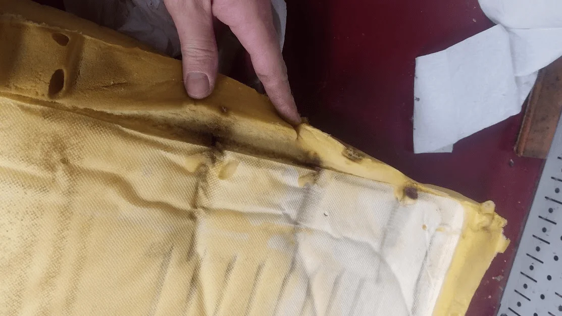

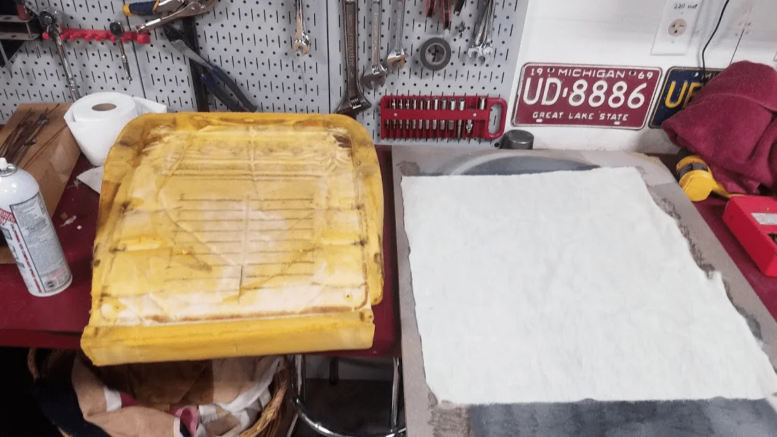

Here is the worst of the worst...as a reminder, this is what was causing me discomfort while sitting in my seat. The steel frame will ride up into that crack and the whole seat sit crooked. That white fabric is there to protect the foam from the center springs (which support the weight of the person sitting in the seat). They cut is short, and the foam tears along the edge of the fabric. Design Flaw, IMHO.

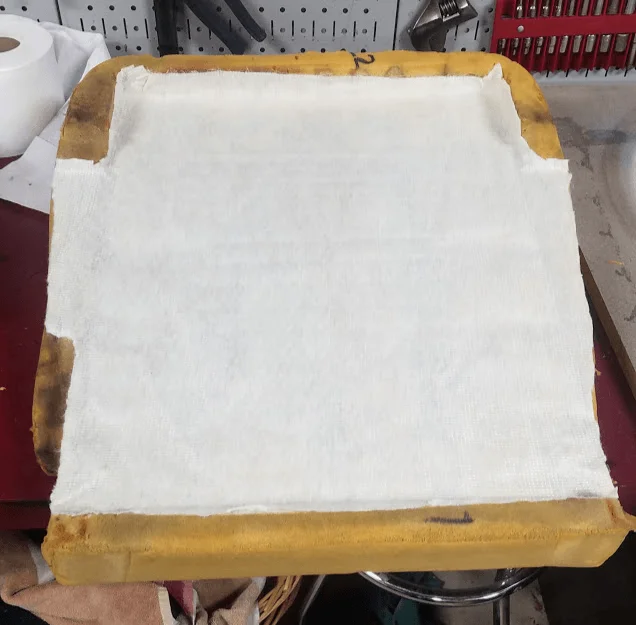

So, first I sprayed adhesive into the tears and stuck the foam back together. Then I cut the new material for the seat bottoms roughly to size. You want to be sure and orient the fabric correctly. The stuff I have would expand in one direction, but not the other. I put the non-stretchy direction across the seat, so it would resist the frame more. Once the fabric is cut, spray both sides with adhesive.
Now you wait a couple minutes for the adhesive to flash off. Once it gets tacky (not wet and slippery) you place the fabric over the foam and press is down. You have a couple minutes to reposition...but only a couple. Its not as fast as contact cement, but you gotta work quick. This has been applied and it ready to trim. Pay special attention to the edges...You need to get it REALLY stuck down here, or all this work it for nothing.
Finally, here is the finished seat base, all trimmed up.
