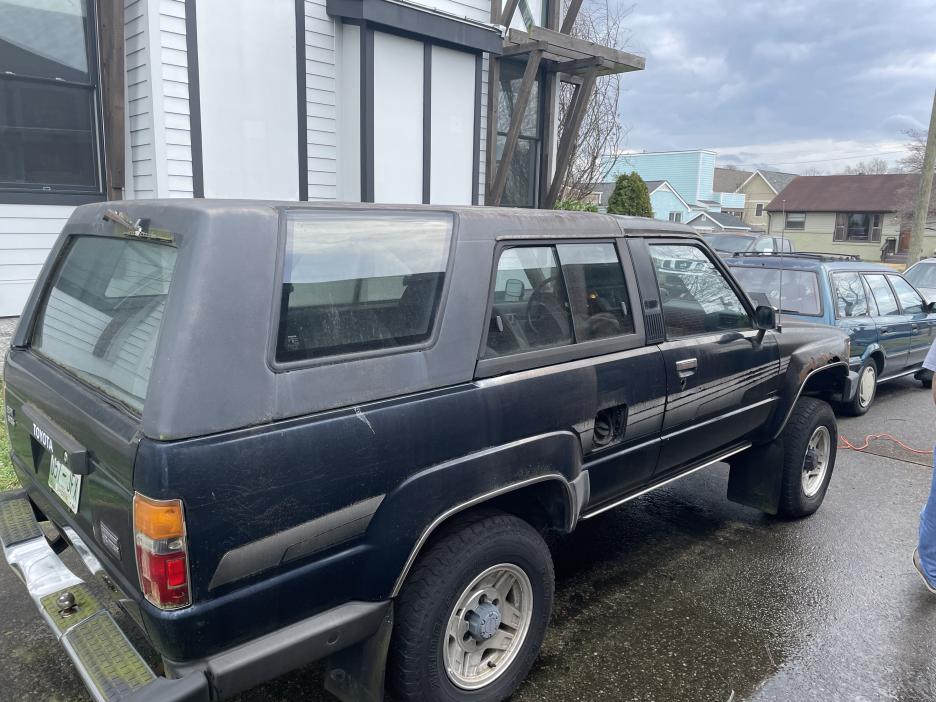

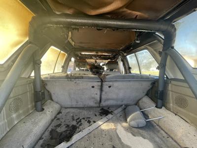

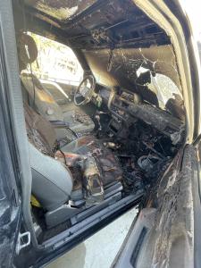

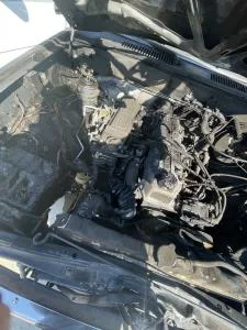

injectors. the fuel pump kicked ass one i replaced it with a delphi brand.Jesus man, that’s horrible. Not many of them left, sucks to see it totaled like that. Fuel pump burn up or??
should have forked up the extra $200 for denso injectors.
they leaked. so i shouldered it until the following day, got the leak fixed, cycled key for a few minutes 5 or 6 times to let the fuel pump run for a bit to make sure it wasnt leaking. idk if it was residual fuel or of one of the injectors popped when it fired up.

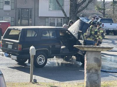

happened so fast, all i could do is scream fuck repeatedly as i slammed the hood & jumped in car to turn it off and roll it into the street, then try and put the fire out.
