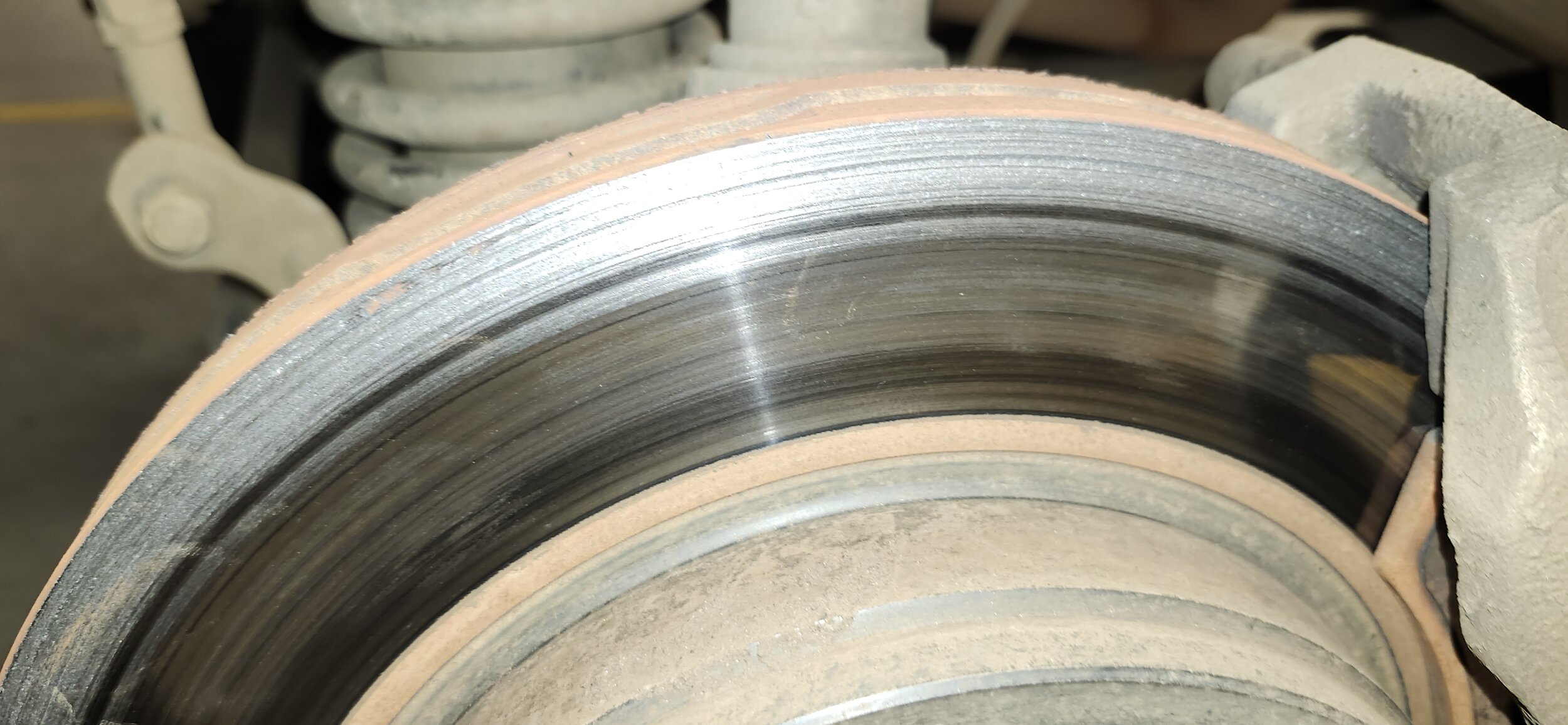

Got back, finished, aired up and when driving out the 10km of forest roads back to the highway, I noticed the power was terrible. It was bogged bad. Then one of my mates behind radioed he smelled something burning and saw smoke. We pulled over. I immediately went smelling and the front calipers were cooking. Up till now the brakes felt normal pressure wise. I turned it off and then the brake pedal was rock hard to push. Put it in neutral (5 spd manual) and the t-case in neutral and couldn't push it on flat ground (parking off as well, not that is is worth a damn anyway). Couldn't figure out why they were locked up, so I called CAA (like AAA but here in Canada).
While I was on the phone to CAA, I let my buddy who I trust investigate. He pulled the master cylinder from the brake booster and heard the pressure let off. They backed the brake booster push rod back some and put it back to use. It drove normally after. The brakes were not locked up, but the brake pedal a bit softer, meaning I had to push it in more. That makes sense since we experimented with the push rod adjustment, but it seemed more to due with letting out the pressure.
But why would this all the sudden be? Why was I getting too much pressure? It is like the vacuum was far too strong in the booster. The master cylinder seemed to function fine, but I have no frame of reference.
