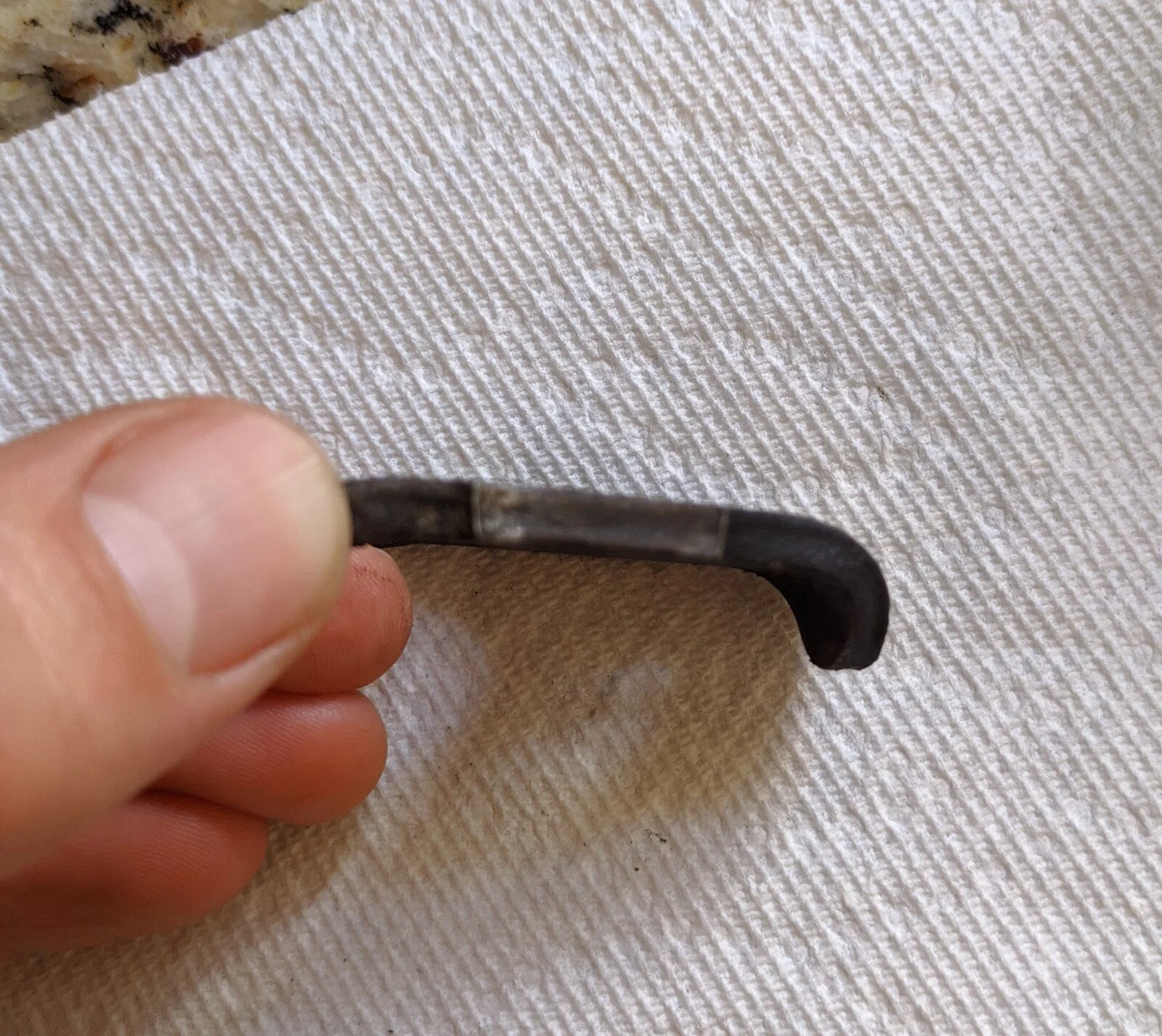

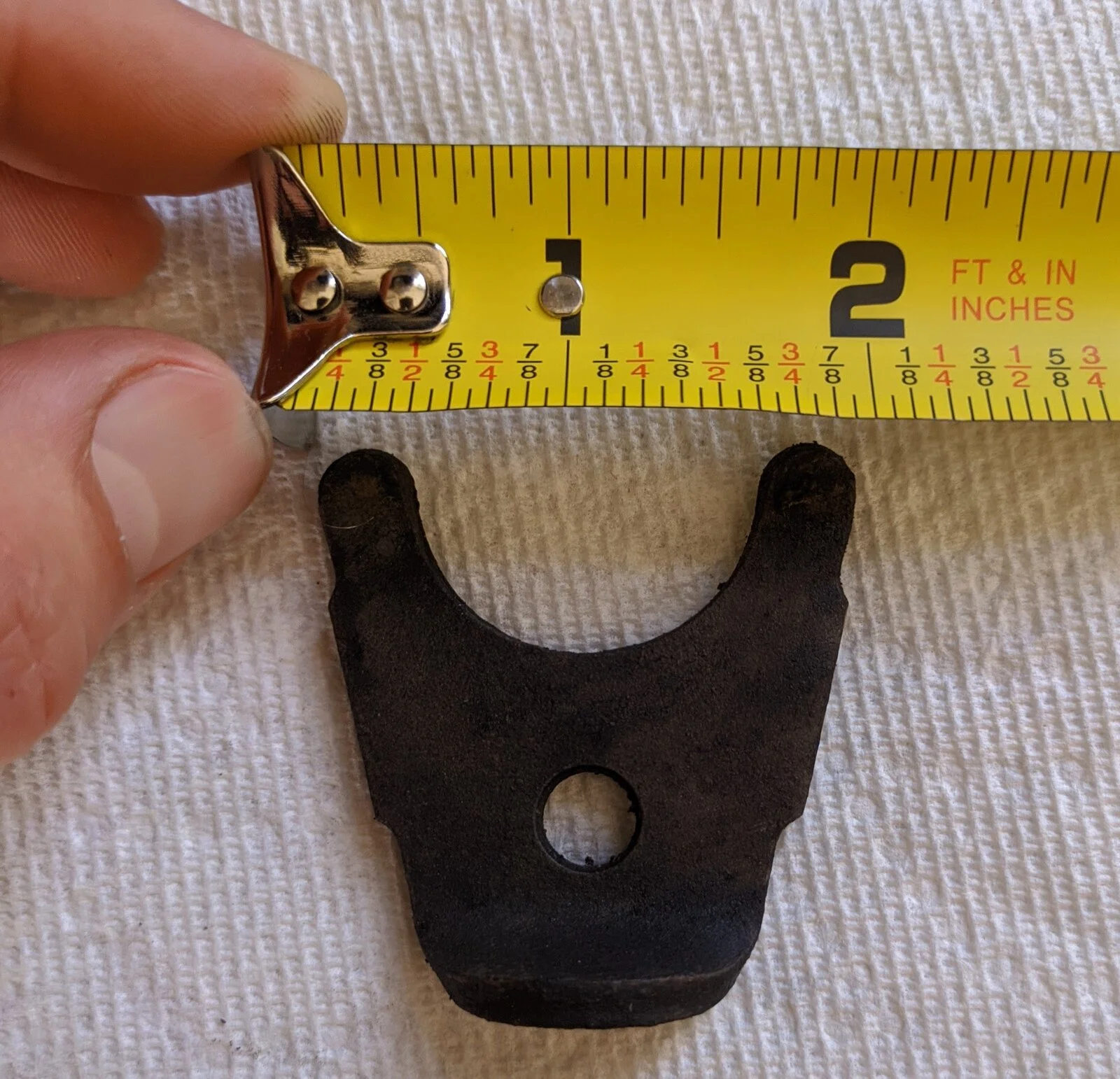

I was torqueing the bolts to my motor mounts and found this bracket/part between the motor and the mount bracket. Passenger side.
Any ideas what it is?

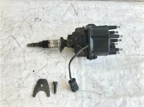

Looks like a distributor lockdown plate. It keeps the distributor from turning, which changes the timing.
After a quick Googling you are correct!
Thank you very much for the quick reply.
Now to find a bolt to put it back on.. and hope that I haven't messed up the timing
