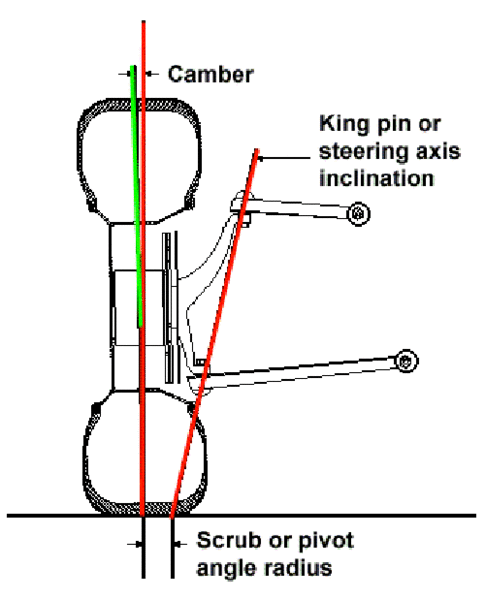

The garage floor squeal you're hearing is caused by the wheel spacers which substantially increased the "scrub radius" of the wheel and thus the tire. That means the tire is no longer centered around where the knuckle pivots around the ball joints. Aka steering axis inclination. Instead of the tire pivoting about the knuckle's pivot point when you turn left or right, the tire is instead swung in an arc located 1.25" further out from where the natural pivot point is.
The bigger the spacer, the more it increases the scrub radius.
A decent thread on scrub radius is at http://www.locostusa.com/forums/viewtopic.php?f=5&t=15370
The distance between where the two red lines touch the ground below is the scrub radius.
The bouncing you're feeling could be the tire rubbing on the fenderwell from it being positioned further out via the spacers. Or an axleshaft u-joint may have decided to go bad coincidentally at the same time the spacers were installed.
