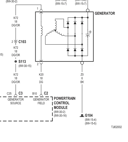

I recently removed and onboard welder that I had on my TJ as the alternator failed and it was expensive to fix. When going back to the stock two wire 5.2 L magnum alternator there is no plug on the harness as it was hooked through the welder. What I need help with is figuring out the wire colors for the two wire plug so I can try to track them down on the harness. I believe they were left unplugged or bypassed fully when they did the 5.2 magnum swap at the same time they installed the onboard welder. It’s a 2000 TJ with a 5.2 swap. Any help would be very much appreciated!!!

If your TJ wiring is still in place here are the colors of the wires.
