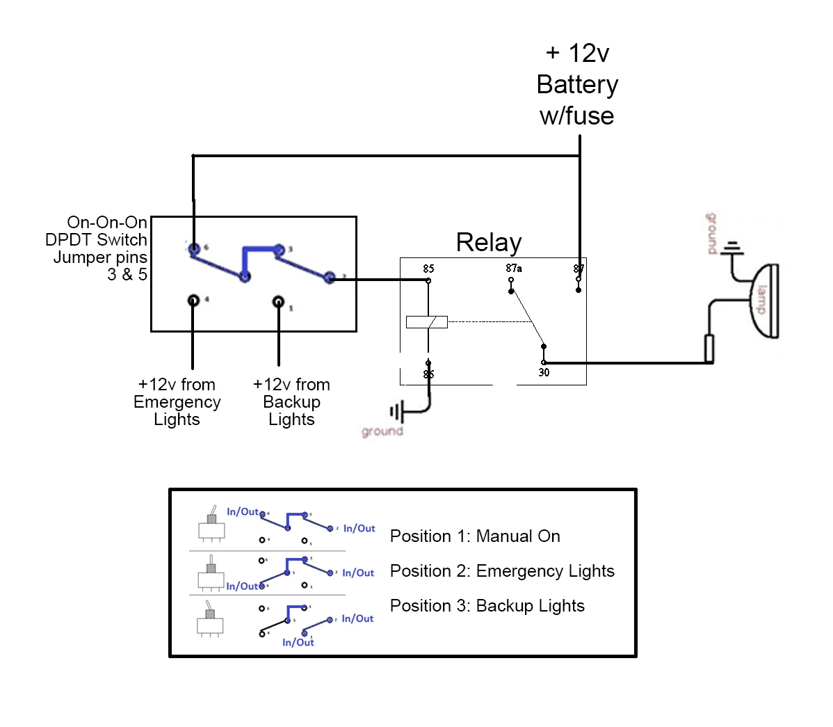

I think this should work for you. Make sure the DPDT (double pole, double throw) switch is an "on-on-on", not an "on-off-on" switch. Google it and you should be able to find one fairly easily. You will need to jumper terminals 3 and 5. The relay is a standard Bosch or similar relay that you can get at any auto parts store.
Basically, you are using a relay to channel power from the battery directly to the light. The relay is grounded and only needs a positive 12v to trigger it. That positive 12v is supplied by the switch. The input to the switch is positive 12v from the battery (or switched ignition if you want it to turn on and off with the key), the backup lights, and the emergency flasher. The illustration in the box below the wiring diagram shows the electrical connections for all three switch positions. I diagrammed it with the emergency flasher in the center position (your "off" position), but by connecting to different terminals you can make it any switch position you want. Let me know if you need more info.

Wow, thanks!
I'll have to stare at the schematic for awhile to be sure I understand it.

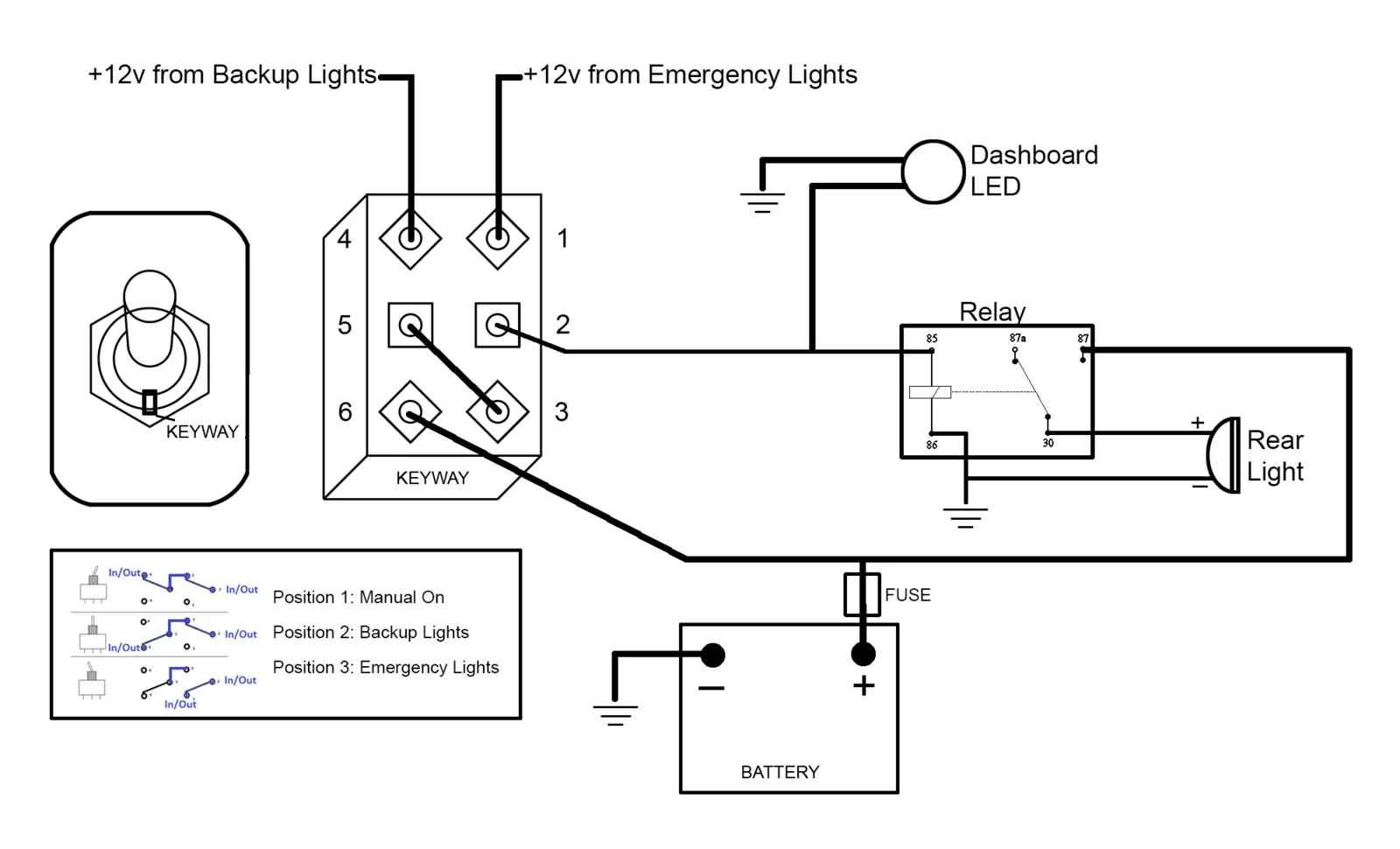

Nice find on the switch, looks perfect.
Here's an updated diagram, I used the drawing of the switch bottom from the manufacturer's website, so it should exactly match what you get.
Adding the dash light is easy-peasy. Just run the positive to the same wire that triggers the relay (#2 on the switch). Whenever the rear light is on, the dash light will be on also.
I placed items on the diagram to make it easy to indicate wiring connections. I would suggest putting the switch and LED in the cabin where convenient and the relay near the battery. The +12v going to #6 on the switch does not need to come from the battery. Since it will only be handling a small amount of current to trip the relay, you can pull it from any convenient source in the cabin. This is the power for the manual activation. If you are using switched power (on/off by the key), and you forget to turn the light off, it will automatically go off when you turn off the key - but you will have to have the key on to manually turn on the light. If you use unswitched power you can turn the light on without the key, but if you forget and leave it on, it could run down the battery (eventually). Pick whichever seems most useful to you.

I am impressed. And thankful.
The schematic makes sense to me, which is a feat. I shall now start gathering the parts.
The jumper is still between terminals 3 and 5, correct?

Yes, just take a short piece of wire, crimp a female spade on each end, and connect terminals 3 and 5.
