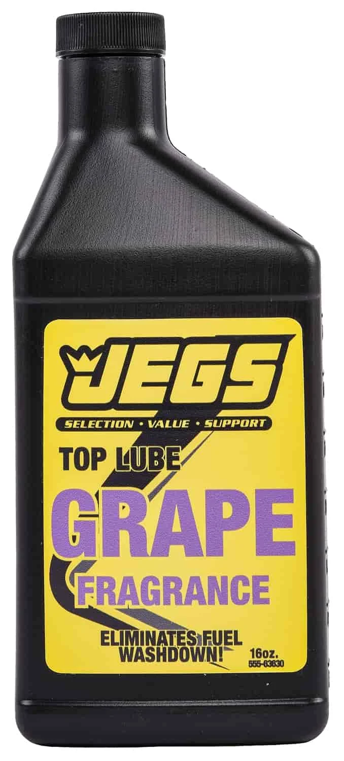

Put a cat back on and live with the fact your exhaust pipe is only a couple feet behind you.could also put some junk like this in your tank 🤣
Long term consequences on your sensors or getting pulled over might not be good though...
