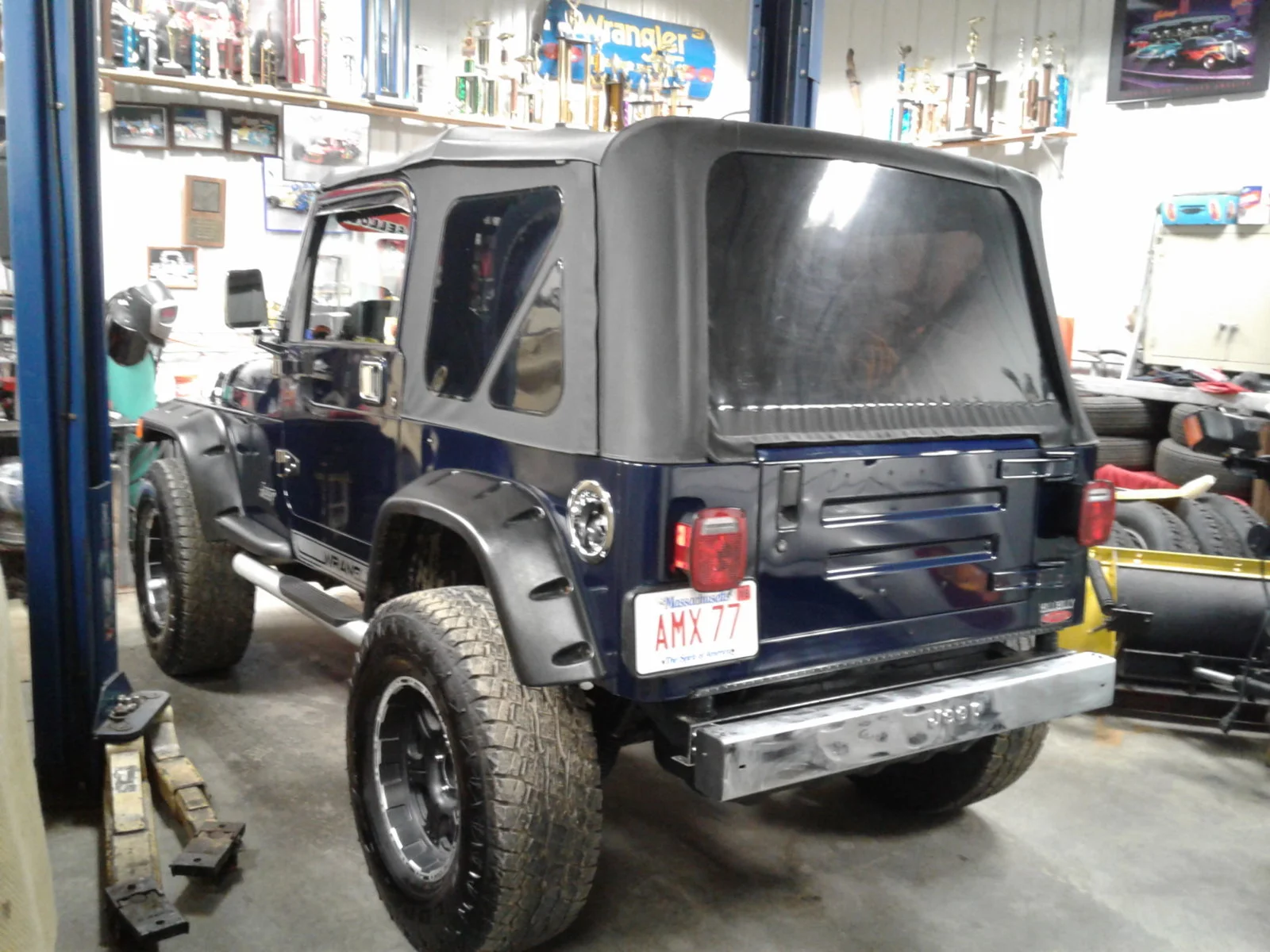

just put a set of 315-70-17" on my 97 tj, tires measure 34.5" rides good , i live in west mass. a lot of mountains. have 2.5l , 5 speed trans, a little power loss but having a manual tranny helps. if it was a automatic, i wouldn't go much bigger than 32" tire . it has a 4" lift and 1.25 body lift
Reactions: Jeep9748
