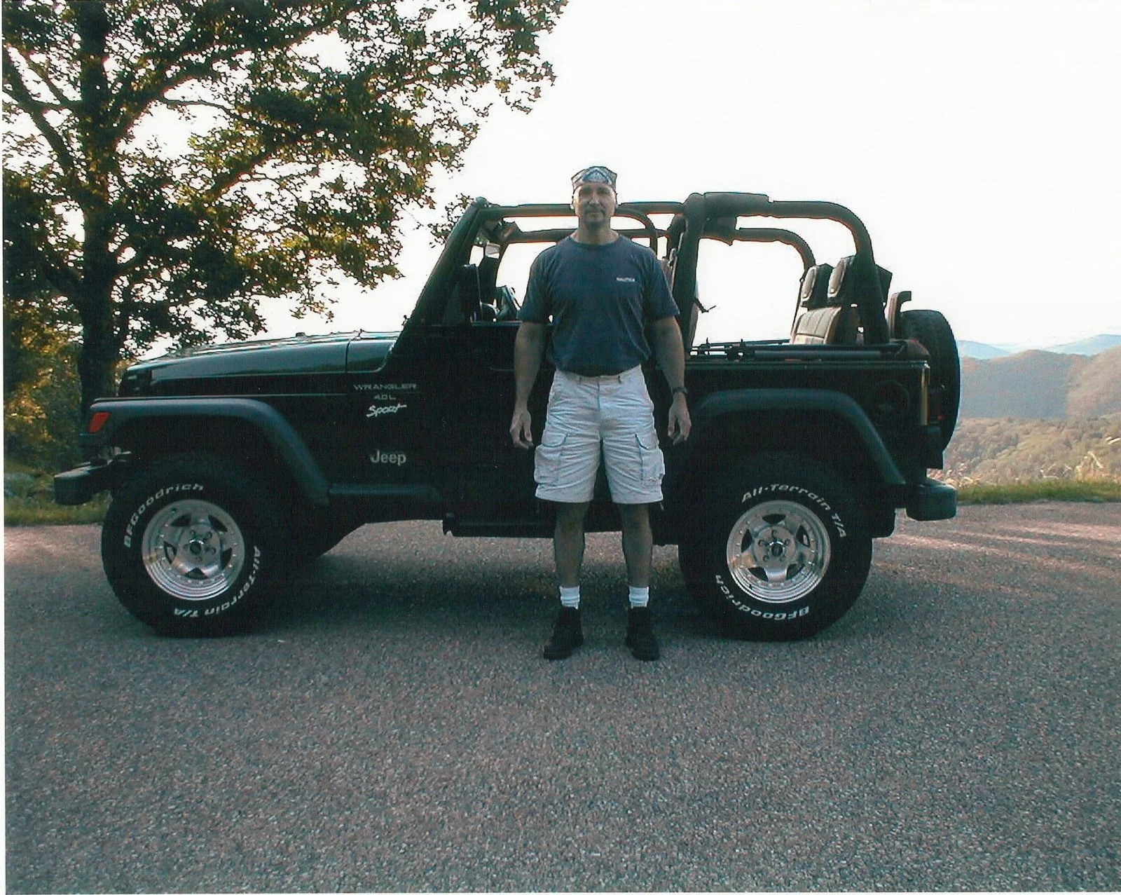

Thanks in advance for the input and help. Glad this site is around; will no doubt be needing more help and or advice. Found a pic of my old 1998 Sport with the tires/rims on it that I plan to do again with the 2000 Sahara Scan 2.webp

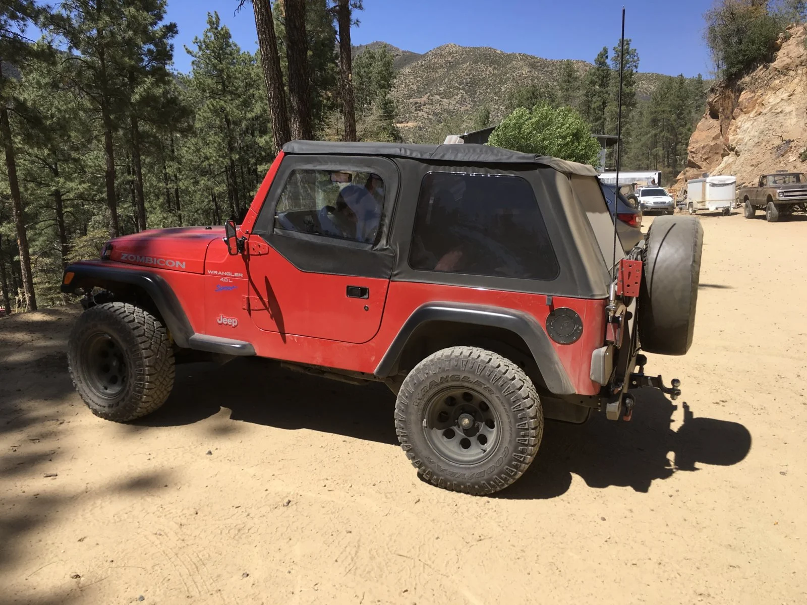

Don't know what to tell you other than the 8s are really popular. Here is what I have. 2 inch OME w 31x10.5x15 on 8s with 3.75 Backspace.
