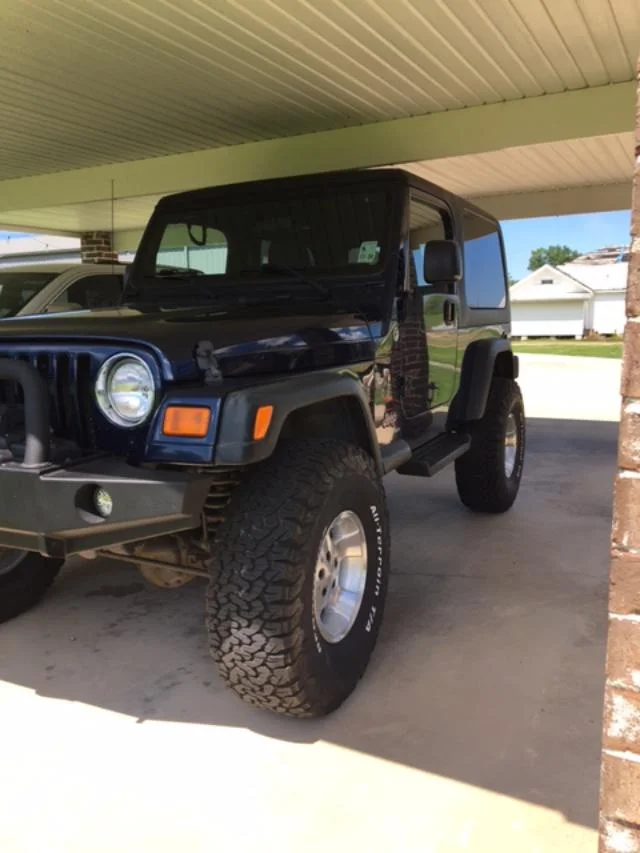

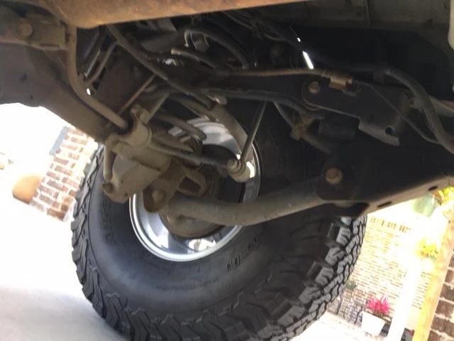

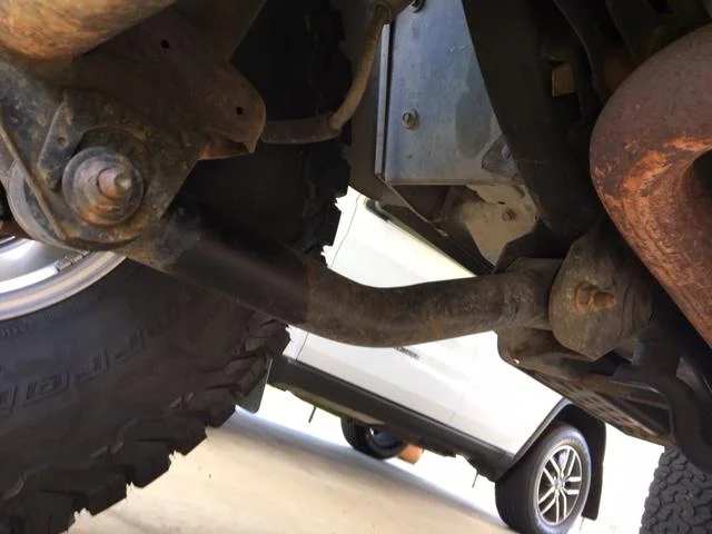

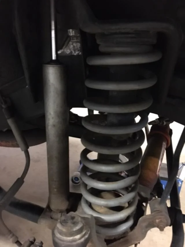

Anyway, the 30ish young lady that owned it didn't know much. Rubber duck thing. She bought it in Alabama so it's been a Southern Jeep and doesn't appear to ever have been wheeled. Here's a few pics. I want to change all the control arm bushings but these lowers don't look factory. Anyone want to guess the height or brand of the lift. Shocks and springs are painted silver.

Not sure anyone needs to guess at the lift height....but I'd guess 3.5" maybe, but you can measure really easily and know.
Measure the spring perch on axle to the frame perch. Stock is 12", anything above is lift. Rear stock distance is 8" and anything above is lift.
