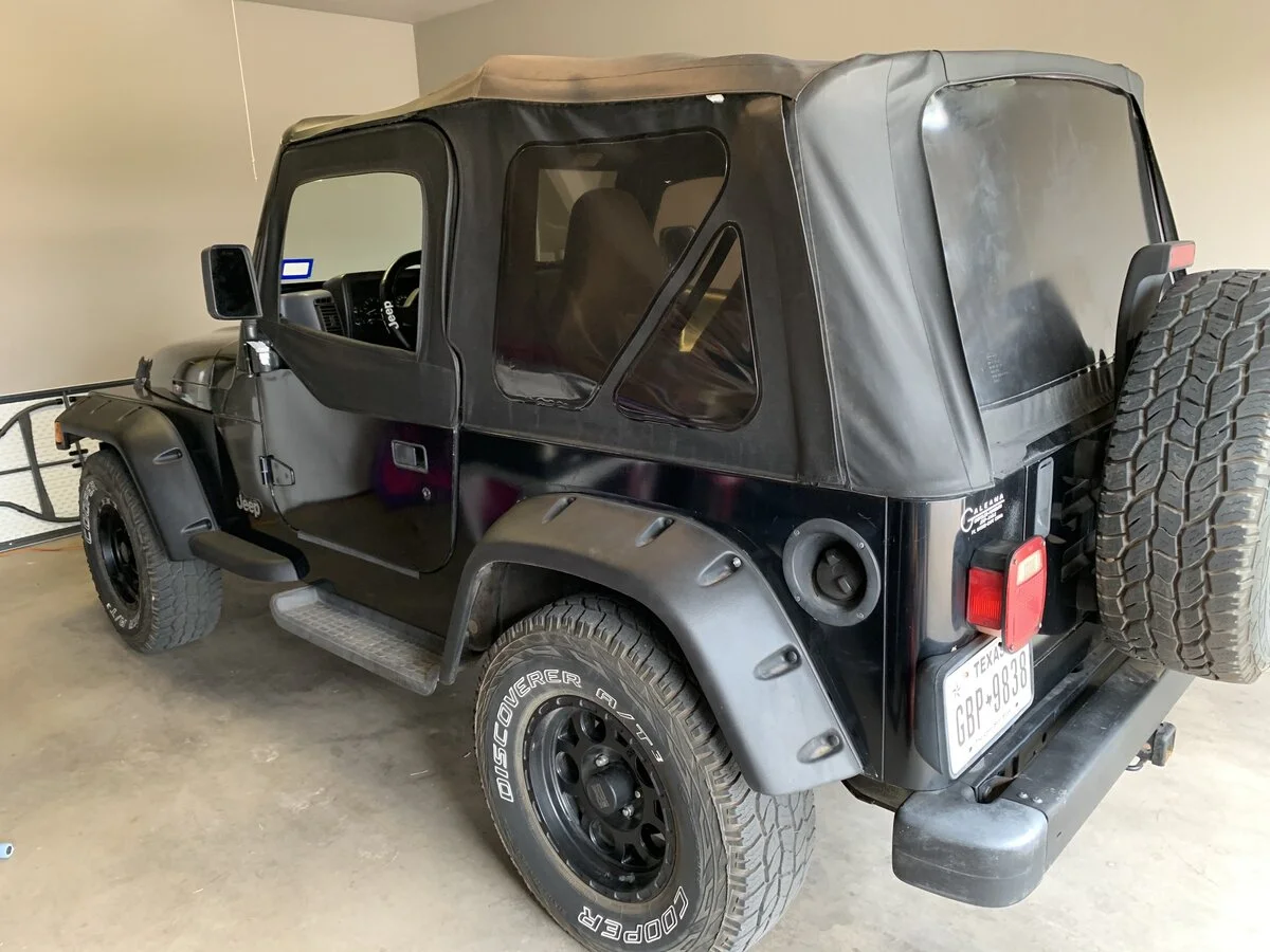

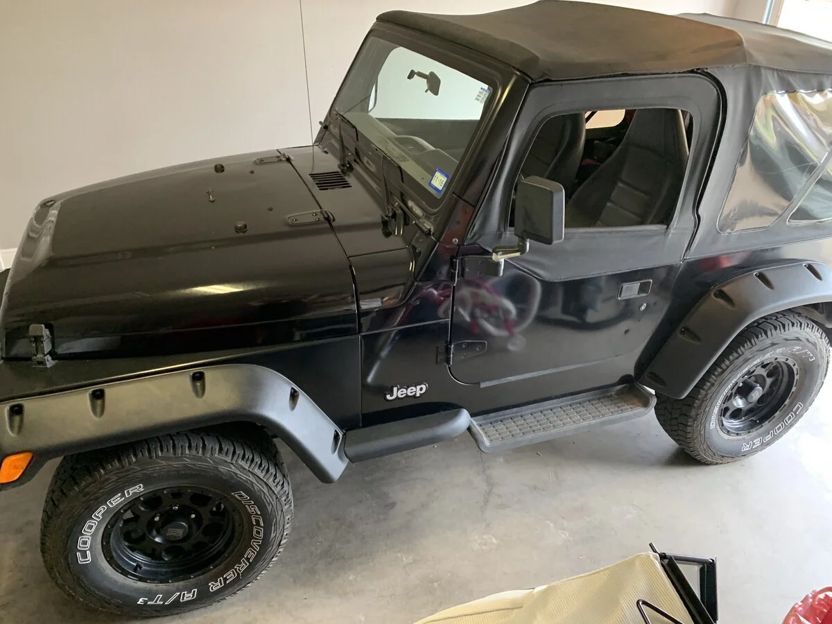

Looks like a nice clean jeep. A/C issues can be a PITA. You may want to just take it to an A/C shop and have them do a dye test. (or buy the dye and a uv light and DIY)
Looks like a great looking TJ.
