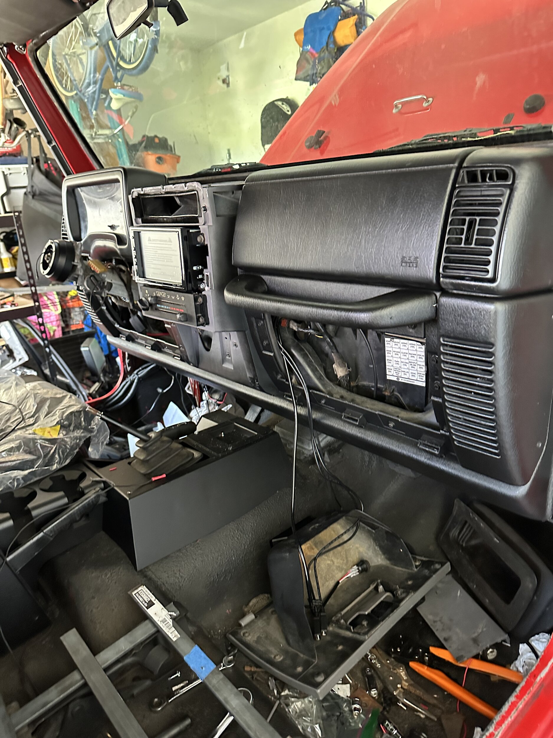

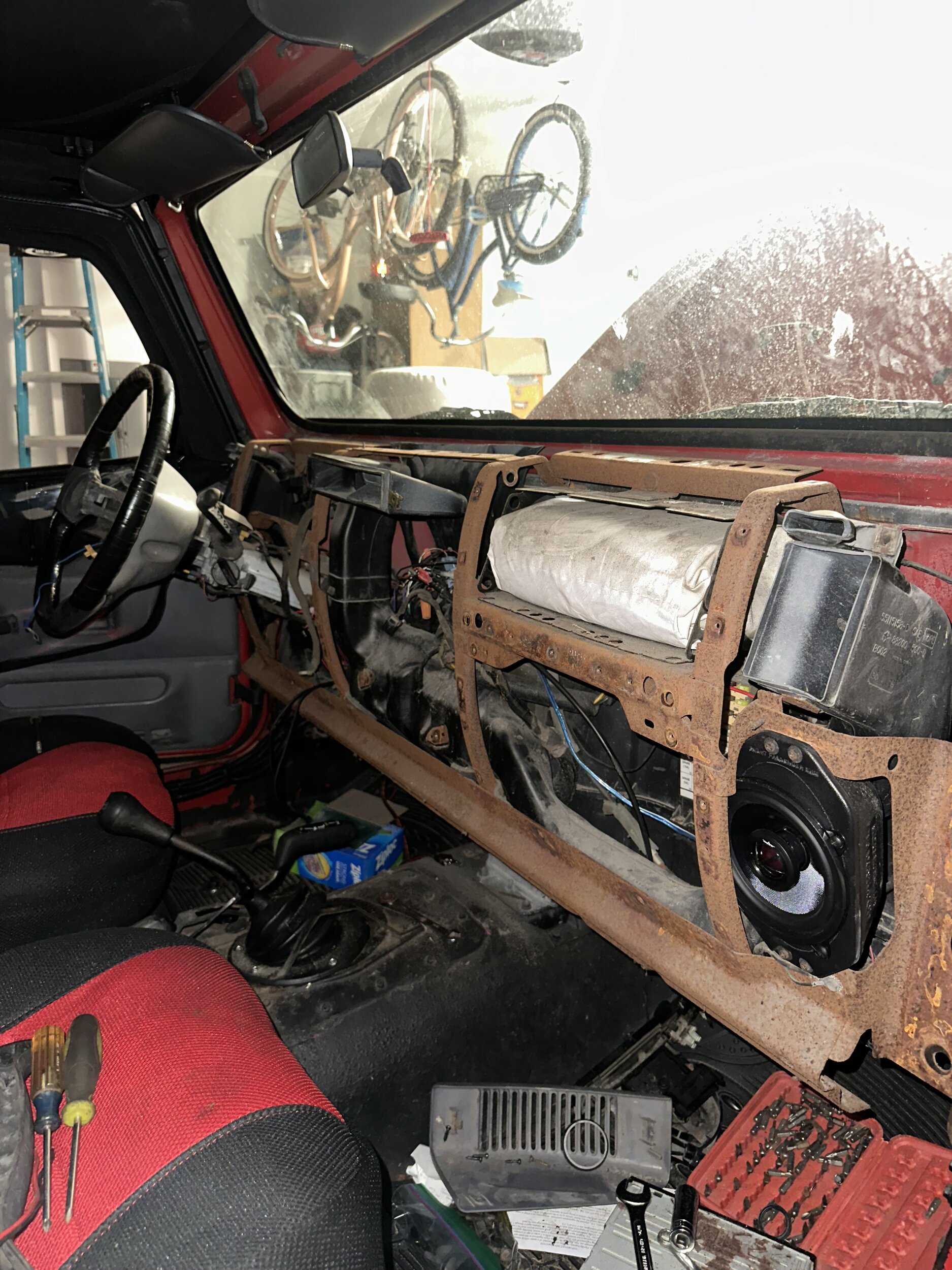

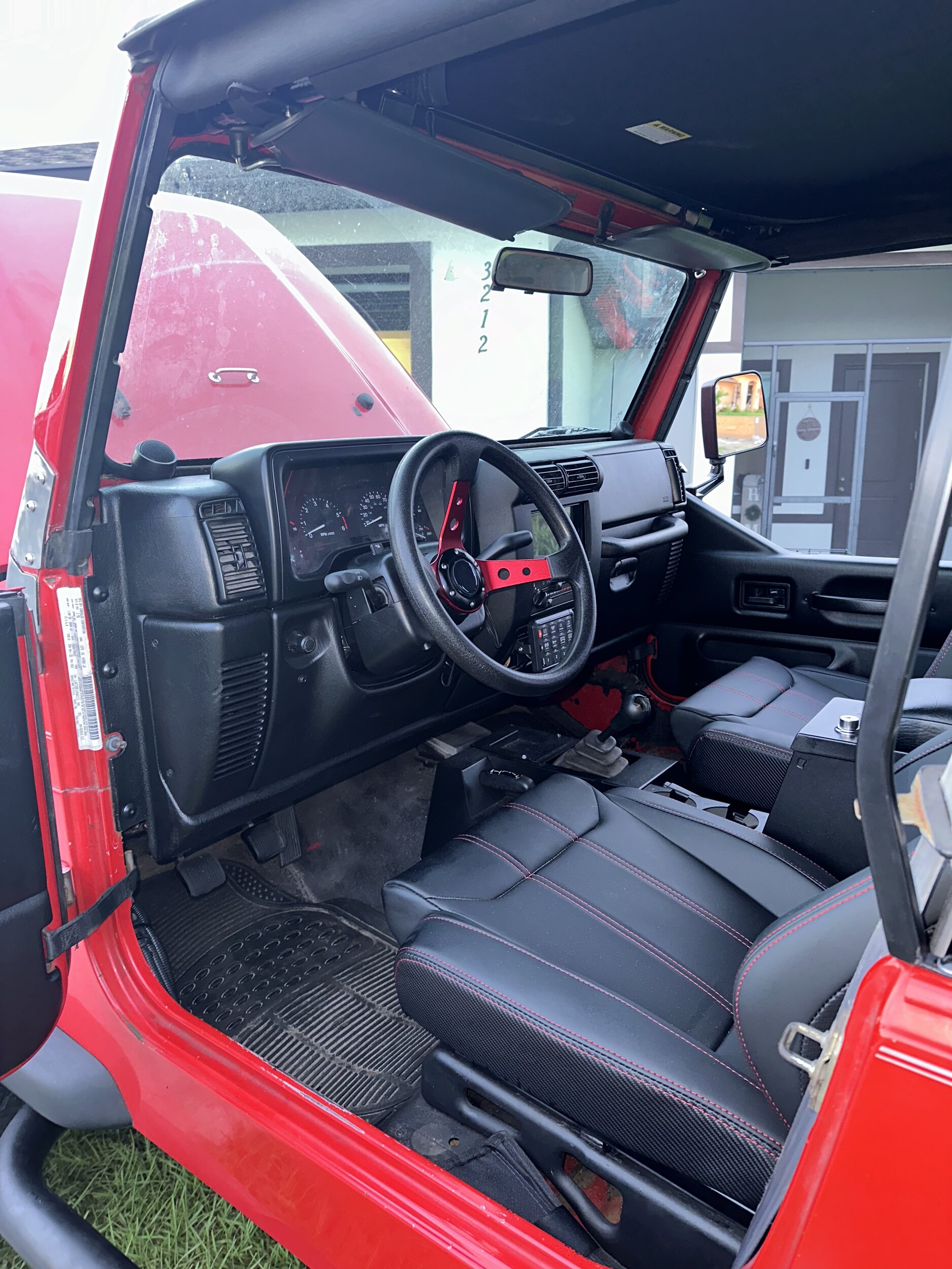

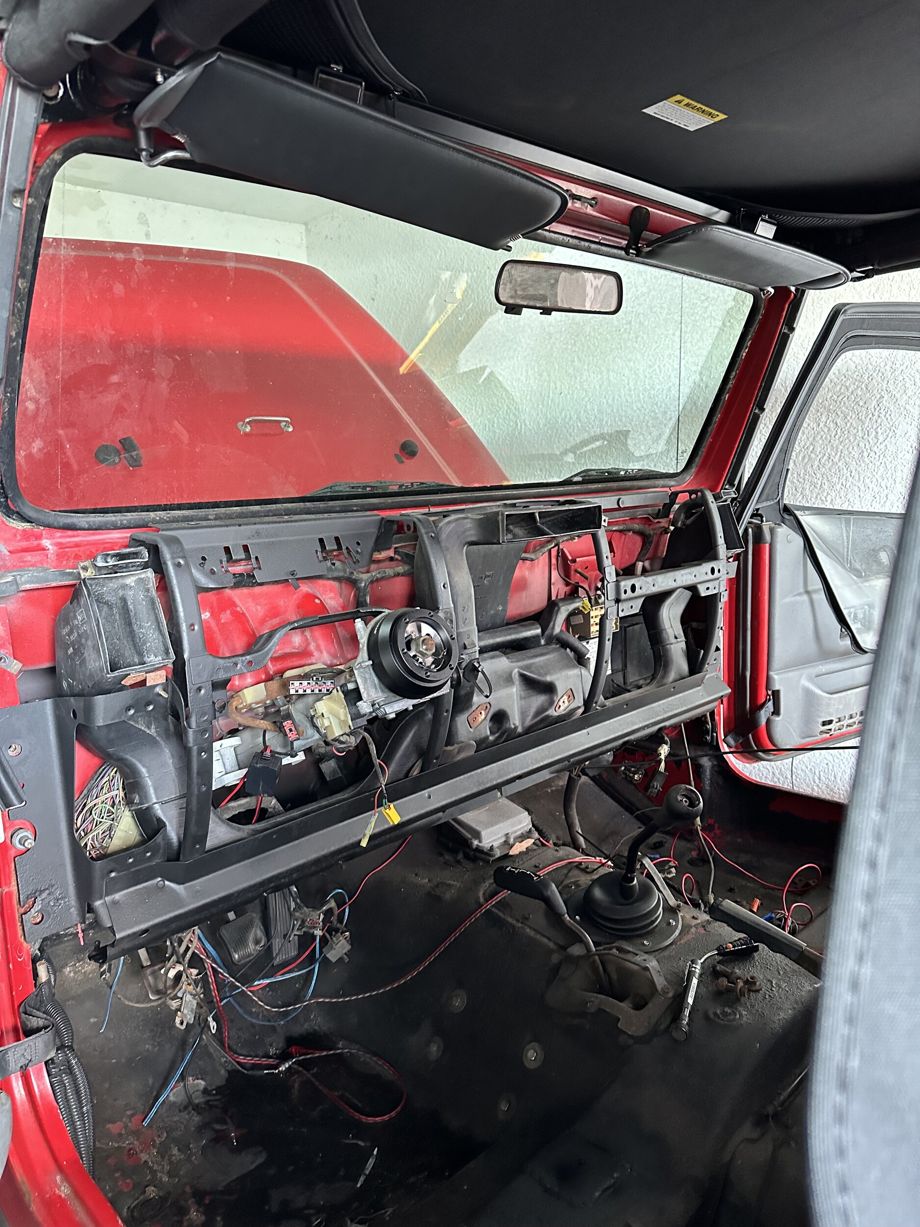

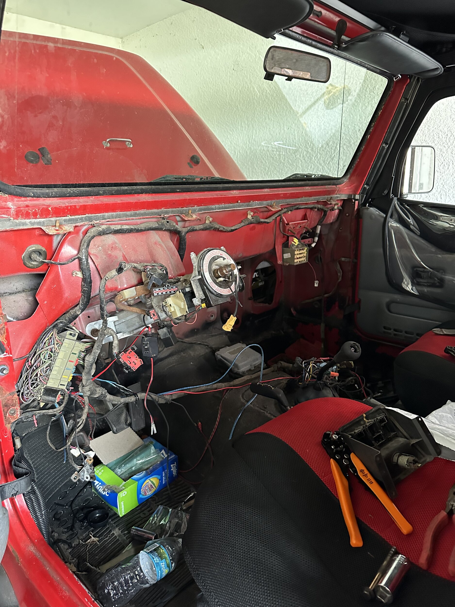

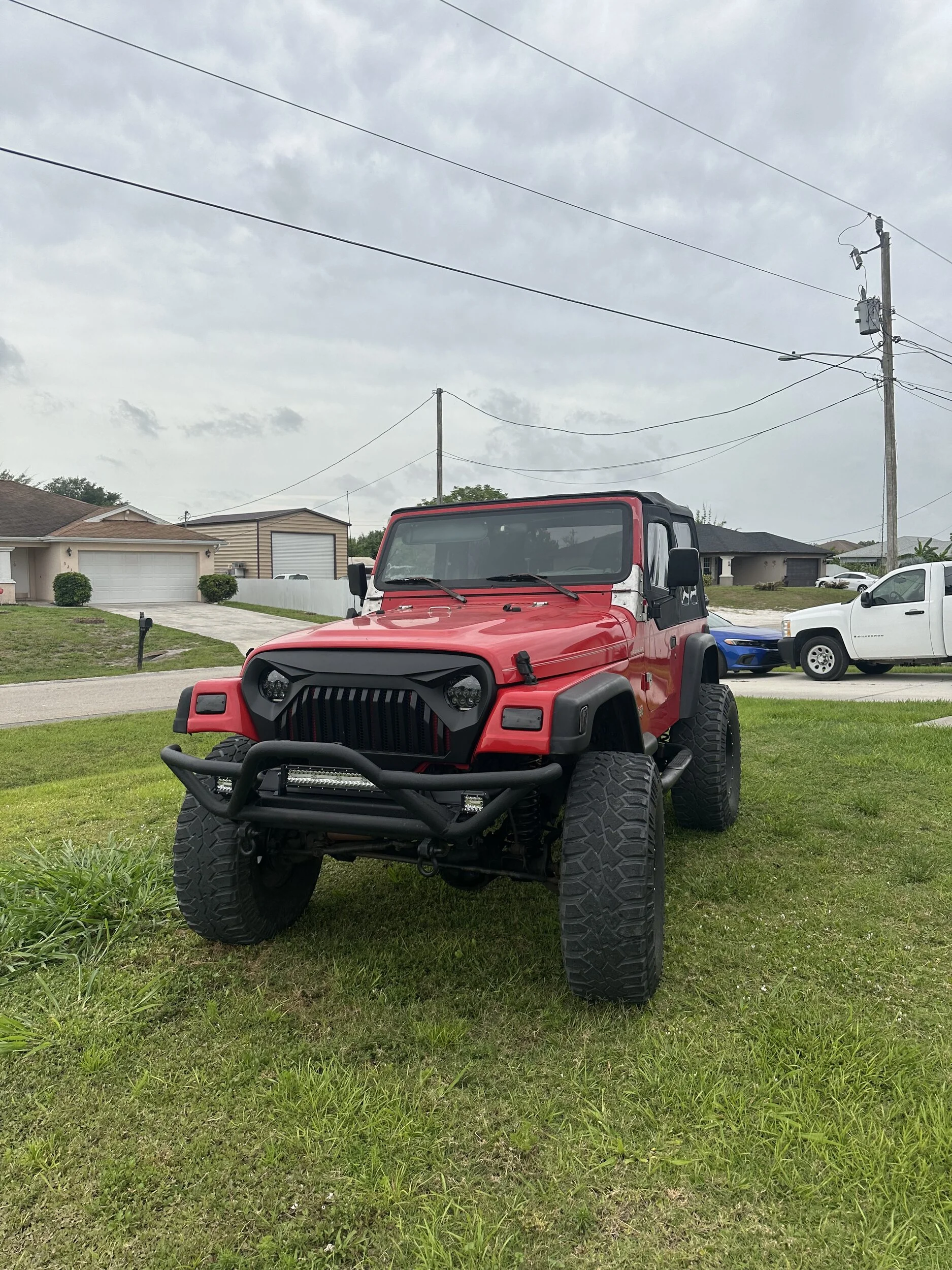

Okay here is the update on the 4 banger I bought. Tub and frame is spotless. I’m highly mechanically inclined and this is my every night hobby building this jeep. (Started with the interior first because my wife said it was a pos.) only thing left is new harness and bars for the front. 2 kiddos are rigged with custom car seat brackets.
It’s a 4 cylinder that the previous owner just replaced about 3500 miles ago brand new and new transmission. (Paper work.)
I’m going to run the powertrain until I blow it apart or it just stops going.

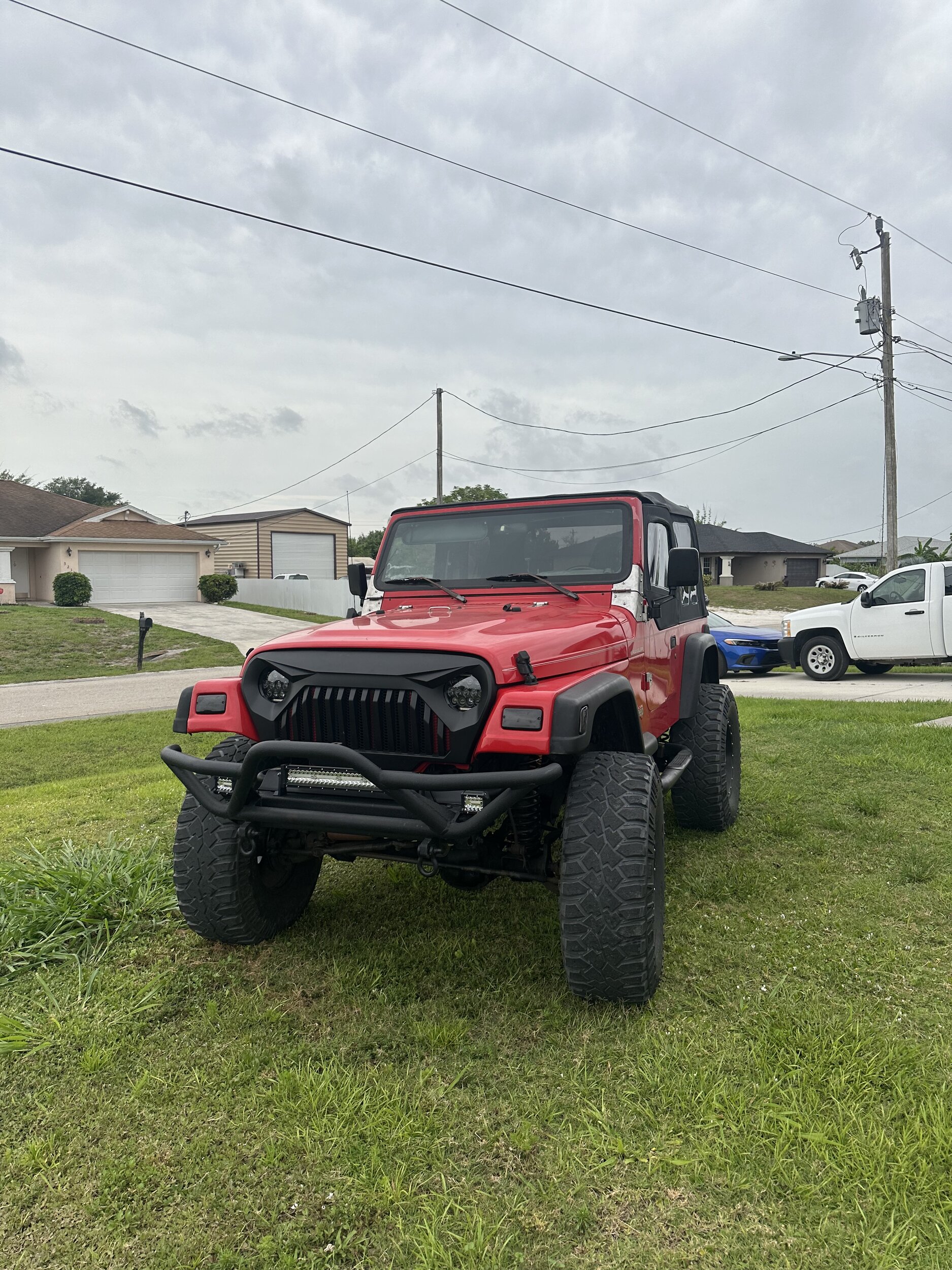

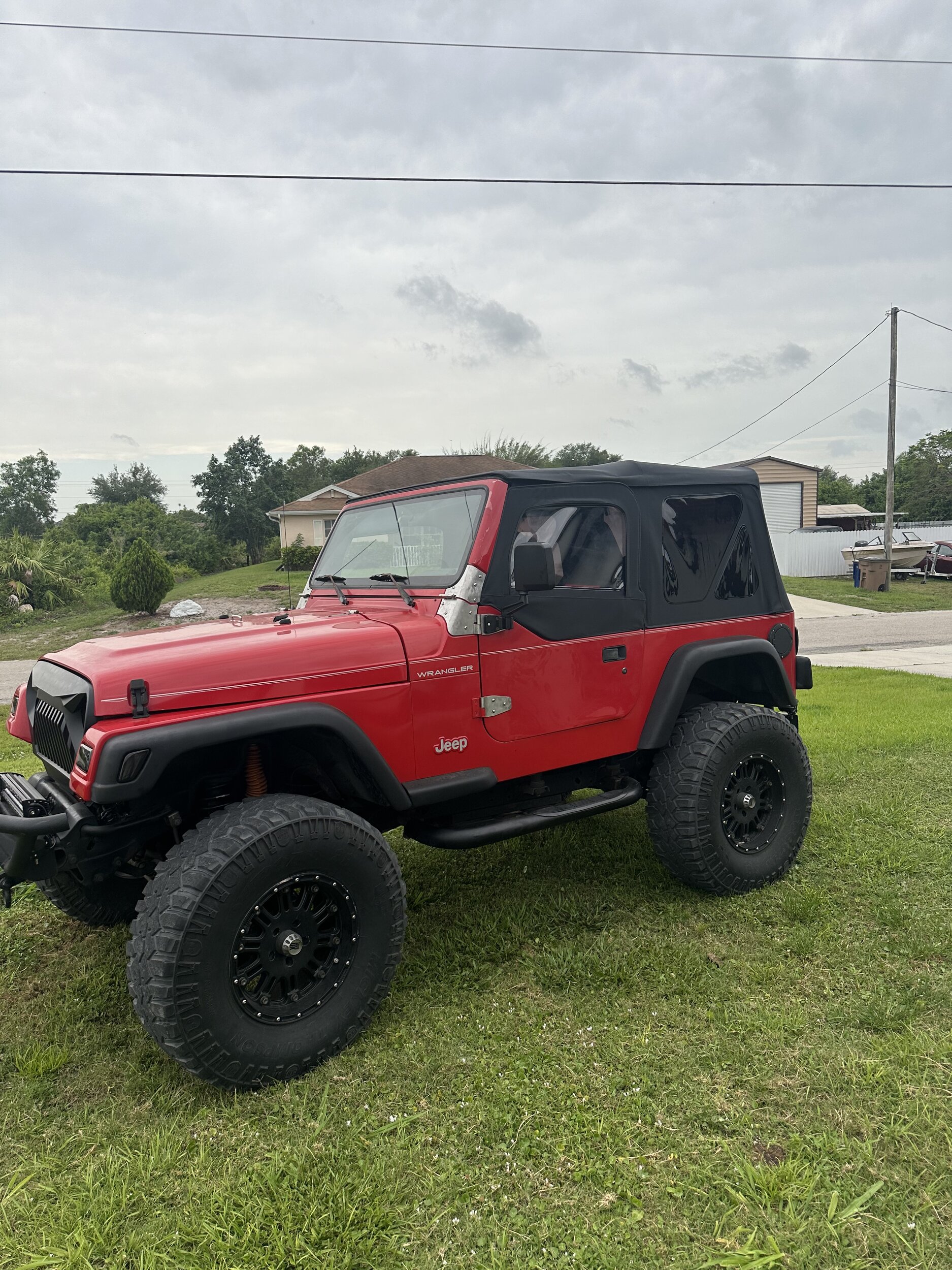

Current lift 4” sky jacker and 3” body lift.
Serviced the rear to find a super 35 kit with a Detroit locker. Front is the standard 30. I replaced all universals, ball joints, and tie rods, wheel bearing etc. Running a 37” tire which I’m not set on more the body lift.
What would your upgrades be to do it right?

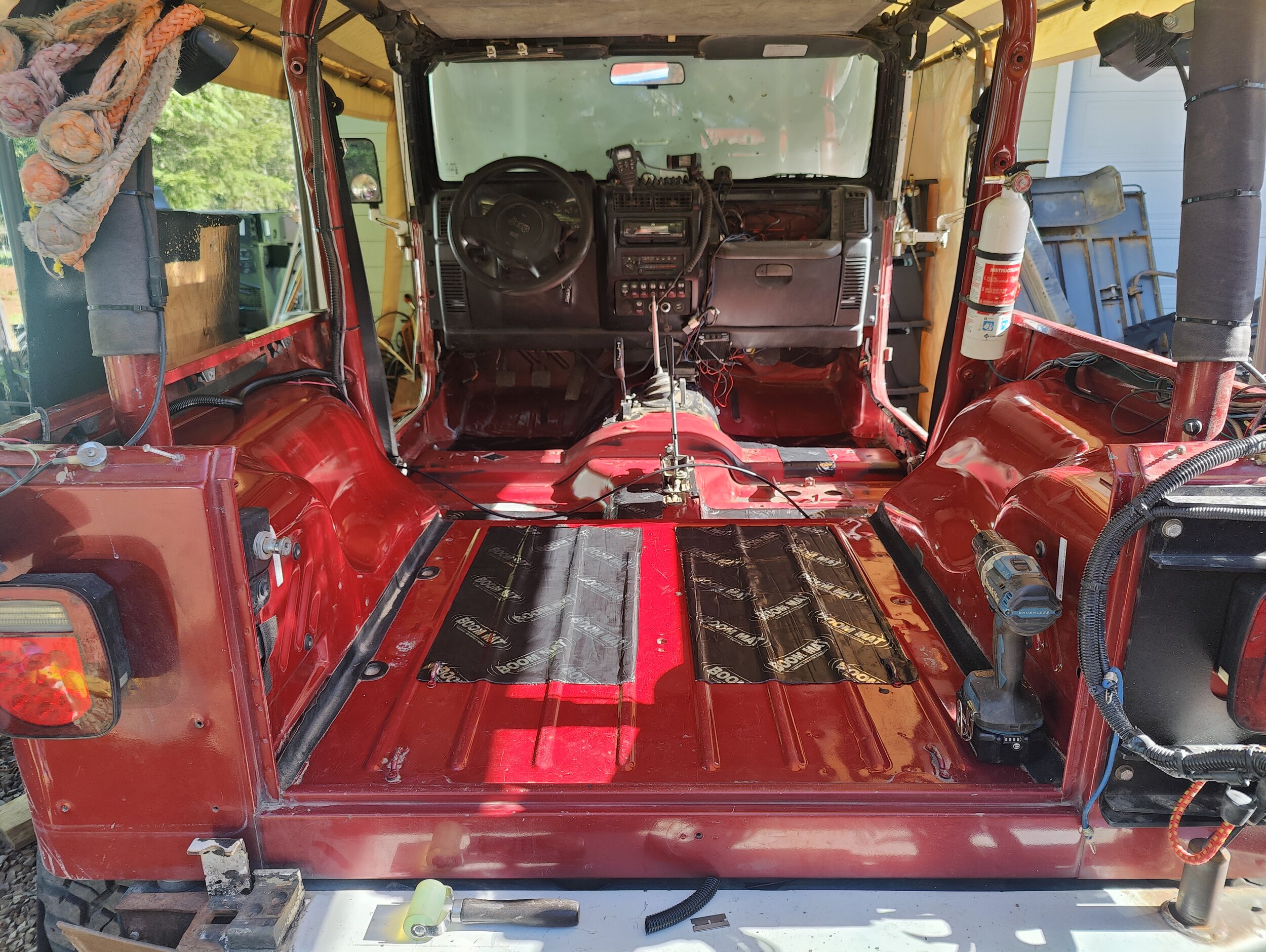

Unfortunately no, I plan on doing a carpet kit with mass backing and people said that was enough….however I feel they don’t know a chicken from a squirrel so I’ll probably try it then end up removing it and adding some in your similar locations you pictured.
Did you do just under rear wheels and front foot pans or the entire tub

I'd lose the 3" body lift and replace it with a 1". I'd also lose the 37s and replace with 33s since you have a 4 cylinder. You'll get a ton of usable power, braking and general drivability back by doing that. What gear ratio do you have? As to the Super35, I have an E-locker in mine and love it. It's a completely smooth, open dif until I tell it to lock. No jumping or bucking when turning unlocked.

You need to decide what you want to accomplish with this build, what do you want to do with it, before firing a parts cannon at it and hoping things workout. A street driven Jeep on 33s with stock power will be very different from one with a 500hp LS swap on 40s built for the rocks, which would be different from one built for mud.

Essentially I want it to be strictly off road it’s a weekend toy.

Essentially I want it to be strictly off road with some on road use. Build time is probably about a year and want to do it in phases so I can still enjoy it for maybe 2 weeks out of the build time LOL. Would like to stick with 35s or 37s I plan on removing BL since I want to be lower. Center of gravity is awful in this thing

I’d lose the 3” body lift for now and swap in a 1.25”.
I like Hemi’s and LS’s.
Atlas Tcase
Bigger axles for 37”+ tires

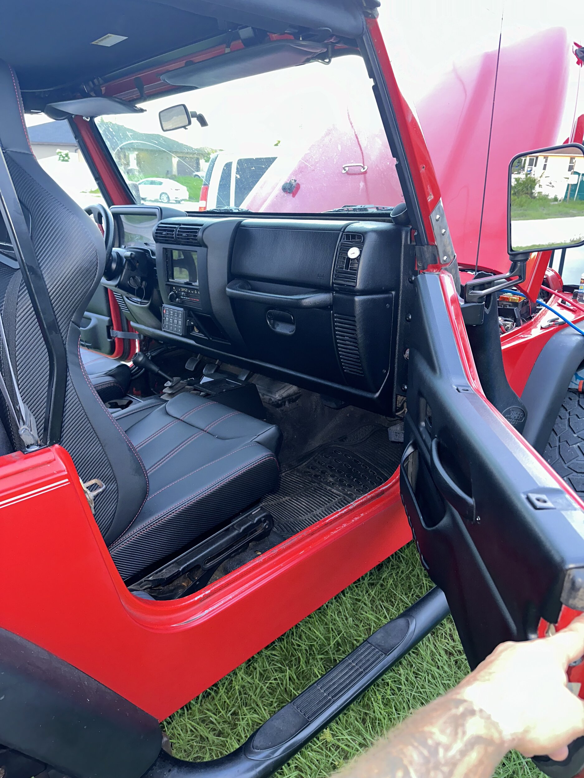

That interior looks fantastic. What seats are those?
