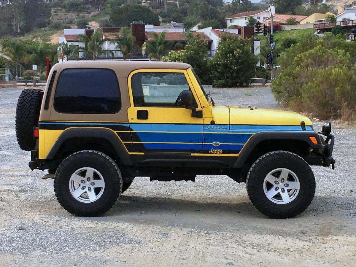

I didn't think about it before, but the flat spot in the top of the fender had me wondering. Anyway, it definitely gives it that retro look. That's pretty cool, man!
I can't for sure, but it looks like you lined it up with the trim line on the hood that swoops up to the windshield hinge?
If I did, it wasn't intentional.😆 I was mainly going for a little yellow being shown between the bottom of the hard top and the top of the decal. If I'm thinking right, doesn't the bodyline you mentioned line up perfectly with the bottom of the hard top? If it does, then the decal would be maybe 1" below that body line in the picture.
I believe it does haha

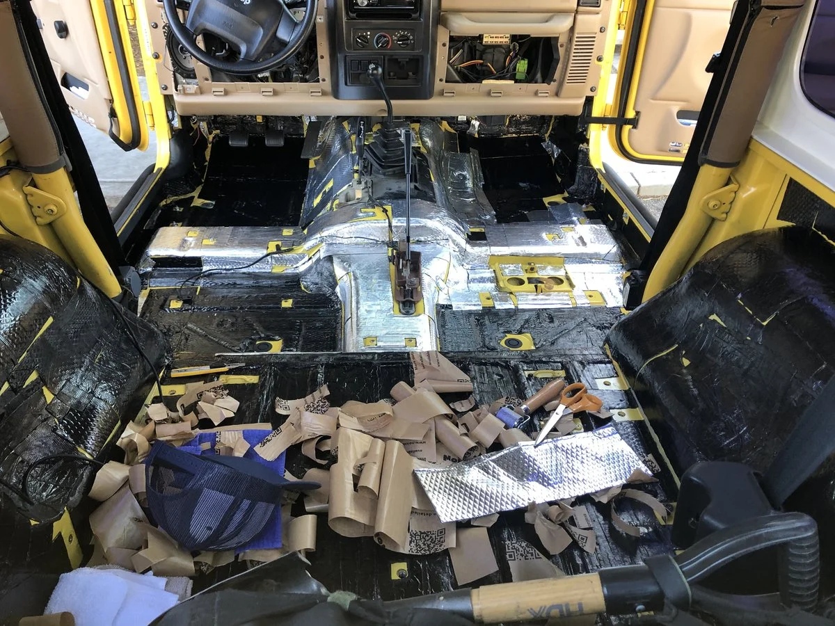

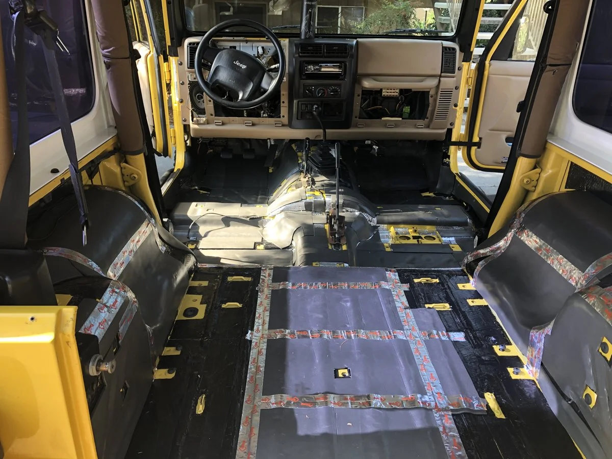

foam laid and taped until I ran out of tape. F it, I’m not taping any more. Time to button it up and see if this hassle was worth it. The only thing I didn’t do was the doors, I can’t find my widow roller tool and I don’t want to mess up my panels so I’ll do those another time.
all put back together. I have to say there is a difference for sure. Most noticeable on the freeway. The regular street driving isn’t super noticeable but on the freeway there’s a pretty significant difference. I’m having the top painted in the near future so I’ll be doing a headliner then and that should even further the sound difference.

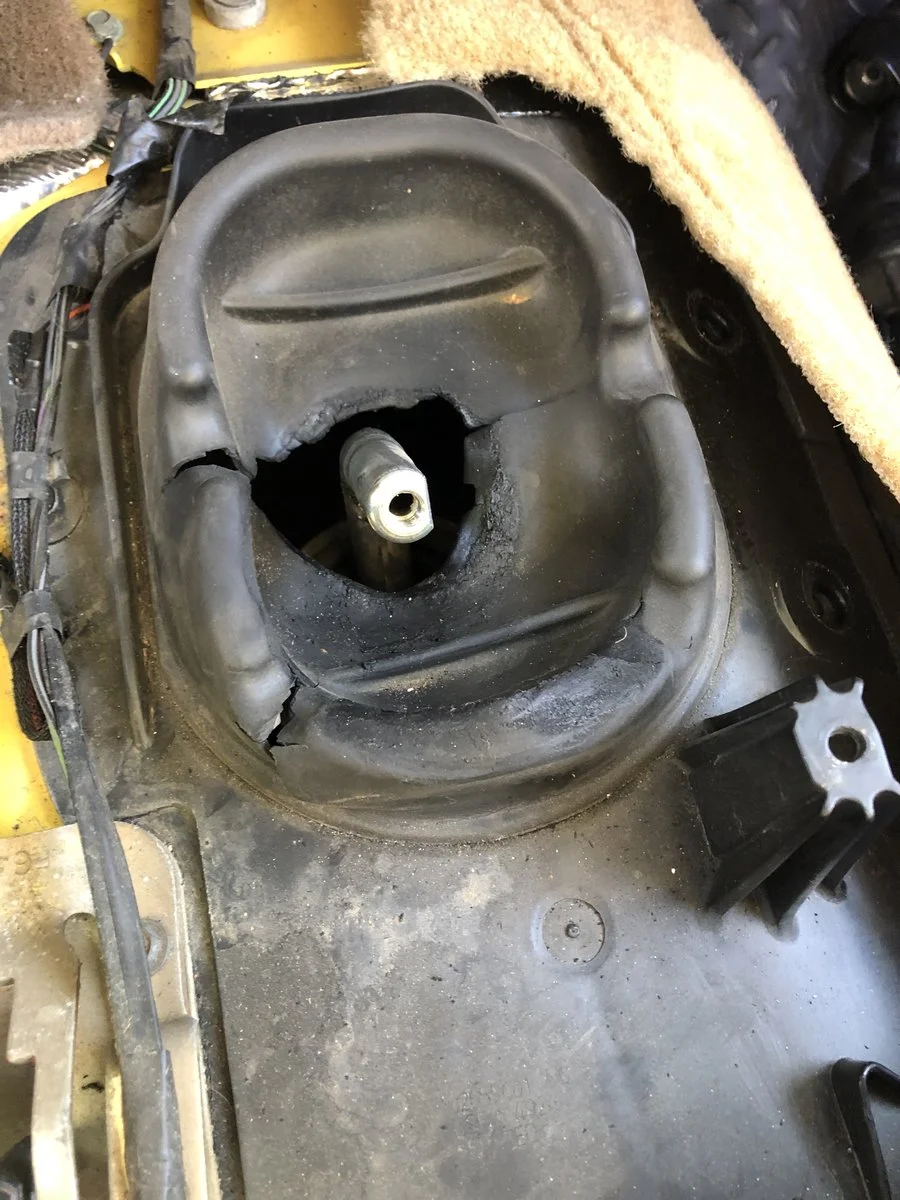

Did a little maintenance today.
Here is some daylight through the hole

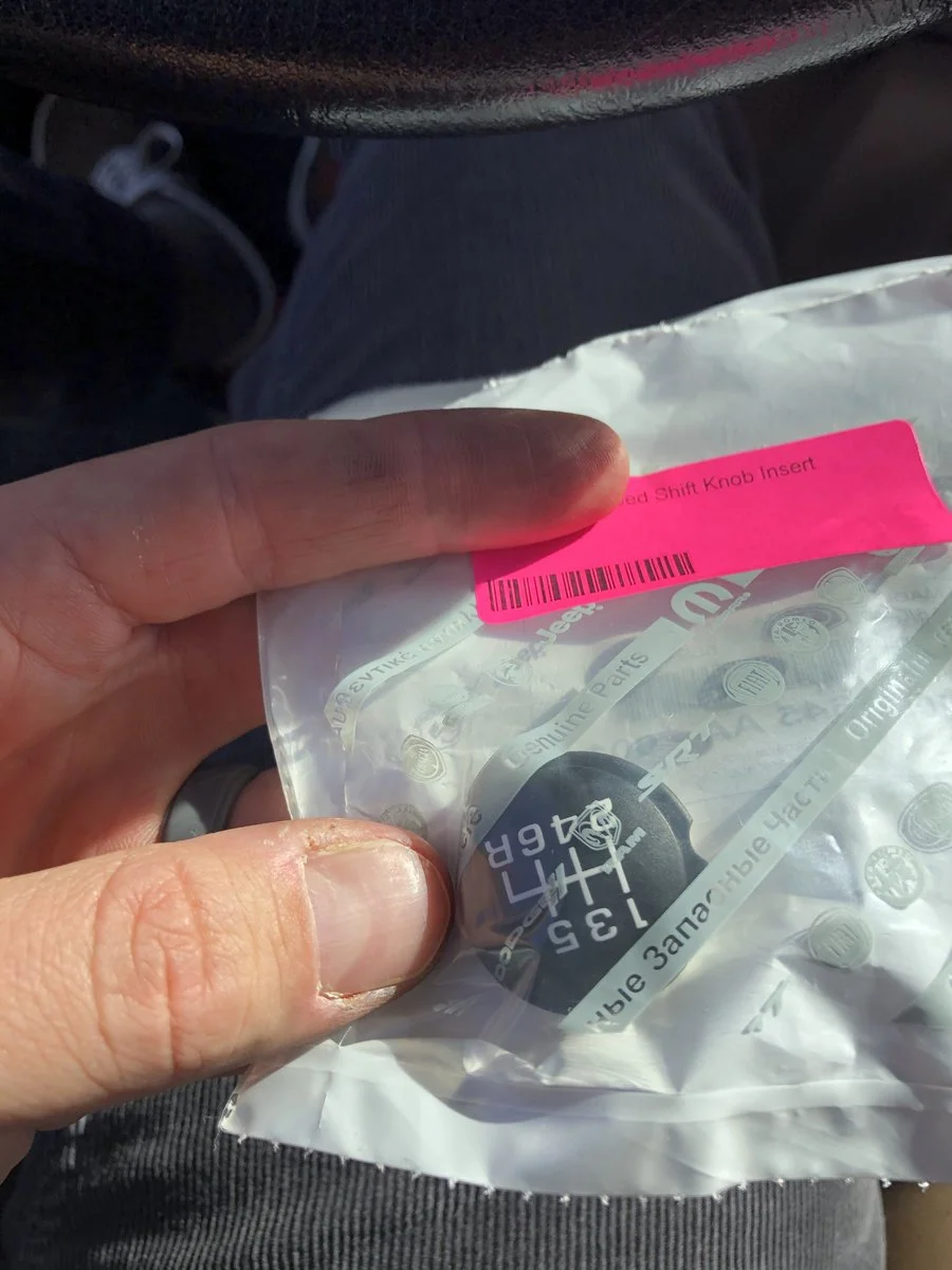

pretty quick and easy job. This is how I removed the little shifter cap.
i did it this way because the last time I pried it out I screwed up the shifter knob, it’s only rubber so I just screwed in a self tapping screw until it popped out. A new cap was cheap.
i cracked this shifter boot bezel when I did the interior swap a while back so I ordered a new boot and bezel
To remove the lower dust boot and make it easy on myself I removed the shifter knob, the front portion of the center console, and the shifter
I had to remove 4 of the bolts on the transfer case shifter plate as well. The bolt holding the shifter on is a T-40 torx under a rubber boot. I tightened all the bolts to just tight because they are more or less held in by little clip on fasteners and rivnuts.
all buttoned up. Took about 30 minutes. It’s a little quieter. I’m thinking the real difference will be in the summertime, heat would just radiate from the tunnel before. The new boot is tight. Pops out of gear in 2nd and 4th now. I’m sure it’ll break in though
