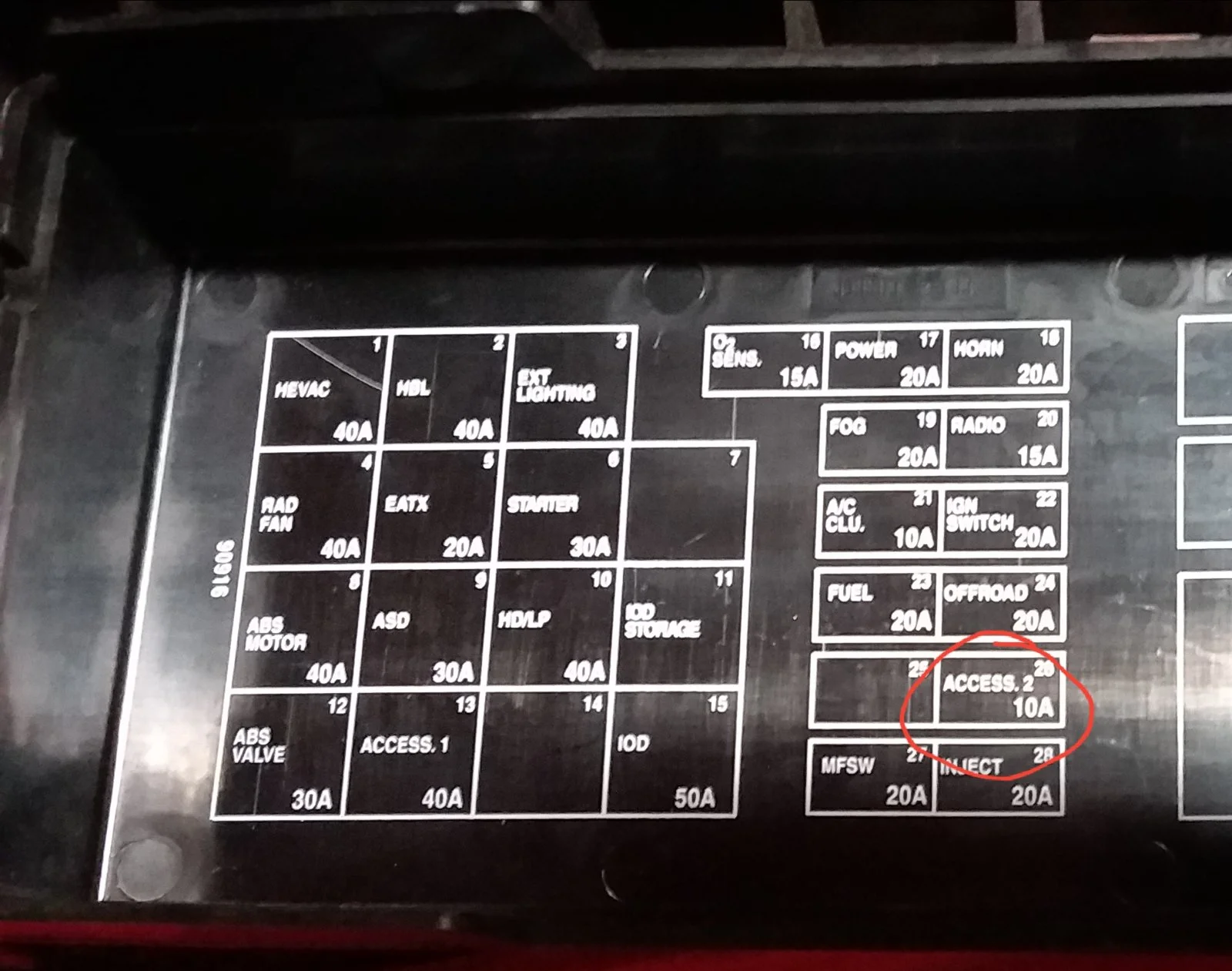

I just discovered that my 10 Amp accessory fuse under the hood is actually blown. When I replace it, it immediately blows again. So how do i how about tracing down the short? Could a loose speaker wire from the old sound bar speaker harness cause a short? OR is it more likely to be innthe dash speakers?

The only symptom for "No Fuse" message on the dash was that the dome lights on the sound bar no longer functioned when doors were opened or by dash light controls. Everything else was fully operational. I thought perhaps the new radio or amp installed was the culprit in creating a short, but after disconnecting radio and amp and replacing the burnt accessory fuse #26 in the engine compartment fuse box the problem continued to exist. So i thought perhaps the old speaker wiring harness ( i had run new wire to new speakers) that i left intact in the sound bar might be making contact with metal and shorting even though i had protect wrapped them in electrical tape. Upon inspection they were fine and not contacting anything. But in the process of replacing the speaker grills i noticed that the grill screws seemed a bit long for what their purpose was and taking a closer look i realized that the screw mounting location of the aftermarket grill i was using overlapped the area where the sound bar light wiring was located. I swapped out the long screws for short screws, replaced fuse #26, connected the battery, and Lights On and the No Fuse message was gone. I must have nicked a dome light wire with the speaker grill screw. Was really happy to have figured this basic problem out. Cheers.

What ended up being the issue. Going through the hassle of trying to figure out why my #26 fuse is popping instantly but no luck
