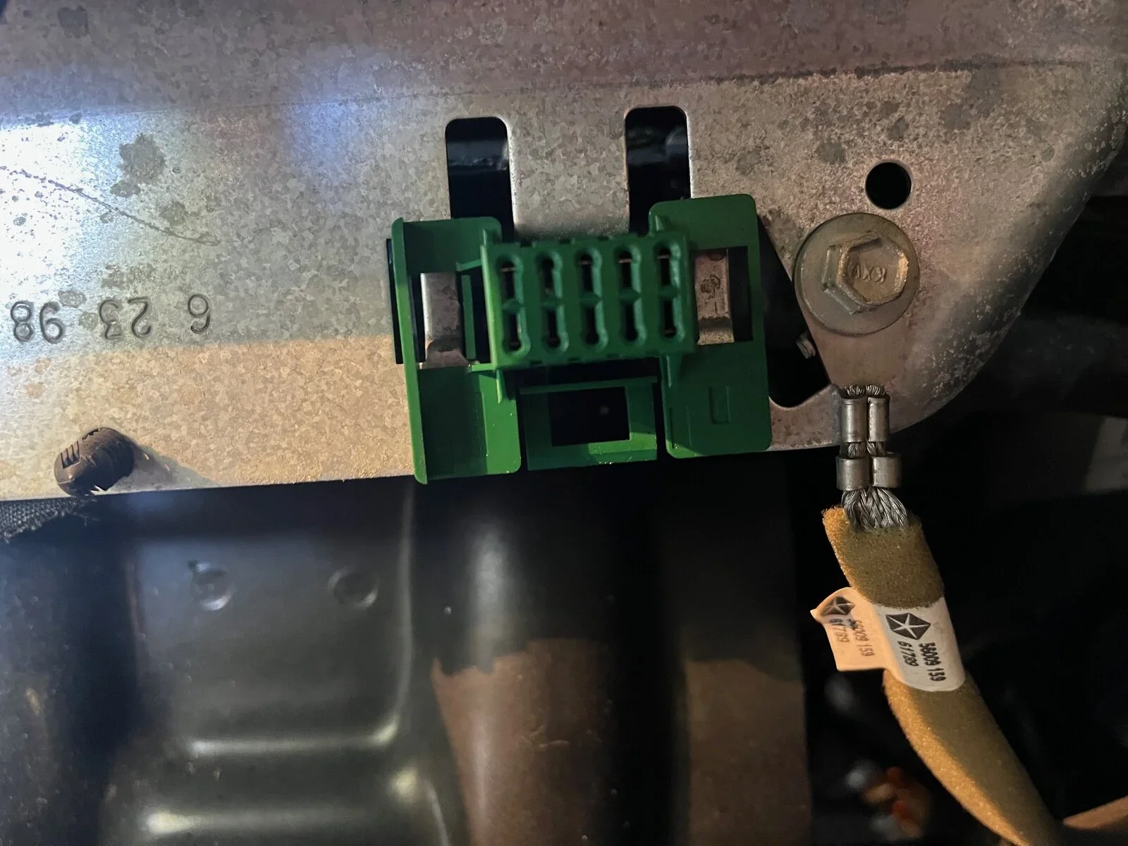

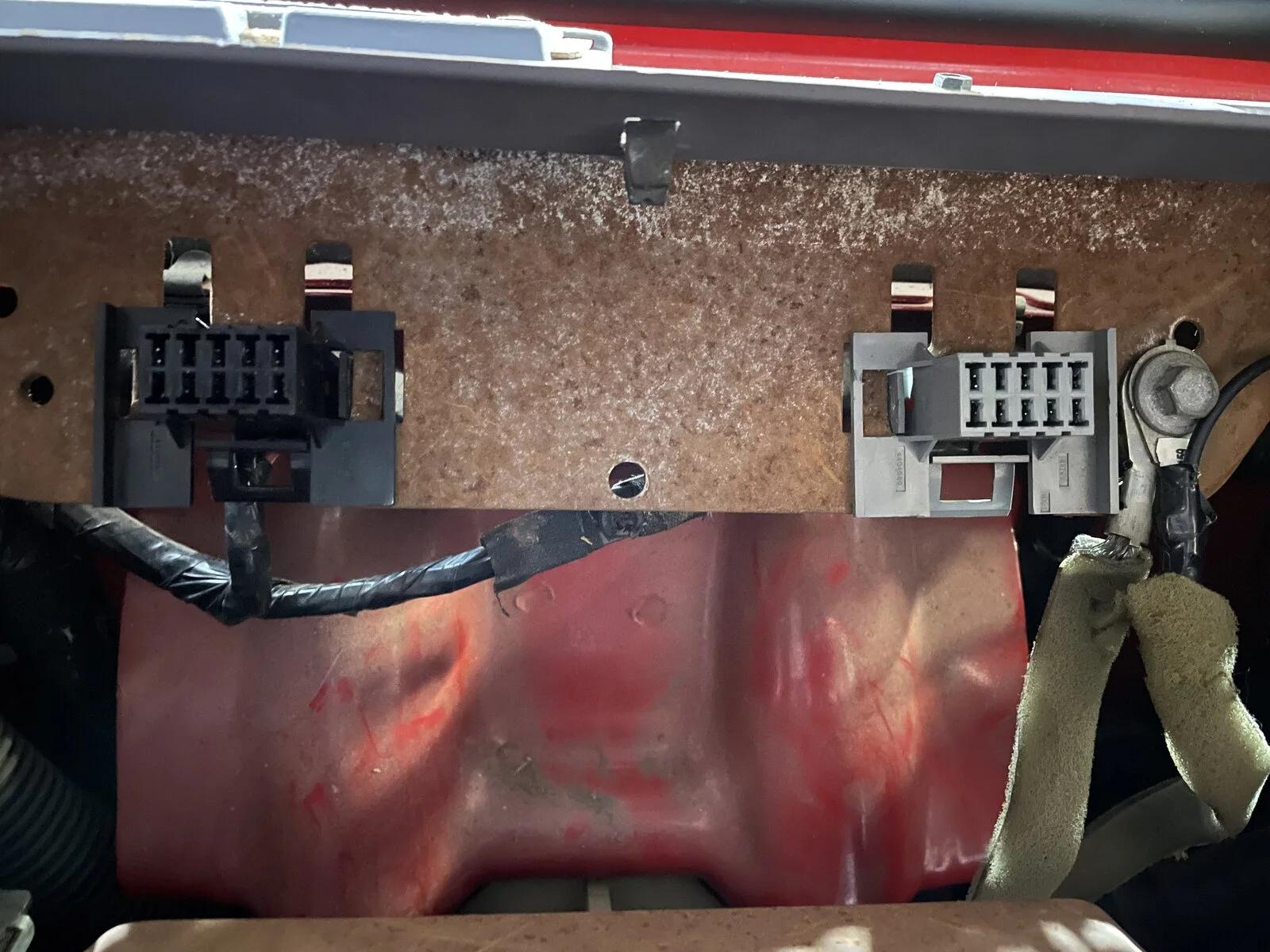

Did the cluster test and all needles dance and all the lights come on.
Confirmed that both fuses (glove box and under hood) are fine.
Pulled the cluster. Cleaned the pins and gave them a 1/4 twist.
Rev/speedo do come in intermittently so do you think could be bad earth, any idea of location?
