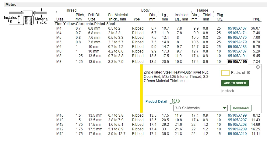

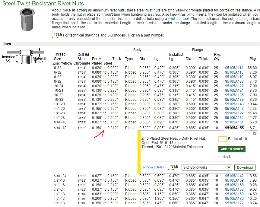

Source nutserts and matching 8mm flange head bolts locally. The nutsert will be a matching 8mm, typically 1.25mm thread pitch. The hole size when accurately measured will help. Typically they are 17/32 or .531 or metric equivalent 13.5mm.
The frame is roughly .150 thick so you run the risk of the shallower nutsert not setting fully. I use the ones for a thicker material.
If it wasn't clear, 8mm and 5/16" sizes are essentially interchangeable for stuff like this for every aspect except the threads being slightly different.
From McMaster, the nutserts we would use are as follows-
Equivalent in metric versions-

Aahh thanks for that. I did search but didn't see your question. I'm pretty sure the bolts are M8 and I can source M8 rivnuts locally and a mate has the air powered install tool so will give that a go..
OK - installed M10 Rivnuts today and used new M10 hardware as the M8 nuts available to me where too small for the pre-drilled holes in the frame. All fits perfectly.
