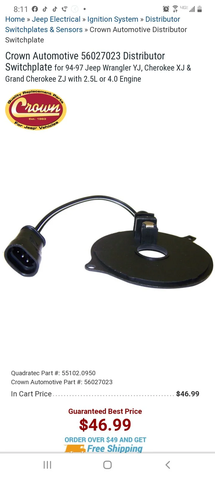

What brand crank and cam sensors did you install and can you test for 12 v at the coil while cranking.
I had a no spark with a bran new cam sensor. Maybe try a better brand like Echlin ? Mine was a chinese one.
Does the coil have to be plugged in a back probed to test? Or can I crank unplugged and test at the connector
this is the cam sensor used.
