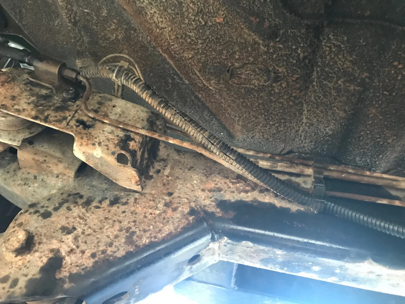

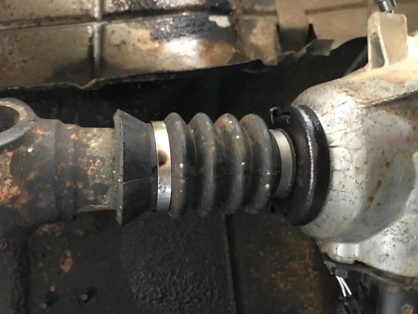

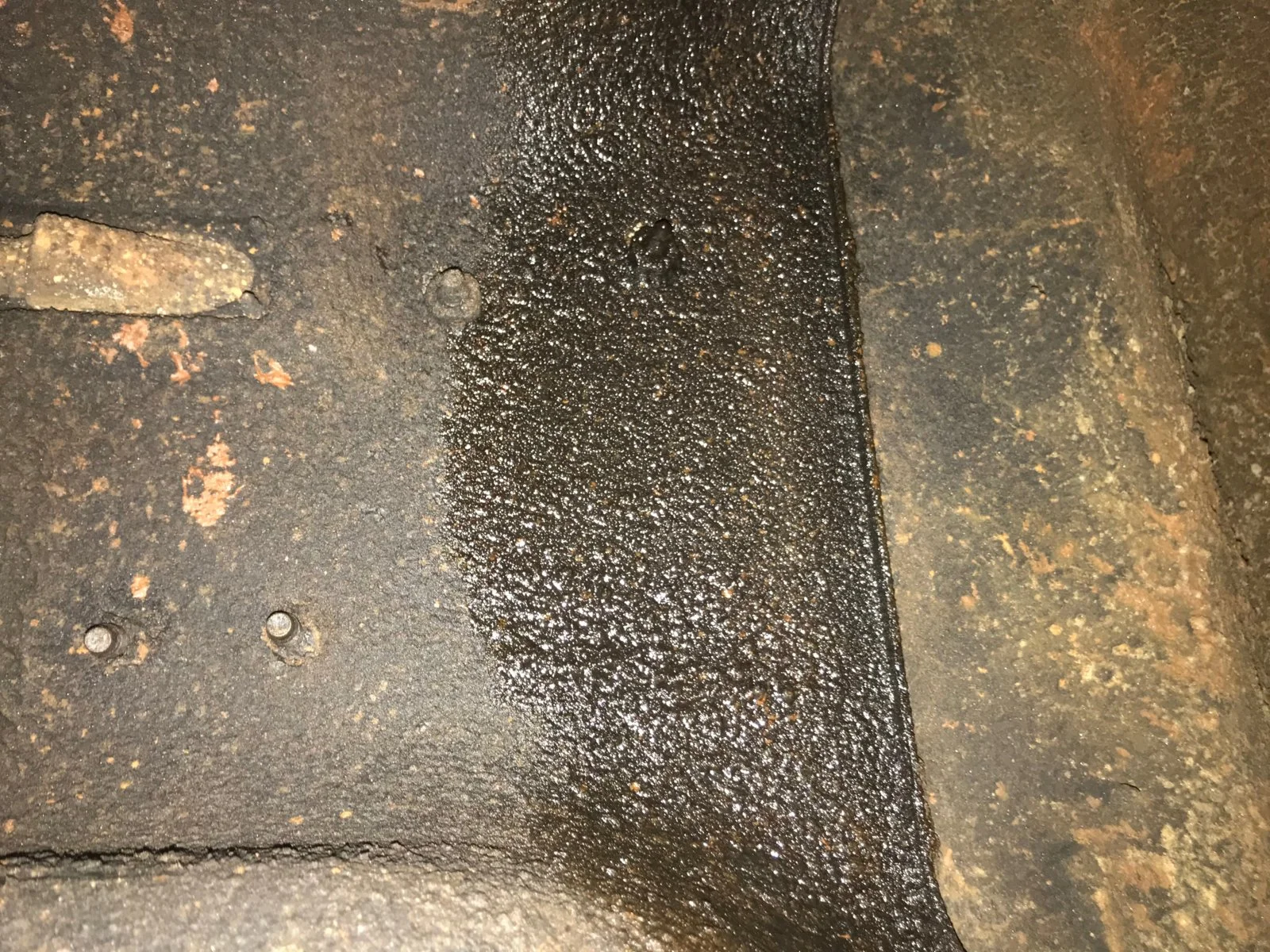

I have what I believe to be a significant rear output shaft leak that is spinning fluid all over my rear end :).
Does anyone have any tips for removing and replacing this? Is the seal something that just goes bad eventually?
Yep, like all seals, that one goes bad as well. The procedure is outlined in the FSM (which I'm sure you know). This video is for a NP231 from a Cherokee XJ, but it's the same procedure:

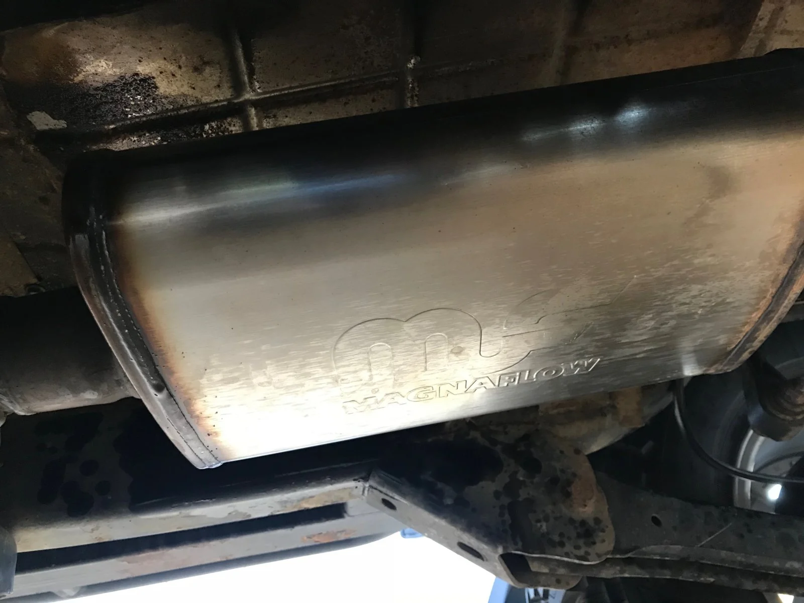

Dang dude! Your jeep is hemorrhaging from everywhere! WTF!
Seriously though, jezz.
