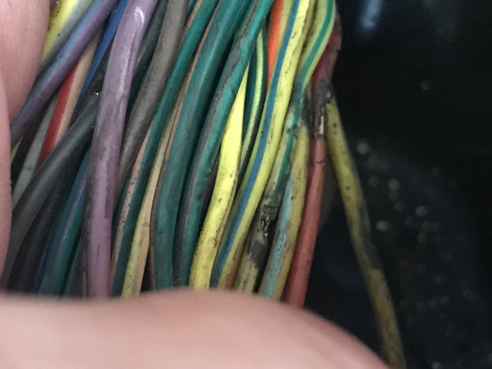

Check your harnesses very well. The poor guy chased wires for weeks. Two pieces of electrical tape and he’s still running strong.
