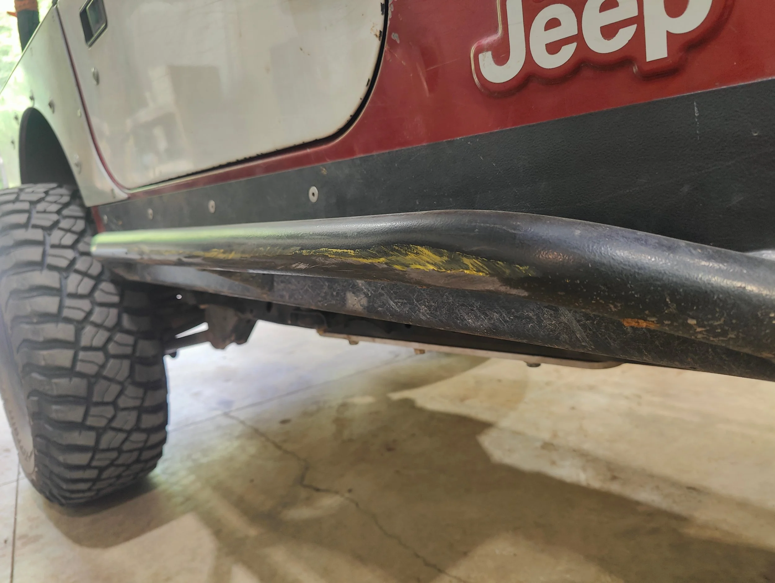

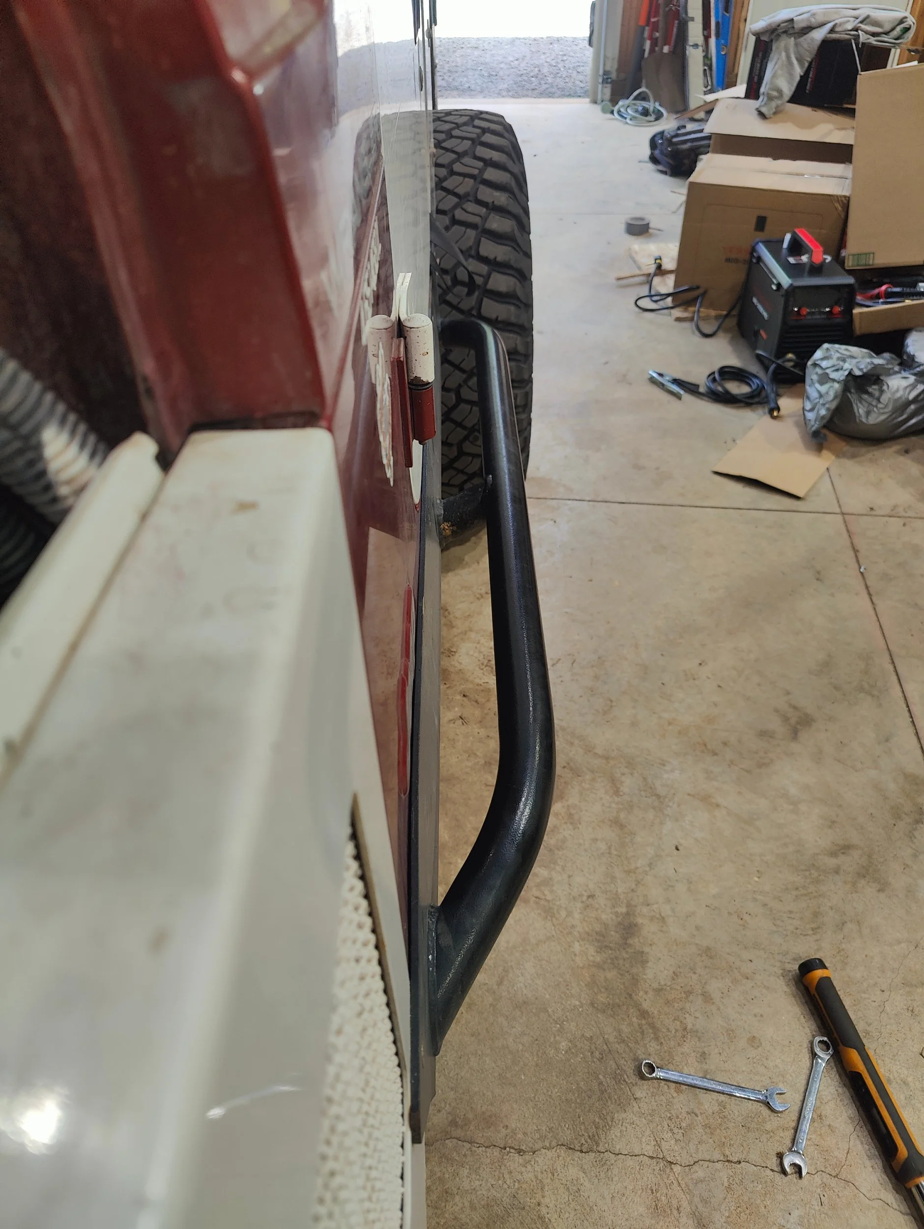

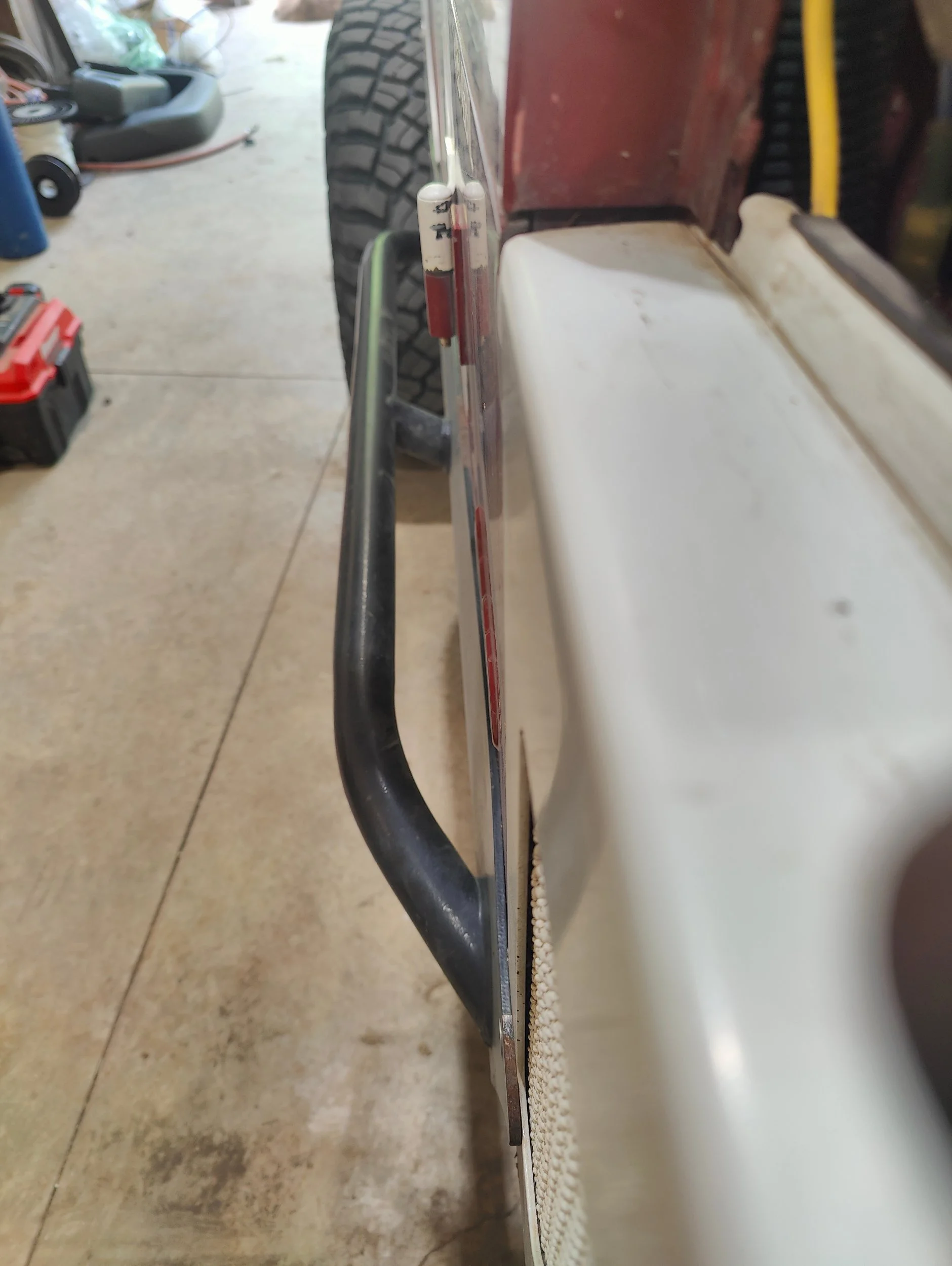

Worst damage I did was getting a milkshake in town...they had yellow pylons just under hood height and I turned into one driving out of the drive through. I don't know if that slightly bowed the slider or if it was something else. It definitely caved in the tube slightly in two spots. Rock Hard sliders.

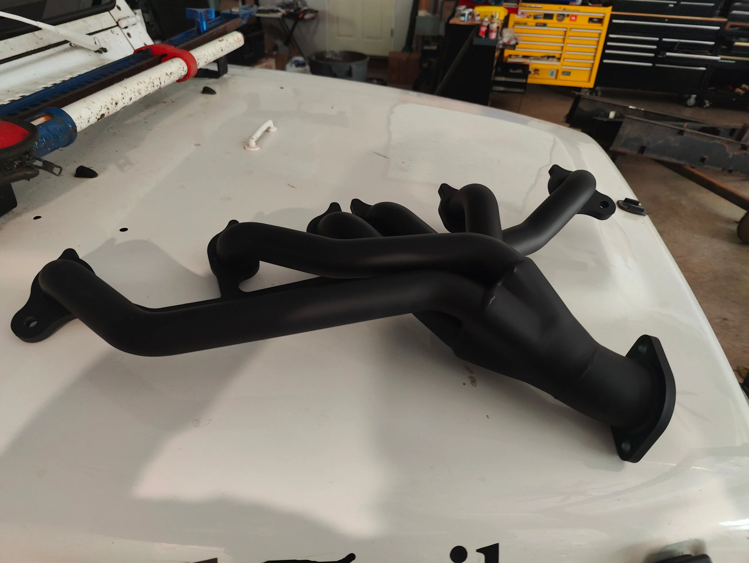

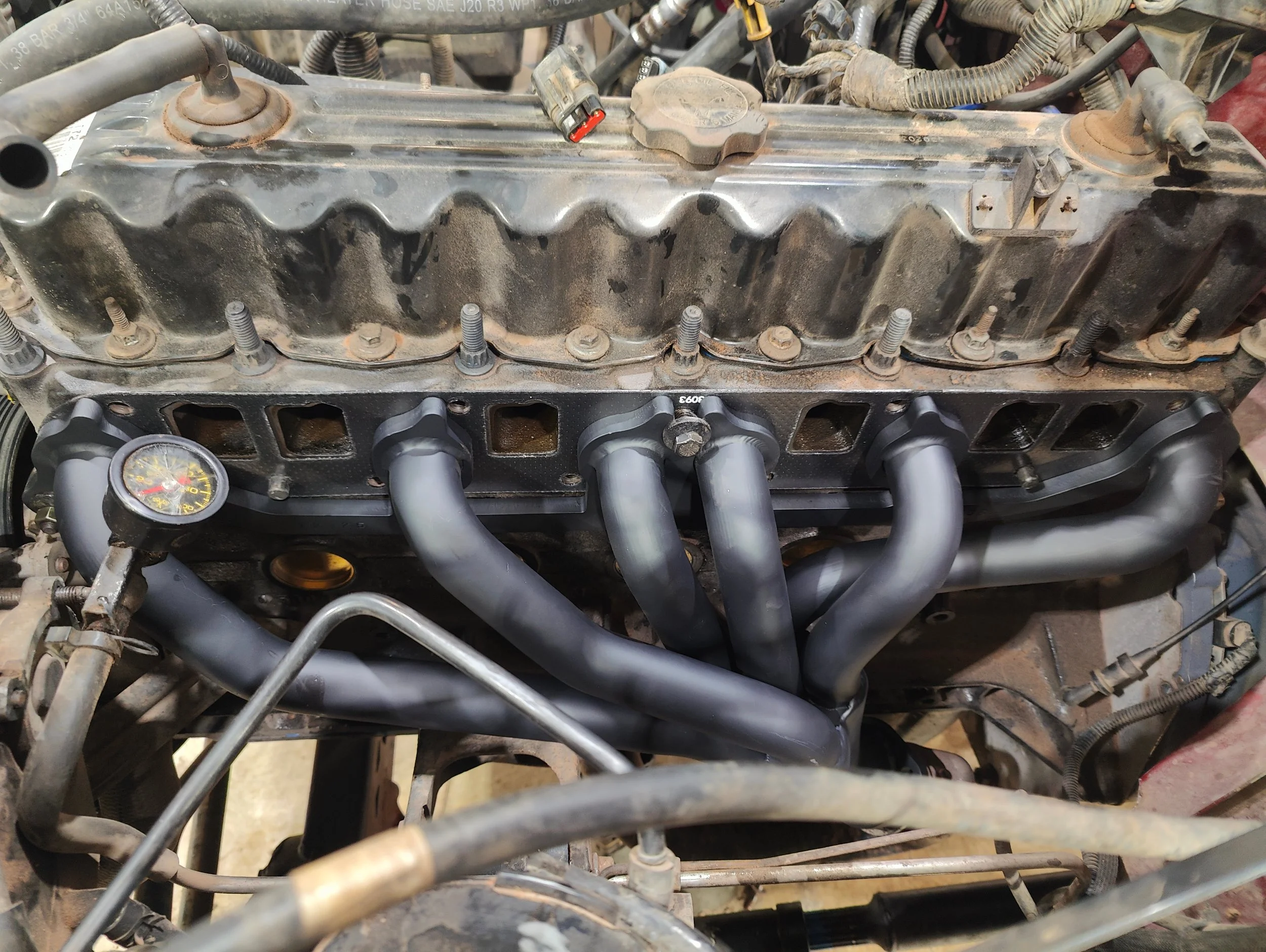

Pulled the exhaust manifold and replaced it with my warranty replacement freshly back from ceramic coating. Noticed I was missing one exhaust flange nut and I must have missed an exhaust header bolt.

Resealed the exhaust donut flange with red RTV good to 650 degrees. It was leaking. So tired of that terrible connection. Hoping now that I've glued it together that I don't have to touch it for a couple of years.

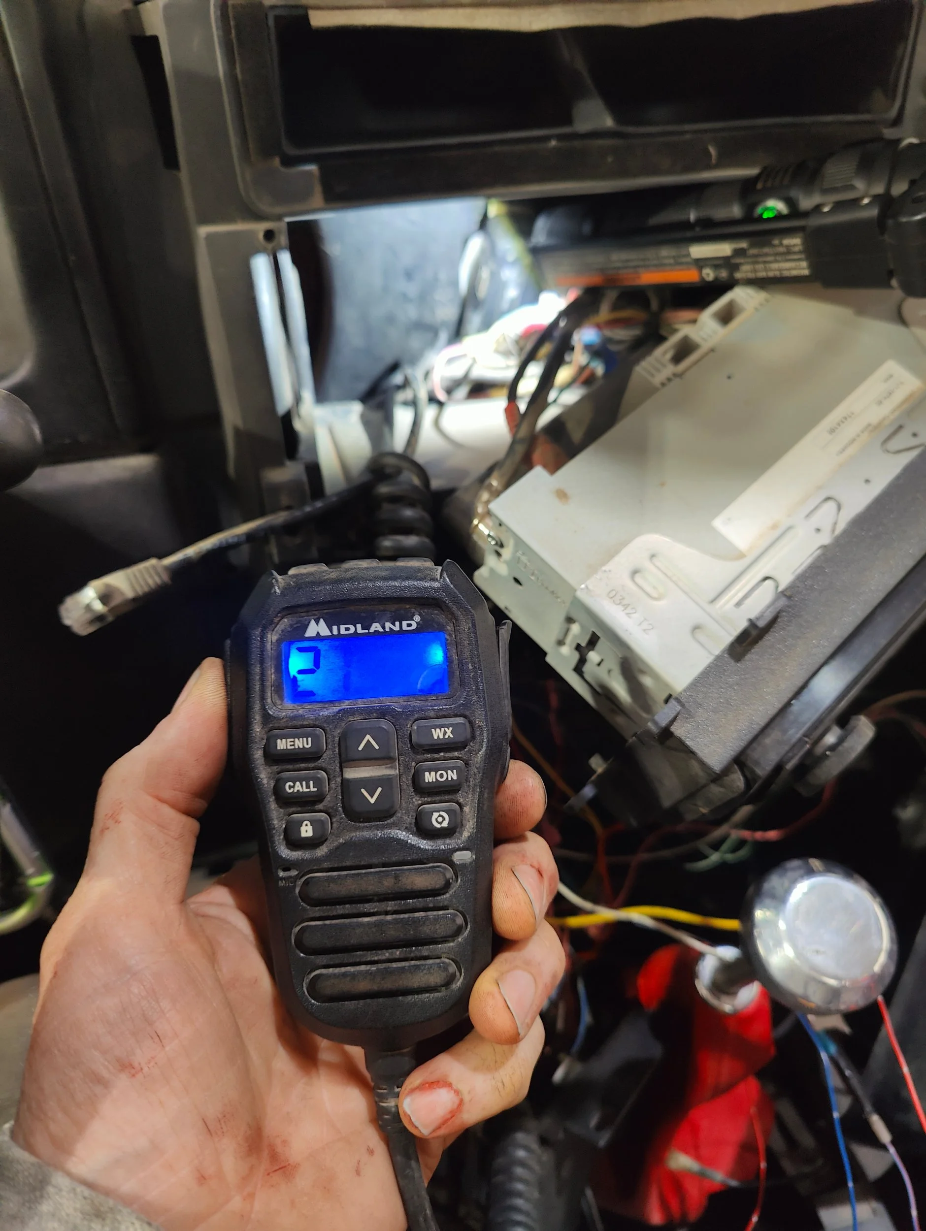

Pulled apart my dash. One...to check on my Midland GMRS radio. Wasn't transmitting. Plugging the handset directly into the radio...without the ethernet cable and bulkhead connector...same results. Ordered a new handset for $65 from Midland.

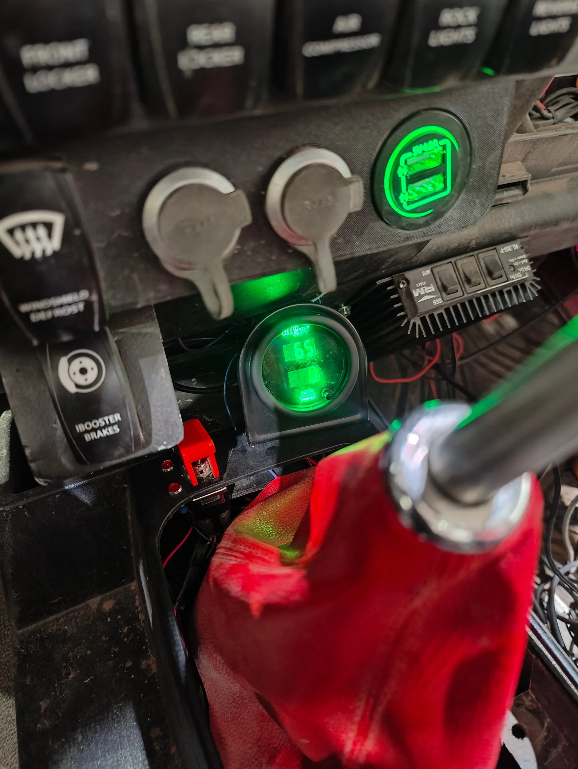

Installed a new DPST locker master arm switch and indicator lights. Previous switch attempted to interrupt the grounds to the relay and failed to function. New switch essentially turns on two separate circuits. So it's wired in series with the relay trigger switch on the dash. I also added two bright LED indicator lights. While the Carling switches on the dash light up when turned on...the light is faint enough that you can't see it in bright sunlight. Also removed the self tappers holding down the oil pressure/temp gauge and replaced them with rivets and slightly angled the gauge for readability. Looked at adding clearance for my transfer case shifter...but it's hitting the metal gate under the console...not the console itself. While I could clearance that...that leads me to think the problem might still be in the adjustment or the transfer case itself.

View attachment 688472View attachment 688473View attachment 688474

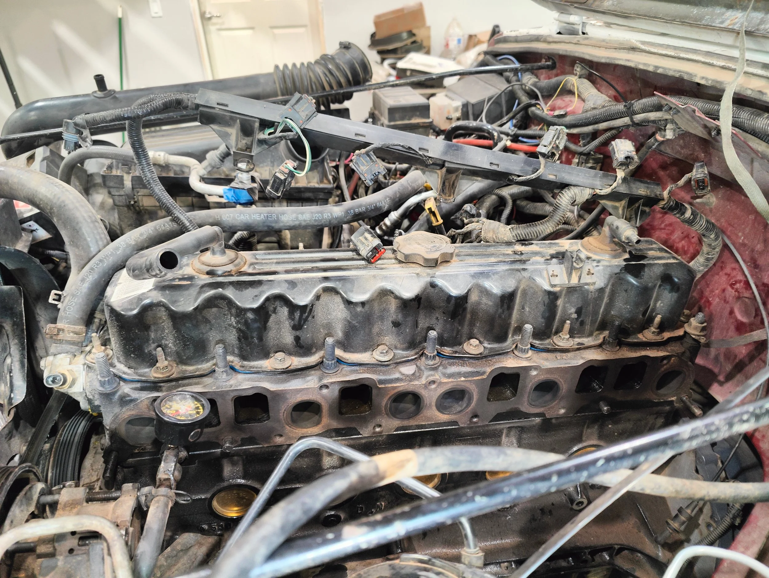

Great to be hearing from you again, Mac.
Well back from Sand Hollow. New engine performed flawlessly. Got about 6-8 mpg crawling and running 4-5k rpm in the sand dunes. Got anywhere from 11-13 on the freeway. Generally feels like I've lost about .5 mpg in exchange for more power.
I noticed you're running head studs rather than bolts. Is there a particular reason? Just curious.
Reactions: Wildman
Nope...just new Felpro bolts. Didn't know the provenance of the ones off the XJ block... especially since someone had replaced the pistons once...so I bought new ones.

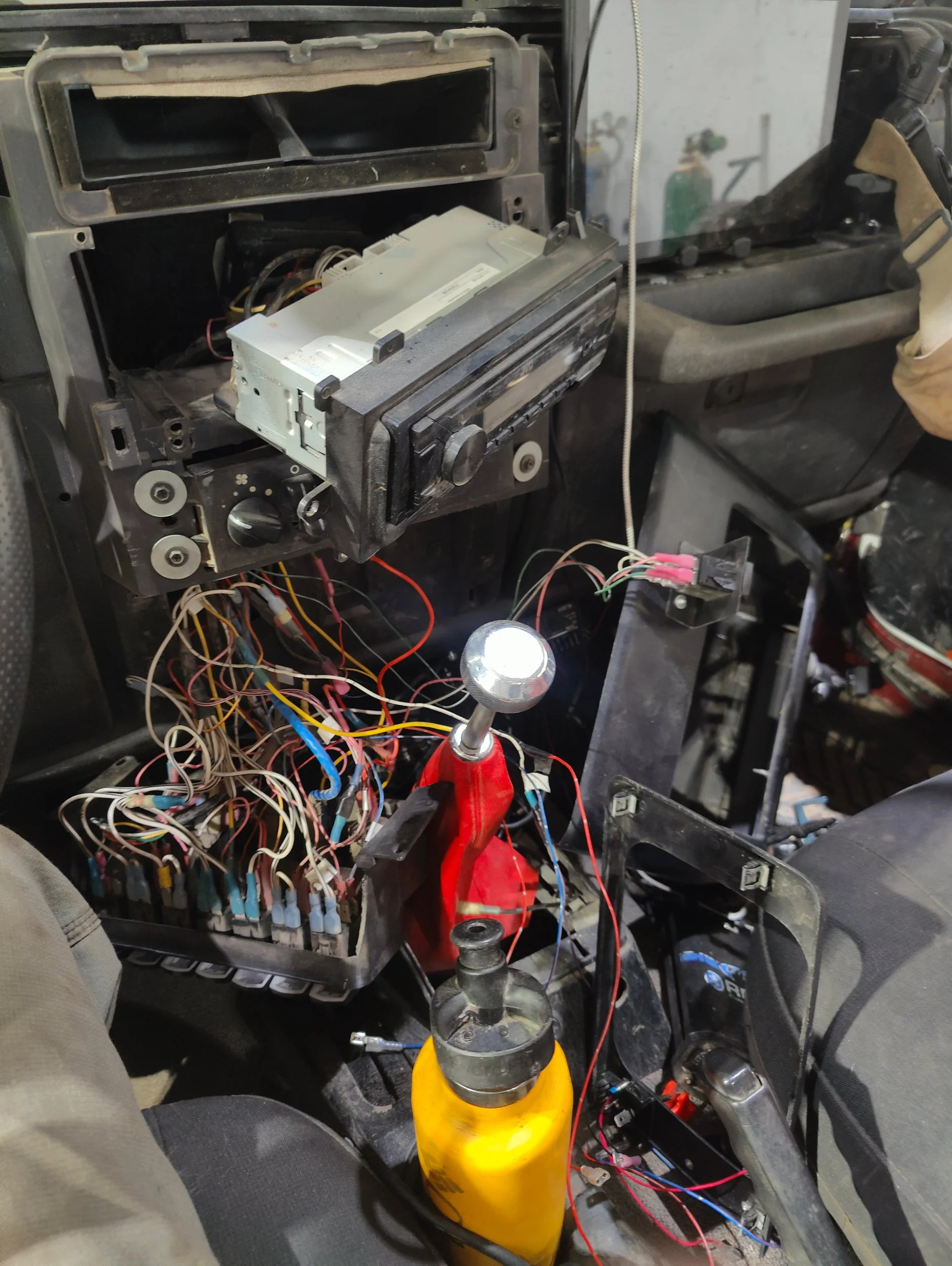

How do you sleep at night knowing that lives behind the dash?
That gives me anxiety issues :D
90 percent of those wires are essentially bus lines. Every switch needs two grounds, one illumination circuit and a positive feed to run through the switch...and run through a wire back to the relay block.
I probably could and should just daisy chain the wires rather than running them into a pigtail.
Problem is too I've added circuits and rearranged things...so that's added to the mess.
I also made the mistake of individually fusing each of the 12v trigger feeds. Realistically that could run off the cigarette lighter fuse.
Damn thing is it all works. And like @E-Ticket 's solid state relay failure and plenty of stories of failures of modern switch panels...old school just works.
And that sound the switches make is a positive reminder you actually turned something on.

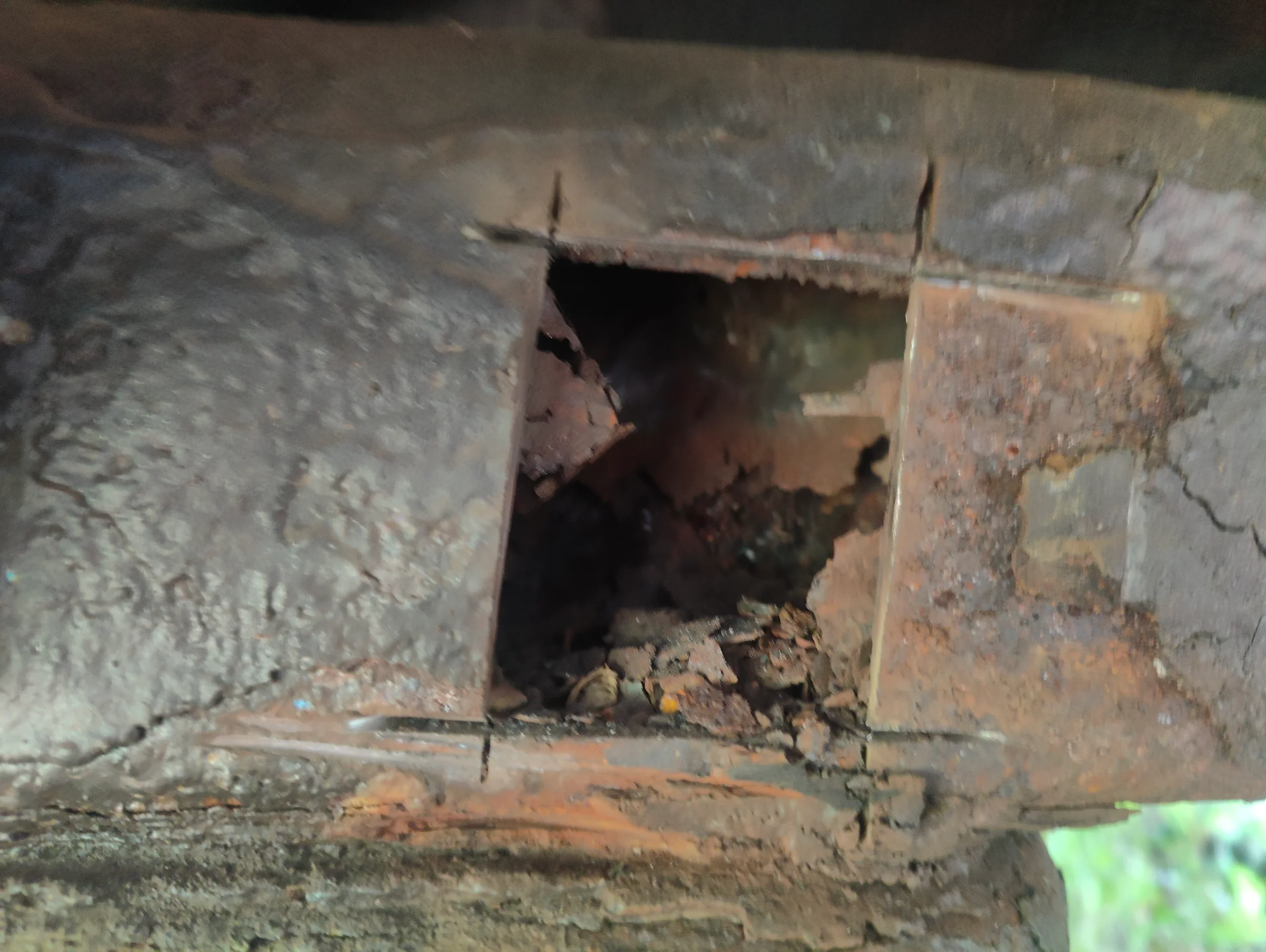

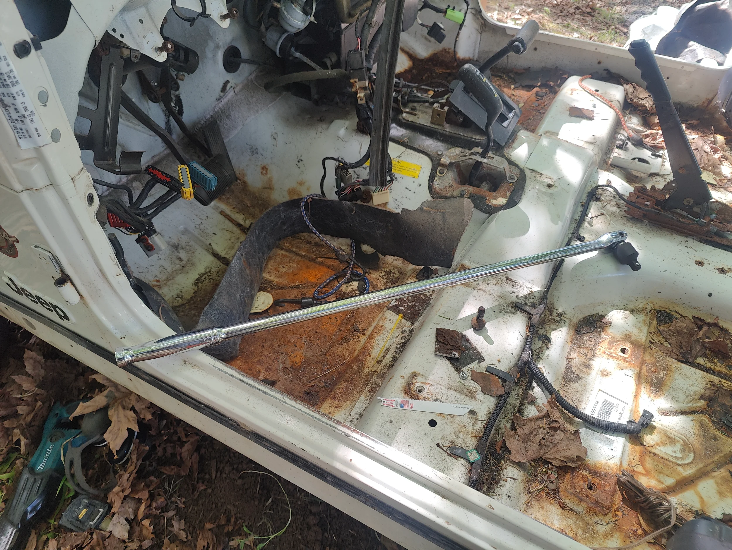

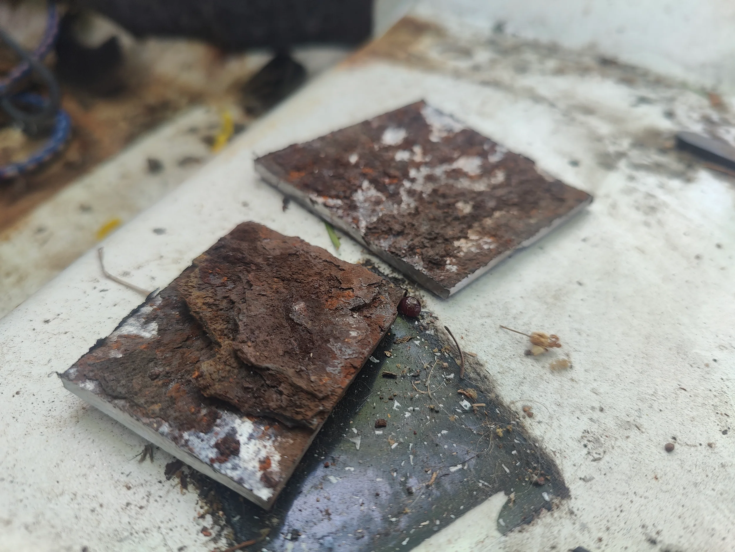

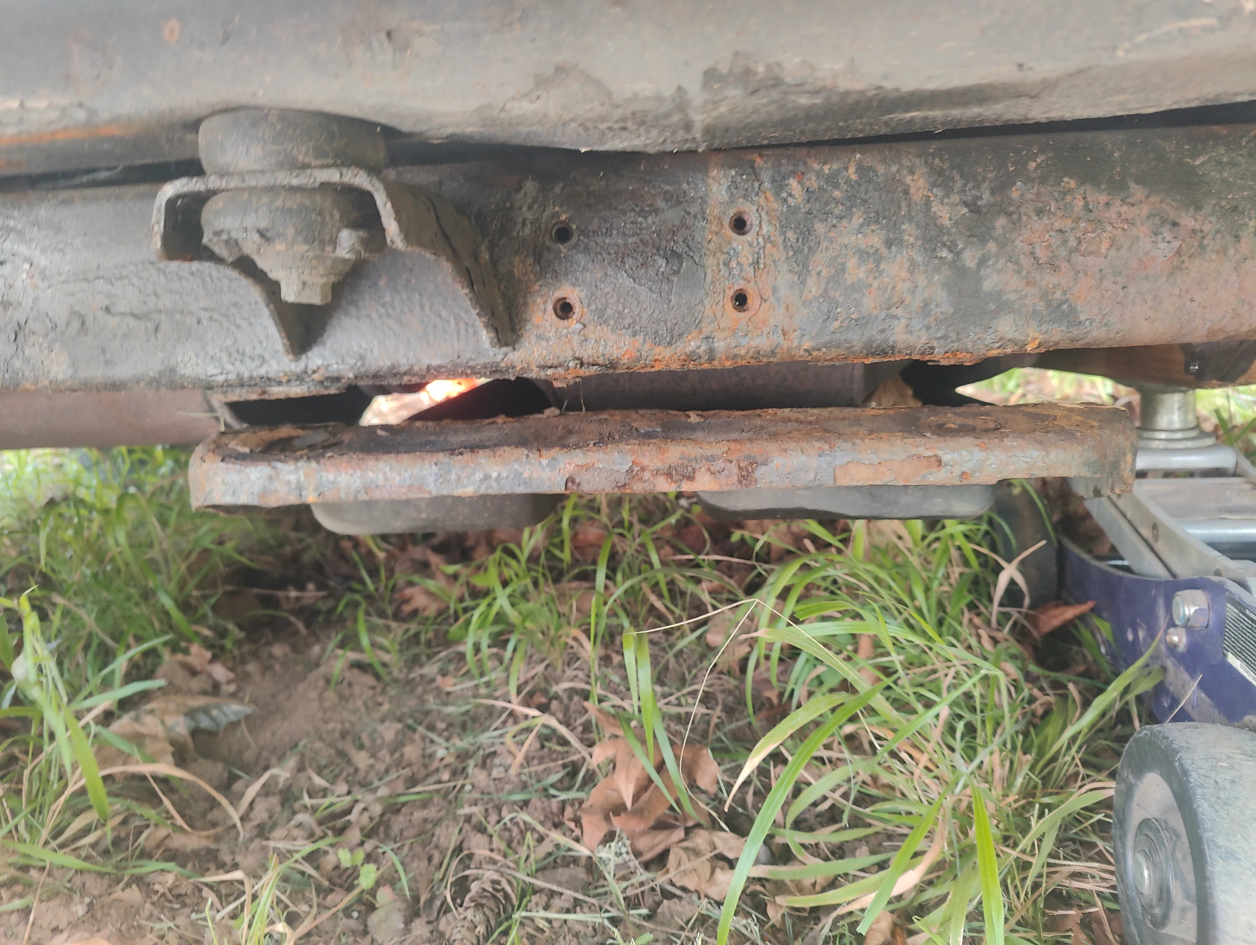

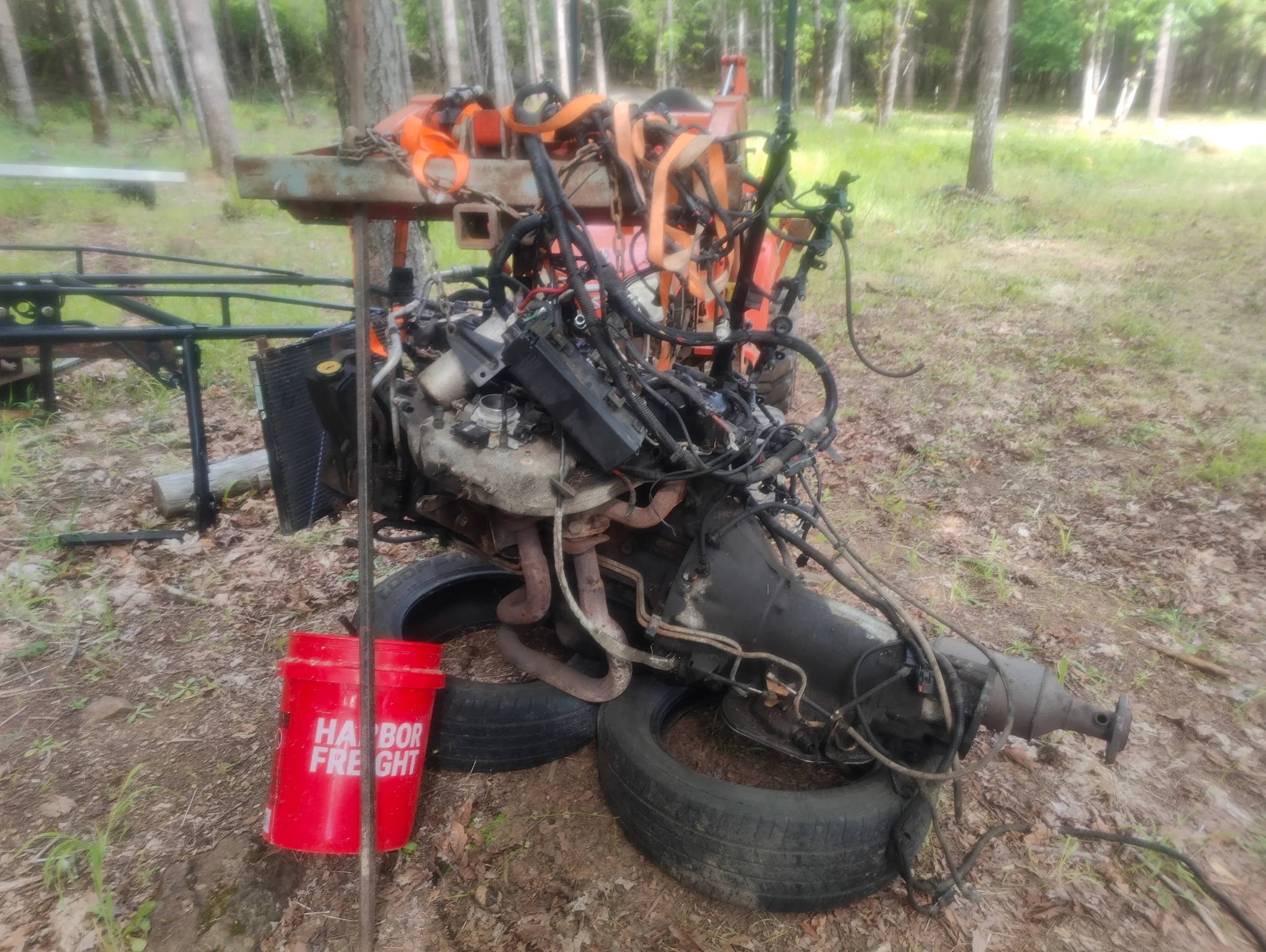

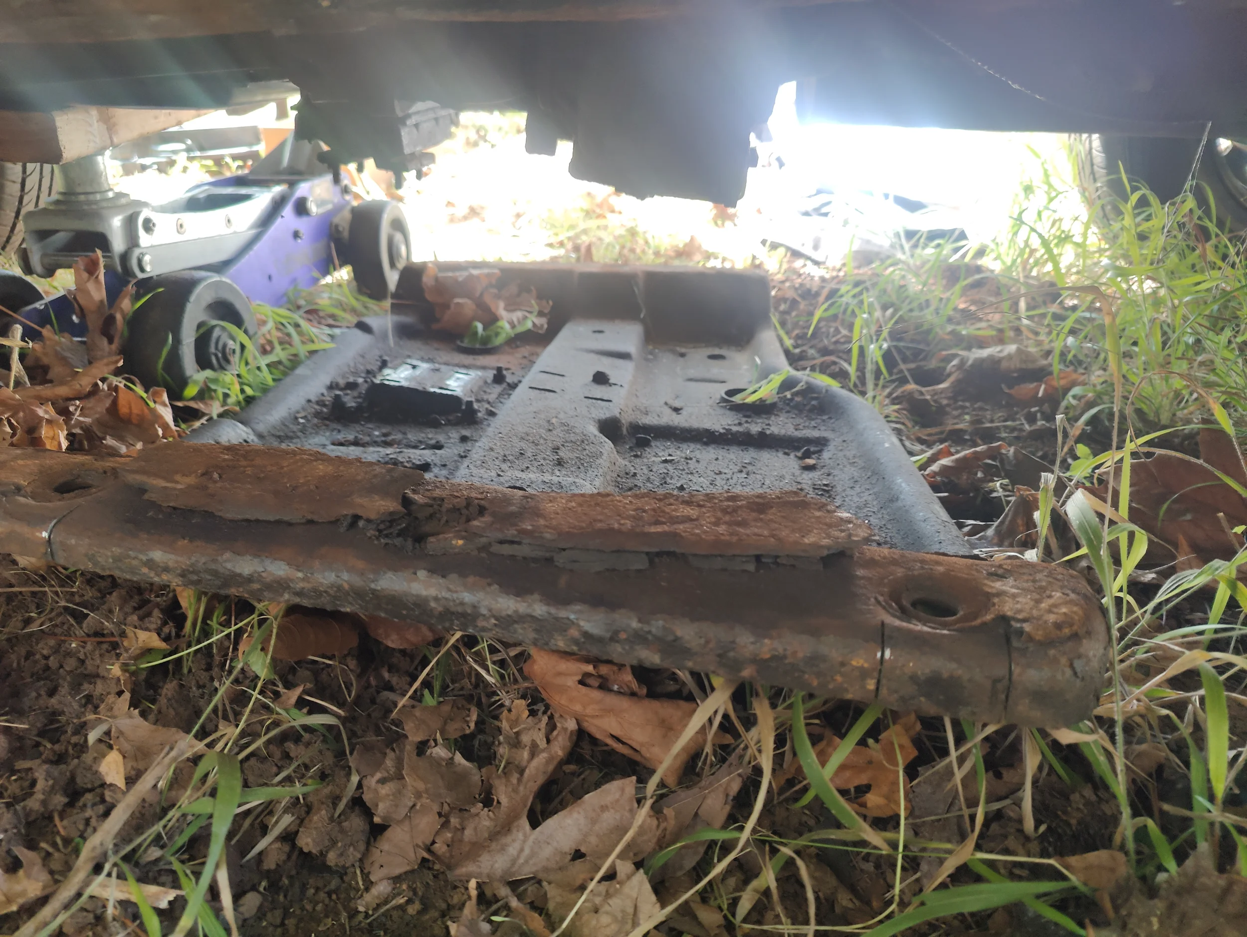

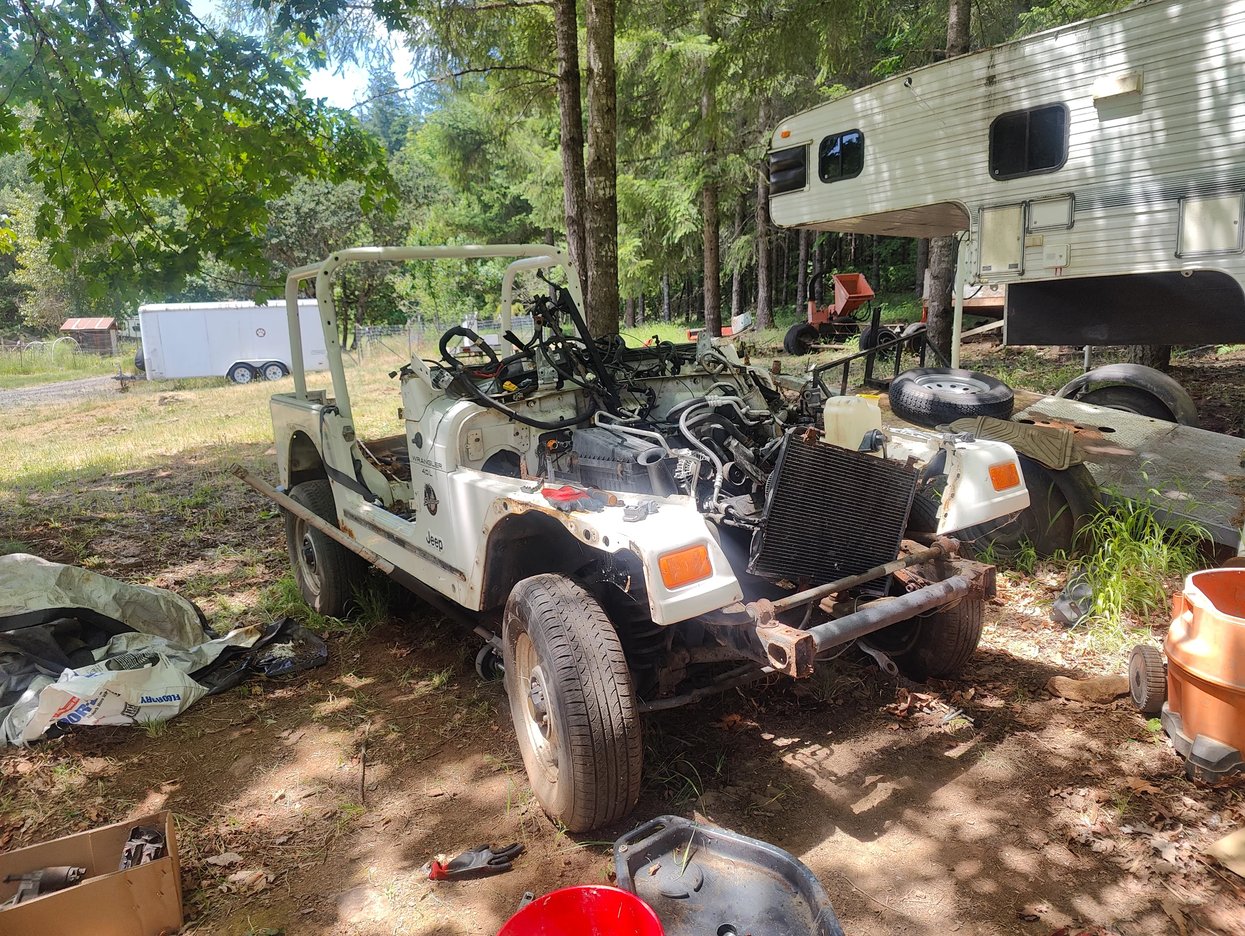

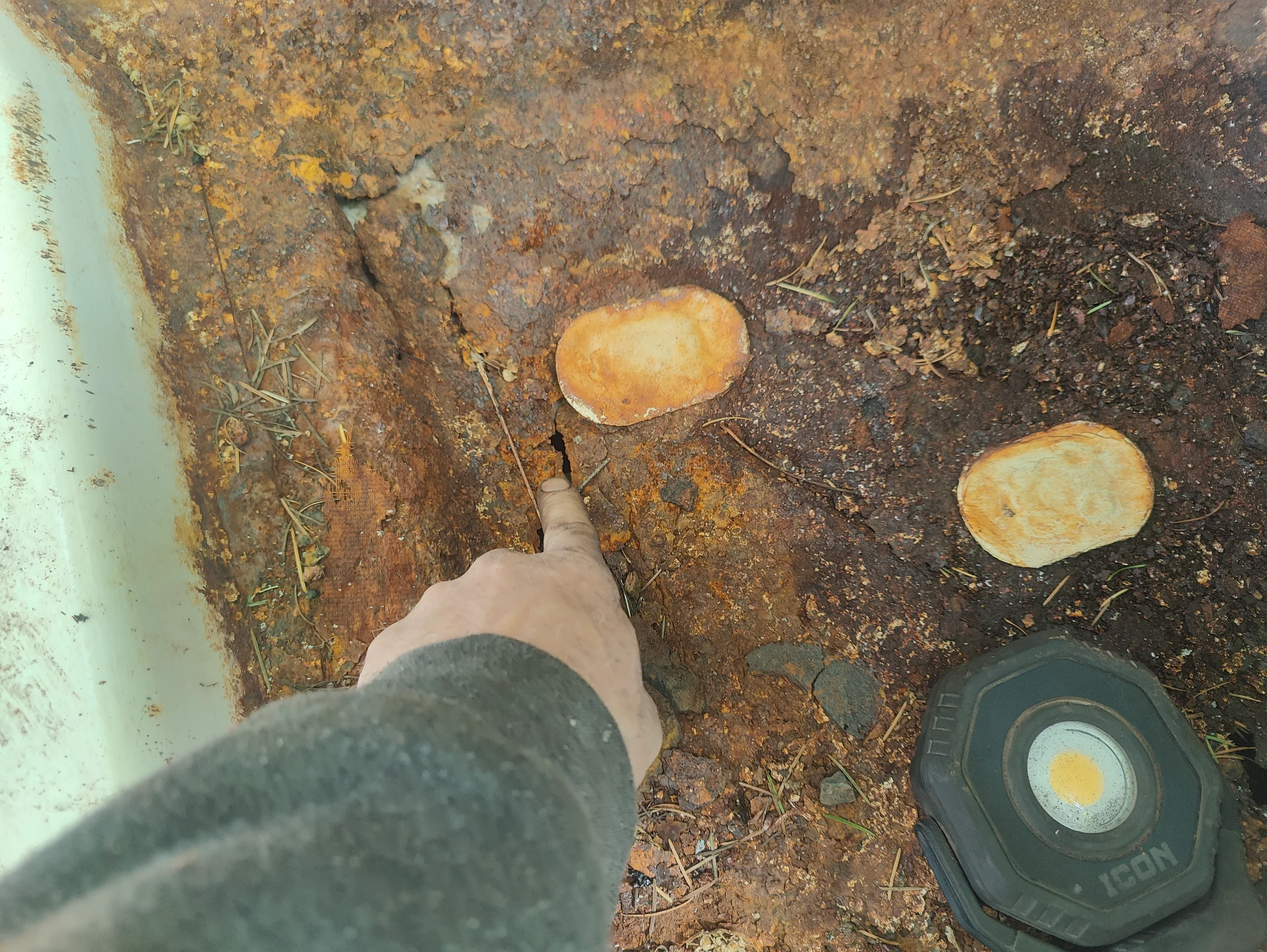

Sold the Sayonara Sahara's engine, my old AX-15, bellhousing, wiring harnesses and PCM to a fella doing a 4.0 swap on his 4 cylinder. Spent the day pulling the engine and transmission. Rust was a bastard.
-Mac

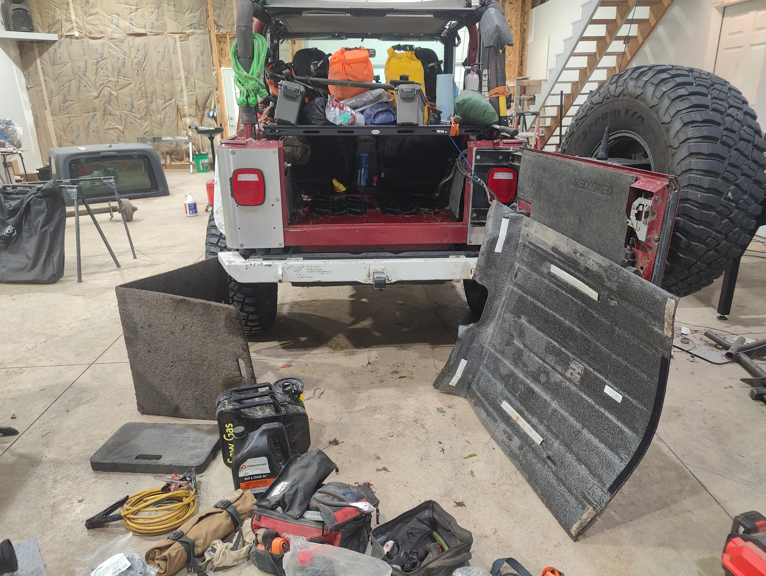

First off my TJ got trashed outside of Idahana, OR finding trash for the Brush Beaters OHV club. It was supposed to rain a little around 1 pm and ended up raining all day. Thank goodness for insulated coveralls. Pulled a bunch of stuff out of my Jeep...it was full of rocks and leaves...and wet under the bed rug. My new electric top handle Makita is dead... apparently can't handle the rain.

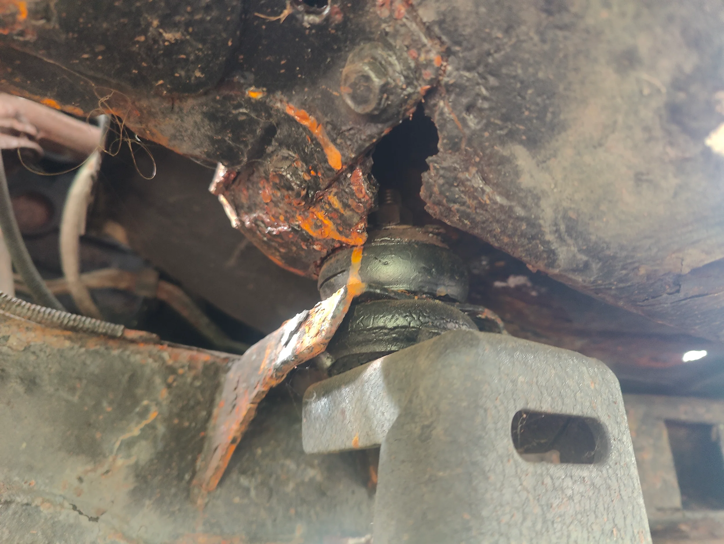

Then I messed with steering...tried figuring out why I'm wandering all over the road. Passenger side lower ball joint castle nut was loose. Red loctite, torque to 80 and new cotter pin. And my Hooke Road steering linkage correction bracket was loose. Need to get it up to speed tomorrow and see if that improves things. I have the Sayonara's steering box as a hail Mary.

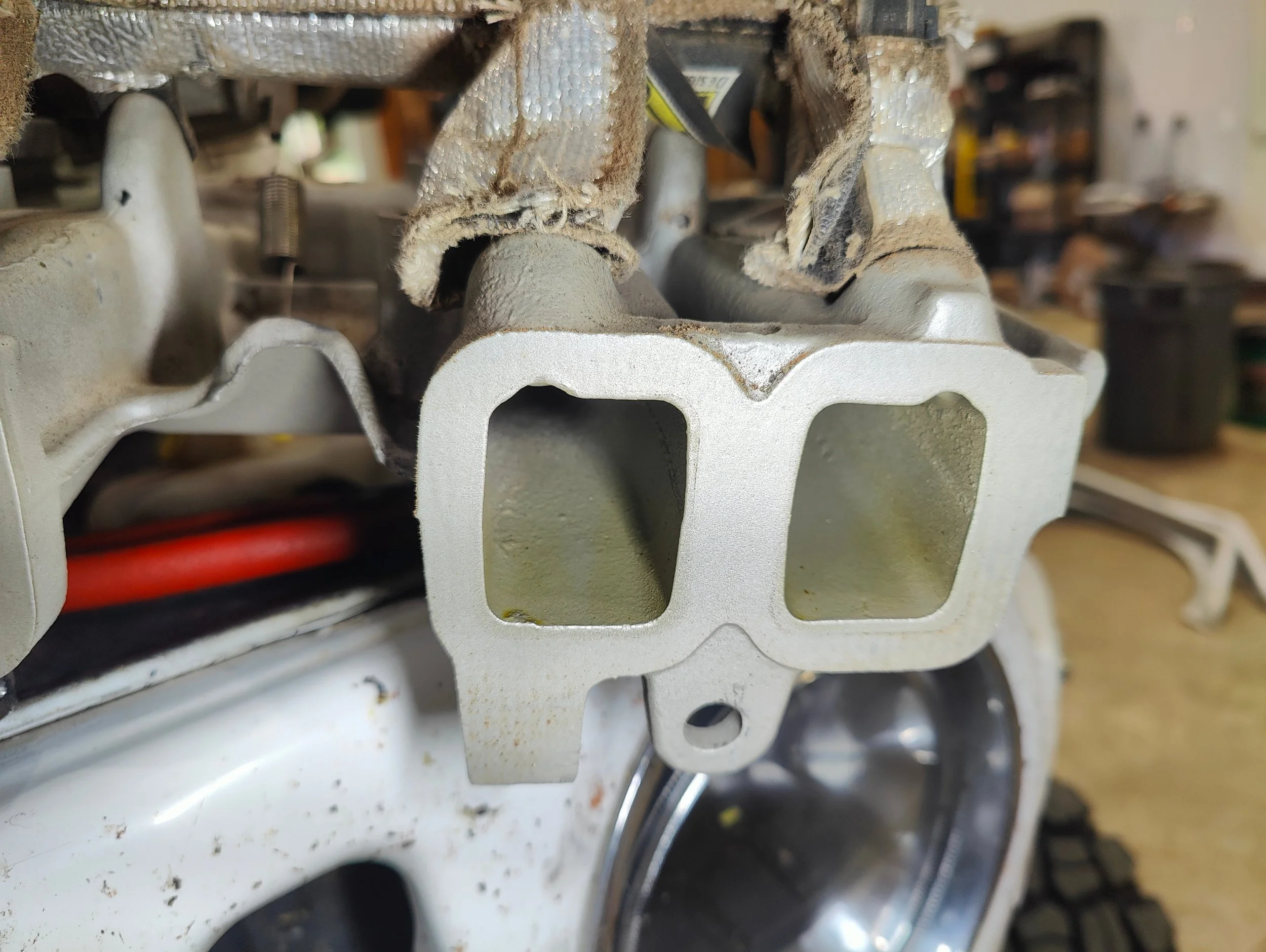

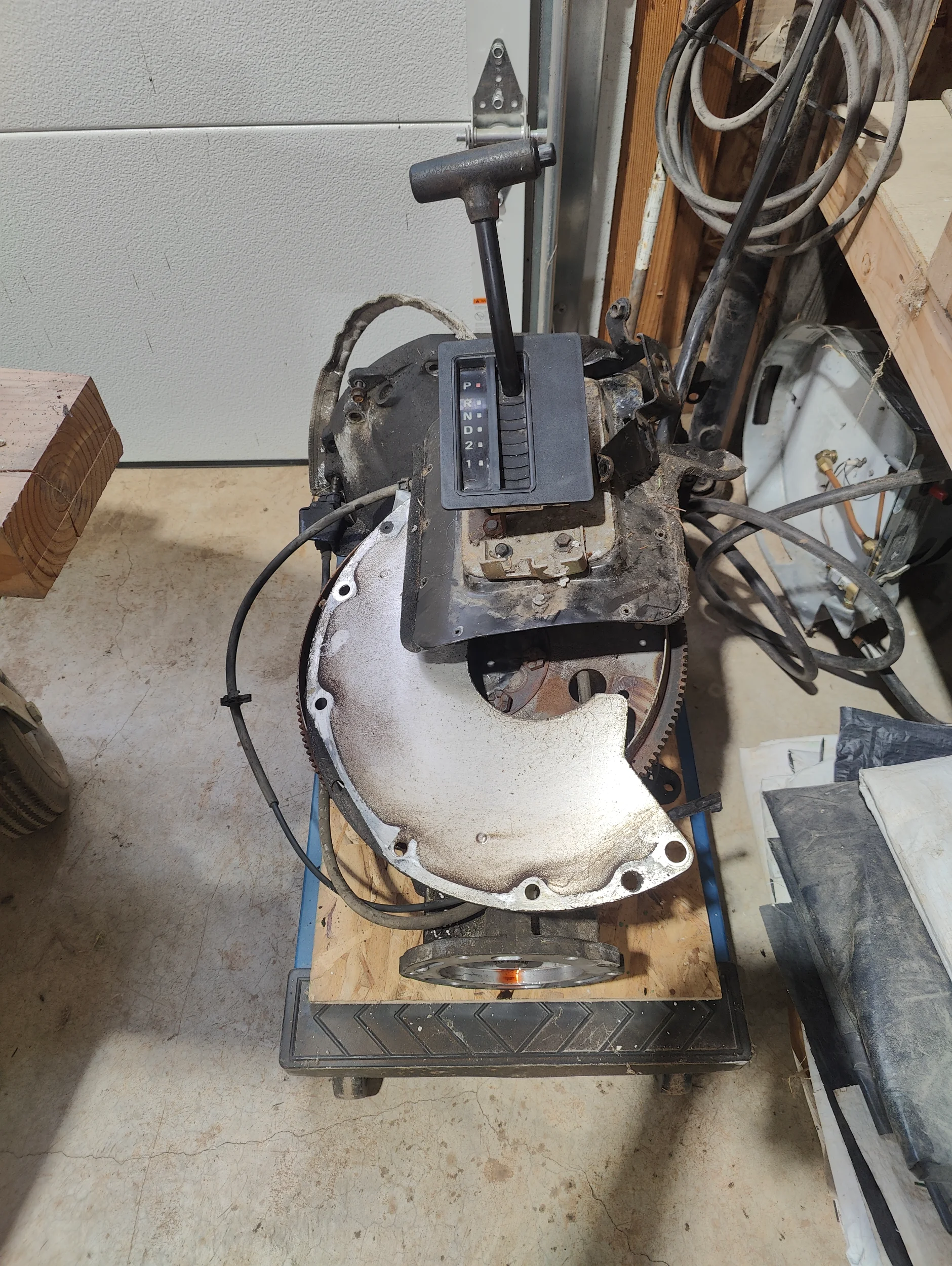

Next up separated the 32RH from the Sayonara Sahara's 4.0. Made a nice stack on a moving dolly for possible future swap potential. I can't believe how small the torque converter bolts are.

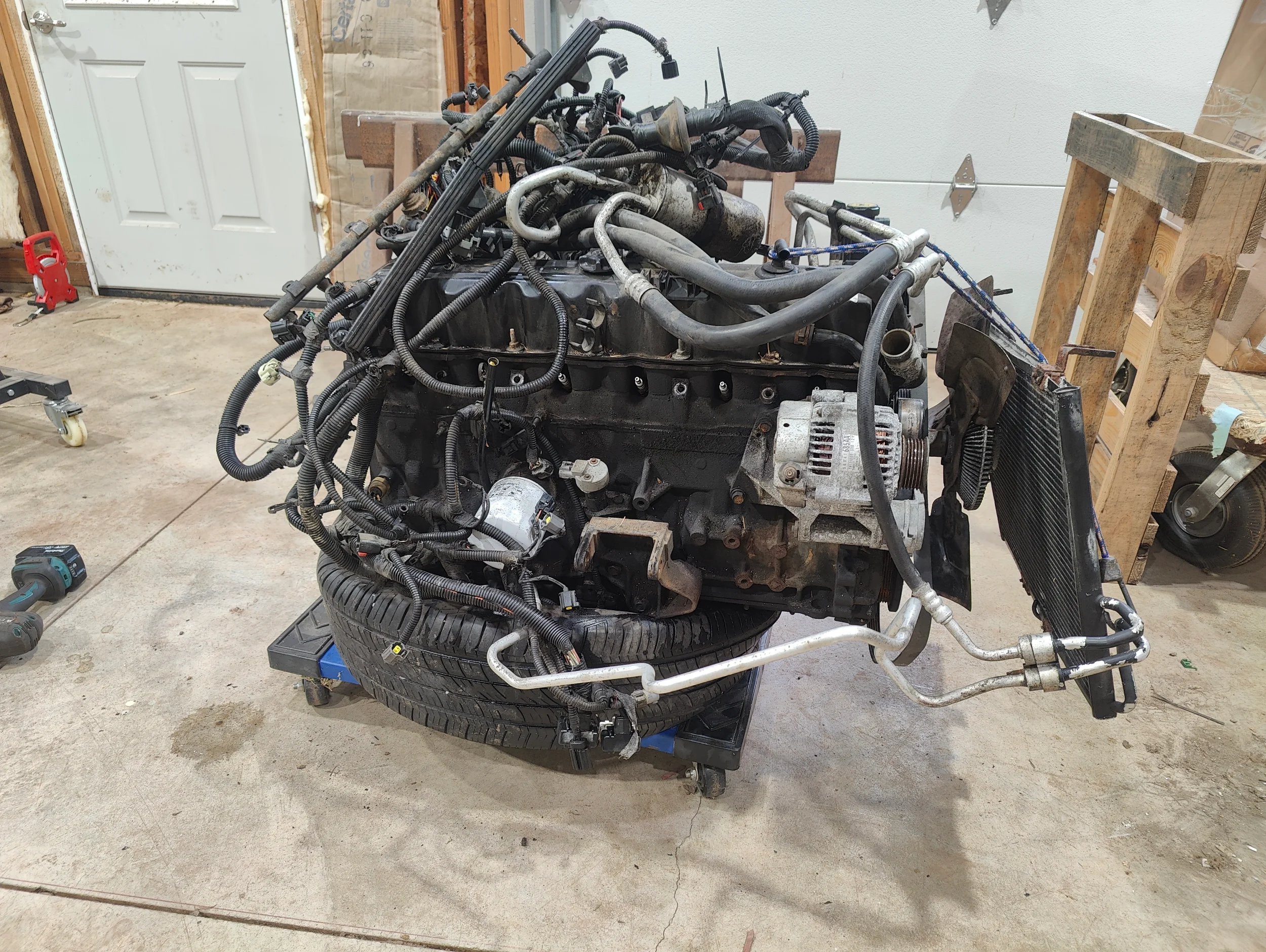

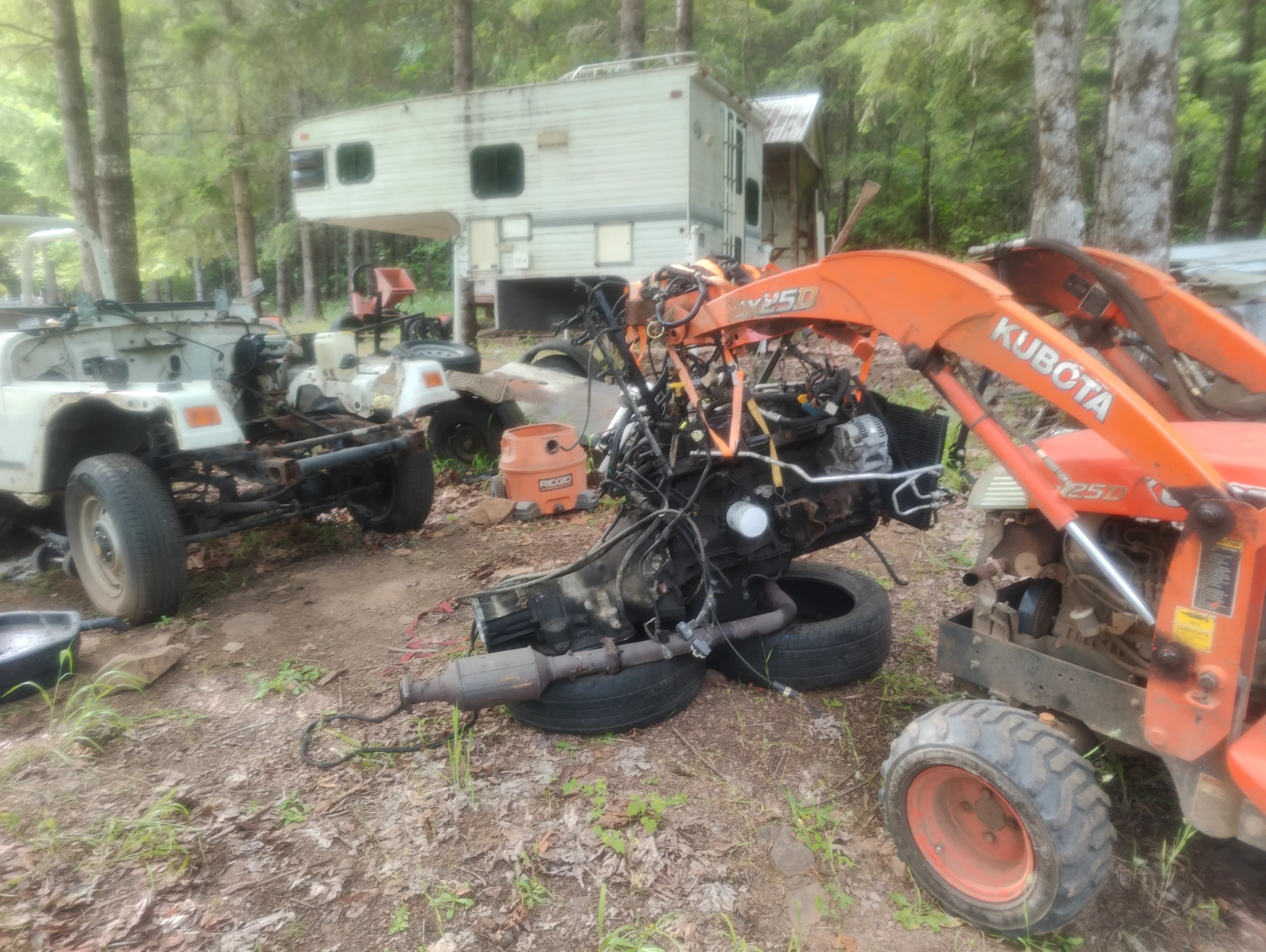

Made another stack for the engine. Couldn't get the condenser disconnected and the fuel injector plugs started breaking so I just left them on the rail. All ready for pickup.

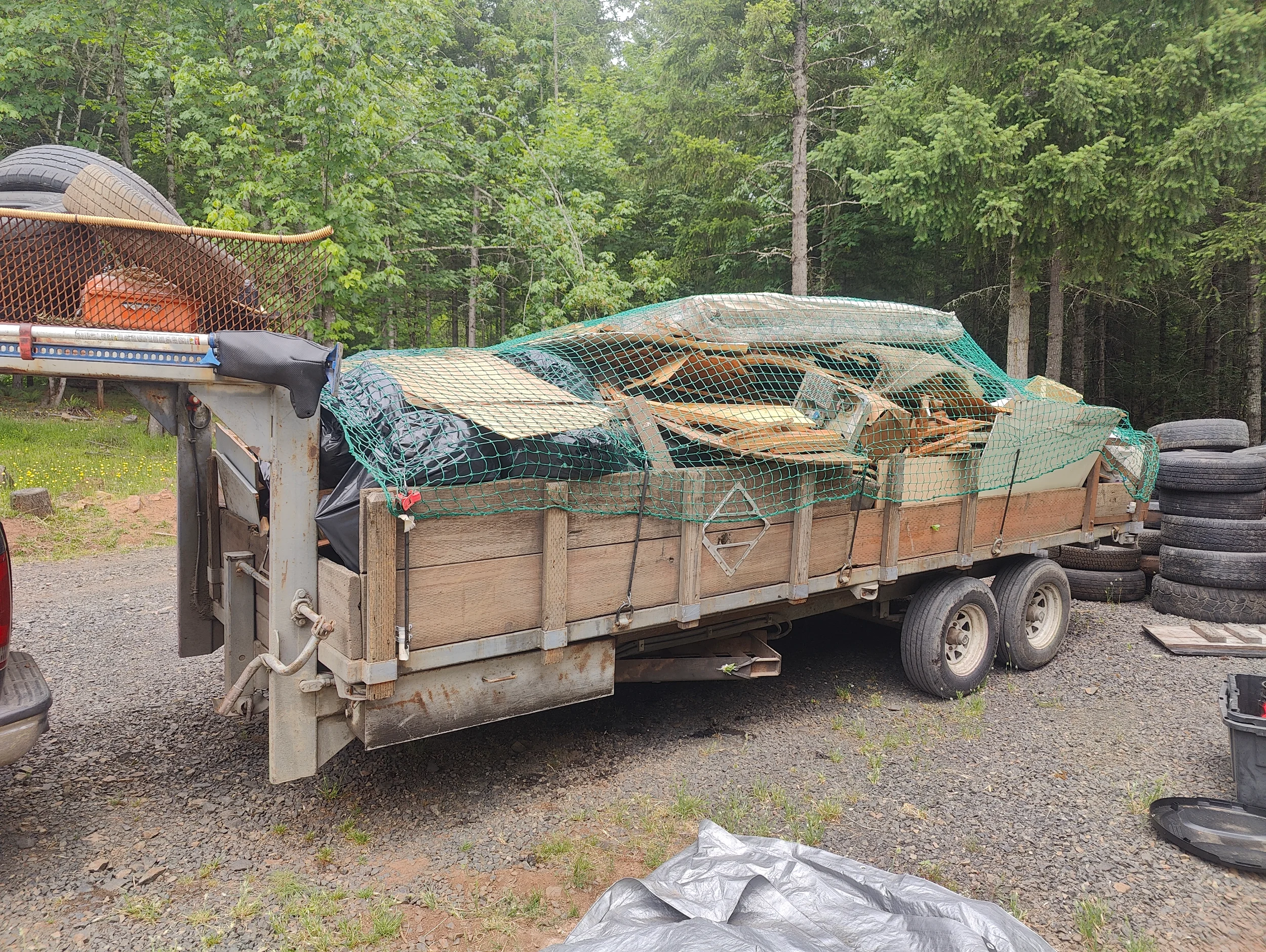

This was four hours of RV dismantling.
