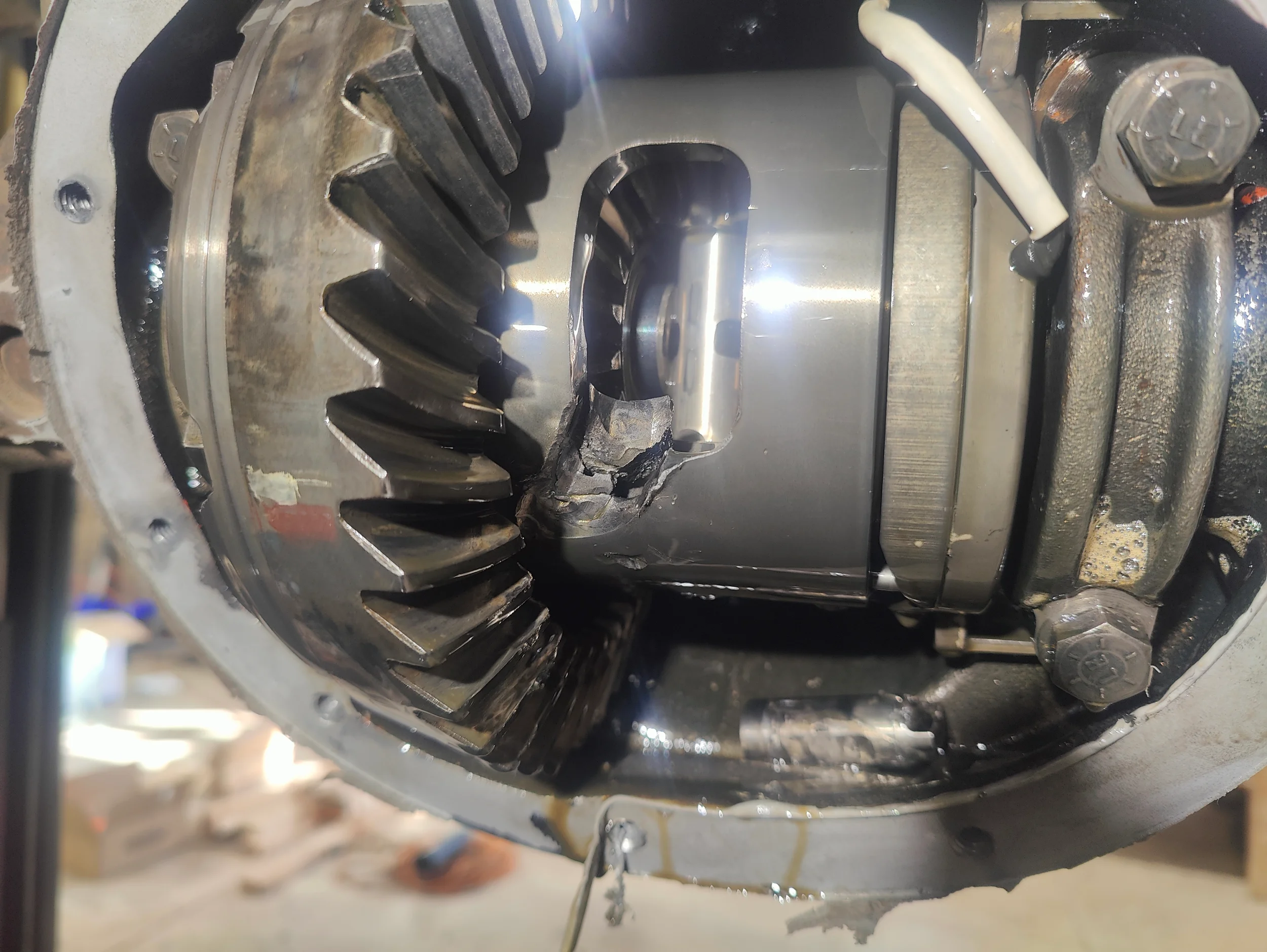

Ok...covered some of this on What did you do page...
Driving downtown Eugene headed home from a dental appointment I heard a large pow like the transmission jumping out of gear. Steering felt funny. Noises from what sounded like the front end. Looked that over. Rear wheels definitely locked...chirping going over corners.
Drove it 20 miles home. Drained the rear diff. First indication of a problem...
Popped the cover...
View attachment 711701View attachment 711702

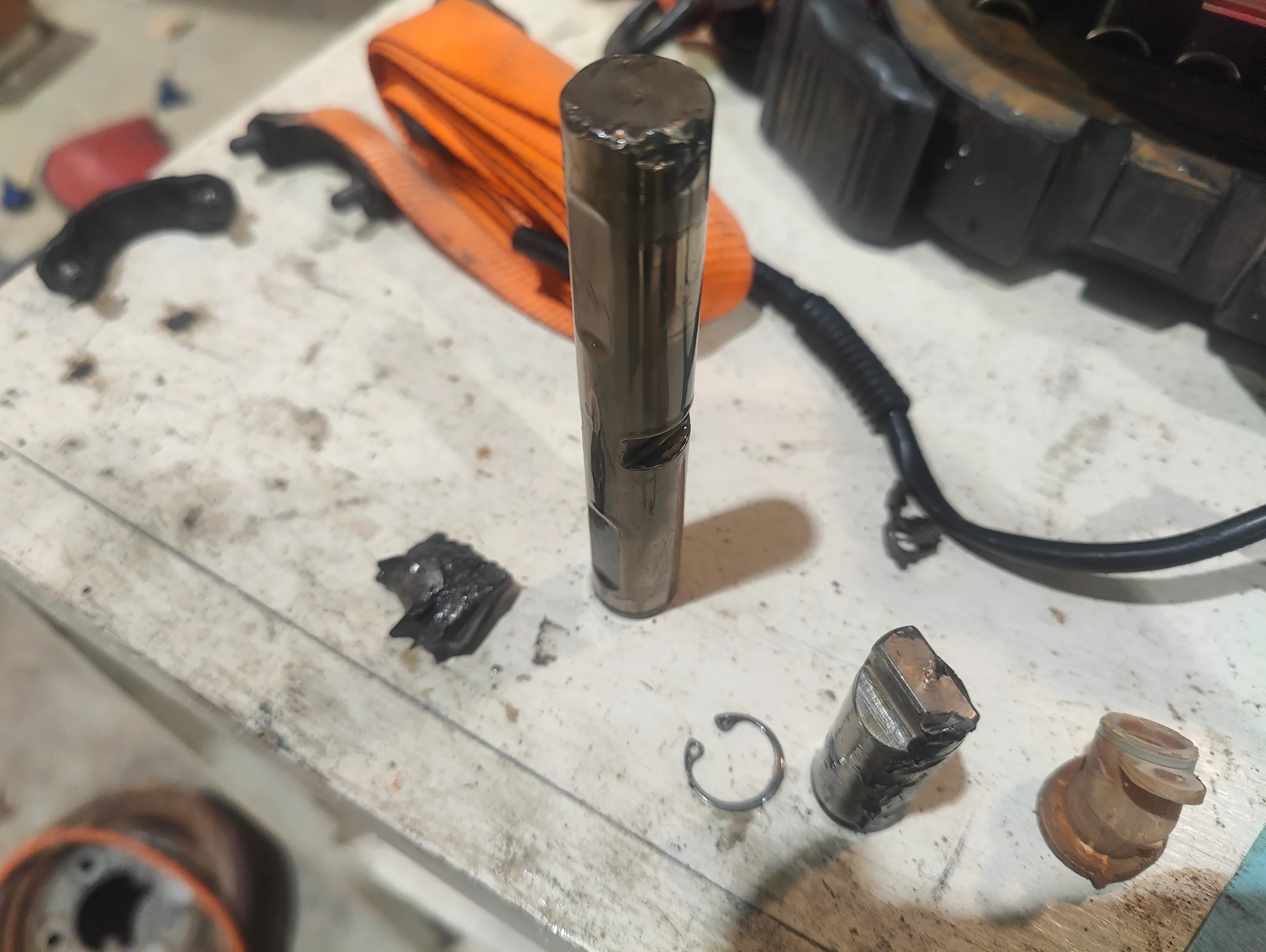

Appears that 767 miles after my outter pinion replacement the snap ring holding the retention pin fell out. Assuming that's on me for not seating it properly.
Elocker is toast. Pin got into the spiders.
Plan: ordered $2100 worth of parts. This will be my third rear E-locker. First one was set up by a shop in Roseburg and died a thousand miles in when the rear end grenaded on my way to Montana. Had my father in law take it to my favorite transmission shop and worst idea ever...have them replace the R & P while they fixed the transmission for the eighth time. They claimed the pin was stuck in the E-locker and cut it out with a torch. They sold me a new one. Their regear didn't last long...they didn't loctite or properly torque the ring bolts...so that's what I found 767 miles ago. I more or less ignored that issue for 5000 or so miles.
