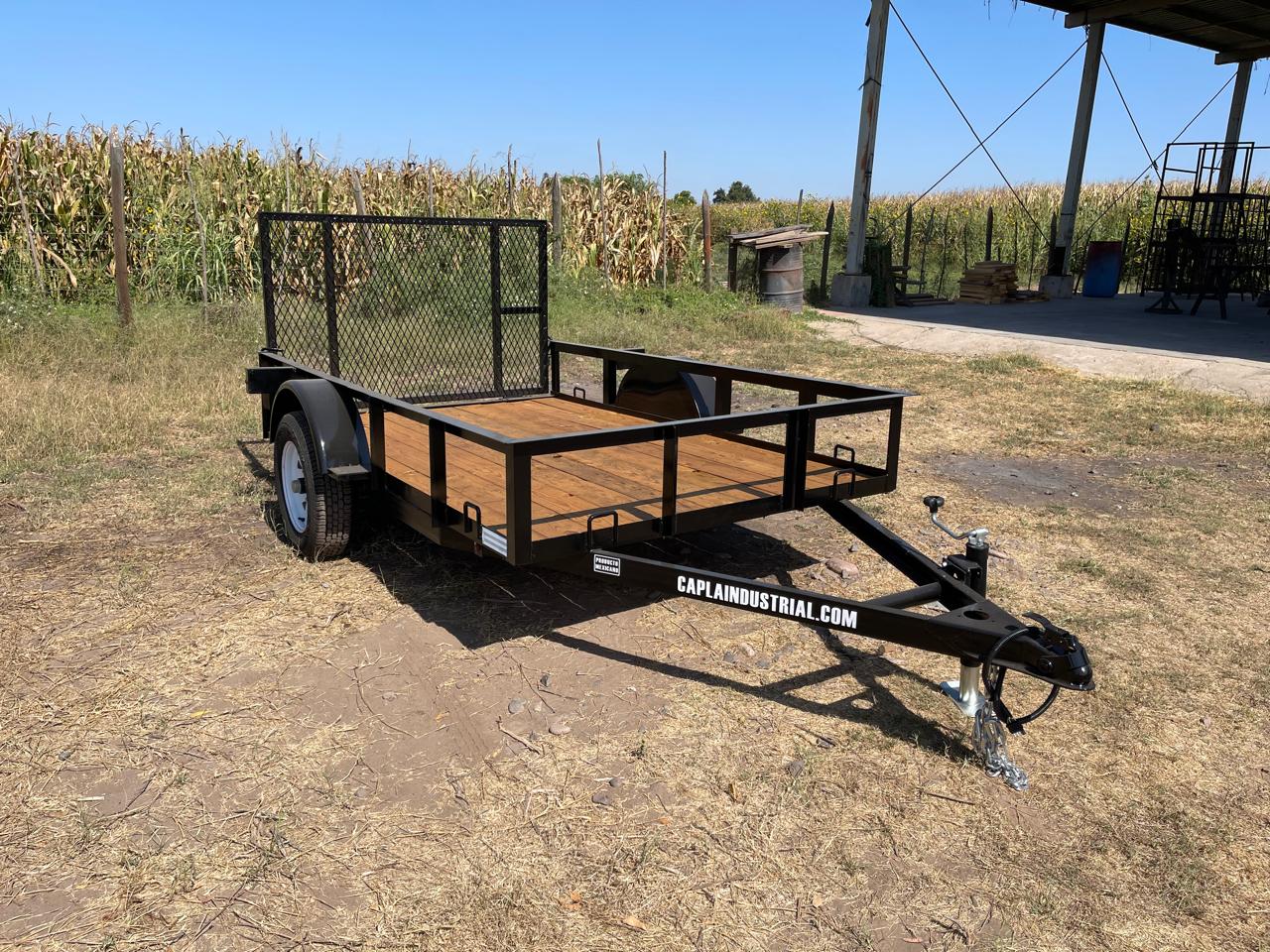

I recently posted about a cargo rack and the idea of a trailer was floated. I found a fabricator here in Mexico that makes custom trailers. They can make me one like this pictured below, but they would put a different axle on it so that it would fit larger tires, about the size of what I have on my Jeep, to keep the clearance.
The specs are as follows:
  • dimensions: 1.22 x 2.1 mts or 4' x 6.9'
  • dry weight: 250kg, or just about 550 lbs.
  • cargo weight: 1500kg rated, or over 3000 lbs.
  • equipped with 700 15 tires for heavy use
It would have a low tailgate instead of that big ramp. They'll put a drop axle on it to give me more clearance and beef up the springs to make it tougher and support the larger tires.
My main concern is the weight. I would never load it to its 3000 lb. limit, but starting at over 500 lbs empty, I am wondering how much cargo the 6 cyl motor and automatic tranny could handle. I gather that the towing limit for my configuration (4.0l 6cyl with 42RLE transmission) is about 2,000 lbs. Over 1,000 lbs gear plus the trailer would not reach that, but then I'm going up some pretty steep mountain roads at times.
Angle of departure is also a consideration. The basket on the trailer hitch lightly dragged in a couple of spots on the road crossing washouts, so that might be an issue with this one, as well. Angle of departure won't be anything near what the Jeep has. I know you cannot judge that without travelling the roads, though.
Maybe they could make it a bit shorter. Even shorten the tongue if that would be better for off-road driving.
Having the ability to carry in more supplies and gear, even dry goods to sell back in the villages would be great, but I don't want to spend $2,000 on a trailer then find that I can' use it.
The idea that once empty I could set up a tent on it might be a good point. My old lady would not mind being off the ground. She's weird like that.
Here's what it looks like, more-or-less. Tell me what you fellows with experience think. Might I be better off settling for a roof-top cargo rack, or could this work?

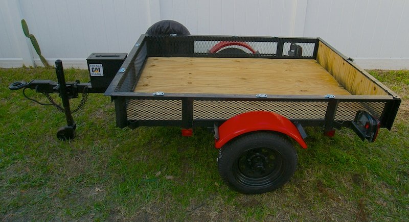

For reference, here's my 4x6 at 250 lbs empty, 2,000 lb GVWR:
I don't claim this is suitable for your situation in the slightest - I don't think it could take the pounding and it has 12 inch wheels on it. At the very least, I'd lose the thick wood planks on the bed and either use plywood or even expanded metal for the bottom to keep the weight down. Note the lunette ring - I don't really need it, but I think you do!
I had to move the axle to the bottom of the springs, it was too low even for street use before. BTW, never "flip" an axle, get new spring perches welded onto it and "lower" it.

Thanks! Helpful.
I like the idea of replacing the bottom with expanded metal or plywood. I'll ask the fabricator about that, or maybe I could just put the plywood in when I get it and use the boards for something else. Good wood is hard to find here.
He see seemed recalcitrant about the lunette ring, felt that the ball hitch would do fine, but if I push it I imagine can get him in line. Money talks.
These trailers are made for stuff like carrying ATVs and gear to camps and such, so I think they are built with rugged use in mind.
My main concern continues to be the towing weight, particularly given that I do some pretty hairy climbs. I feel like in 4low she can do pretty much anything, but need to be certain.

I think something closer to what @Zorba has would fit your needs better. The trailer you posted is more heavy duty, but like you said it weighs more, and you will notice more weight towing with a TJ. I have a cheapy 5x8 trailer with 13" rims I bought from Tractor Supply just to haul my mower around. Pulled it several times loaded with the TJ, probably close to the max towing capacity (2000lbs). Even that trailer doesn't weigh 500 lbs empty, I think it is in the 350-400 range.
My grandfather has a 6.5x8 trailer that was fabricated specifically for his 61" Scag Zero turn, because it is custom built, his trailer probably weighs twice empty what mine does.
