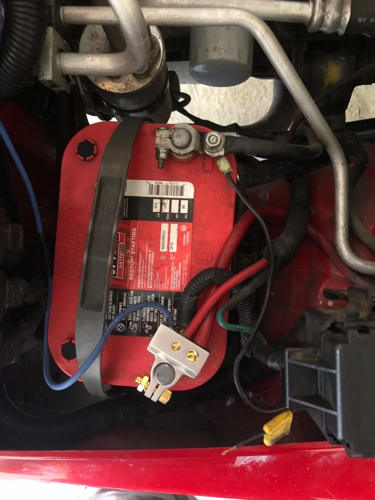

I passed the point of no return and had to get the positive on to move the car. The negative is even tighter and for some stupid reason my mind wants these to face out.
My intent was to clean the terminals up (both from grime and bad wiring from the previous owner, you can see the small black cable for the after market fog lamps, and my new blue wire there I still have to wrap up).
