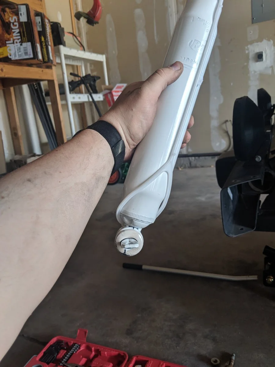

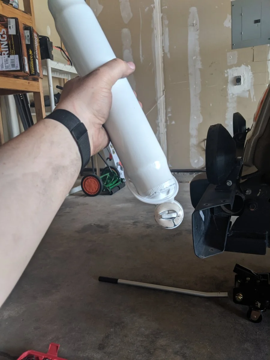

I stacked another spring isolator on top of the one I already had. They are about 3/4” thick.
