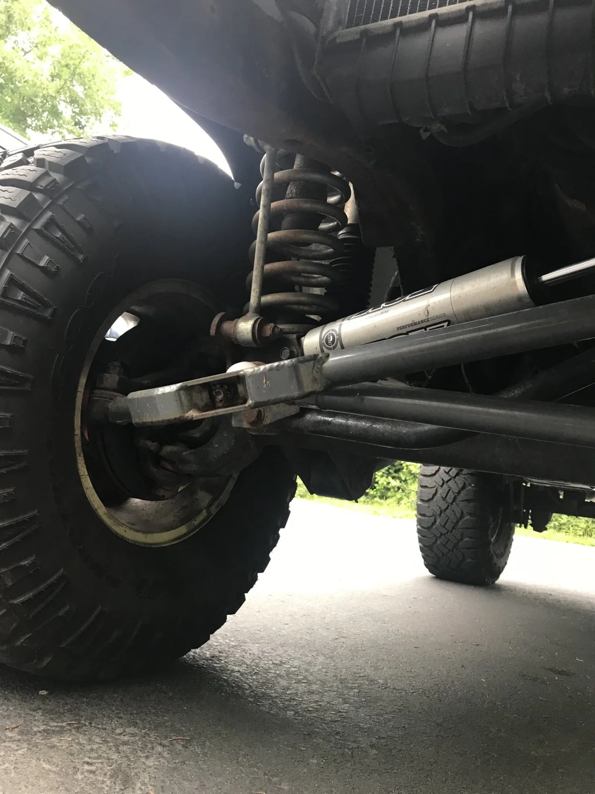

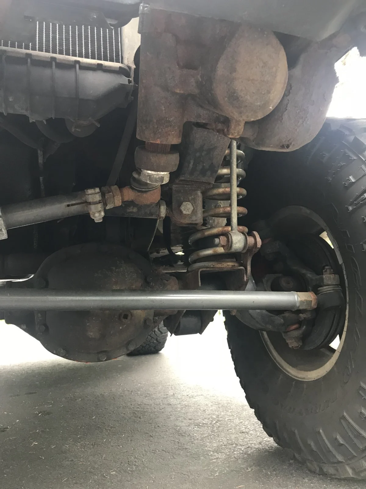

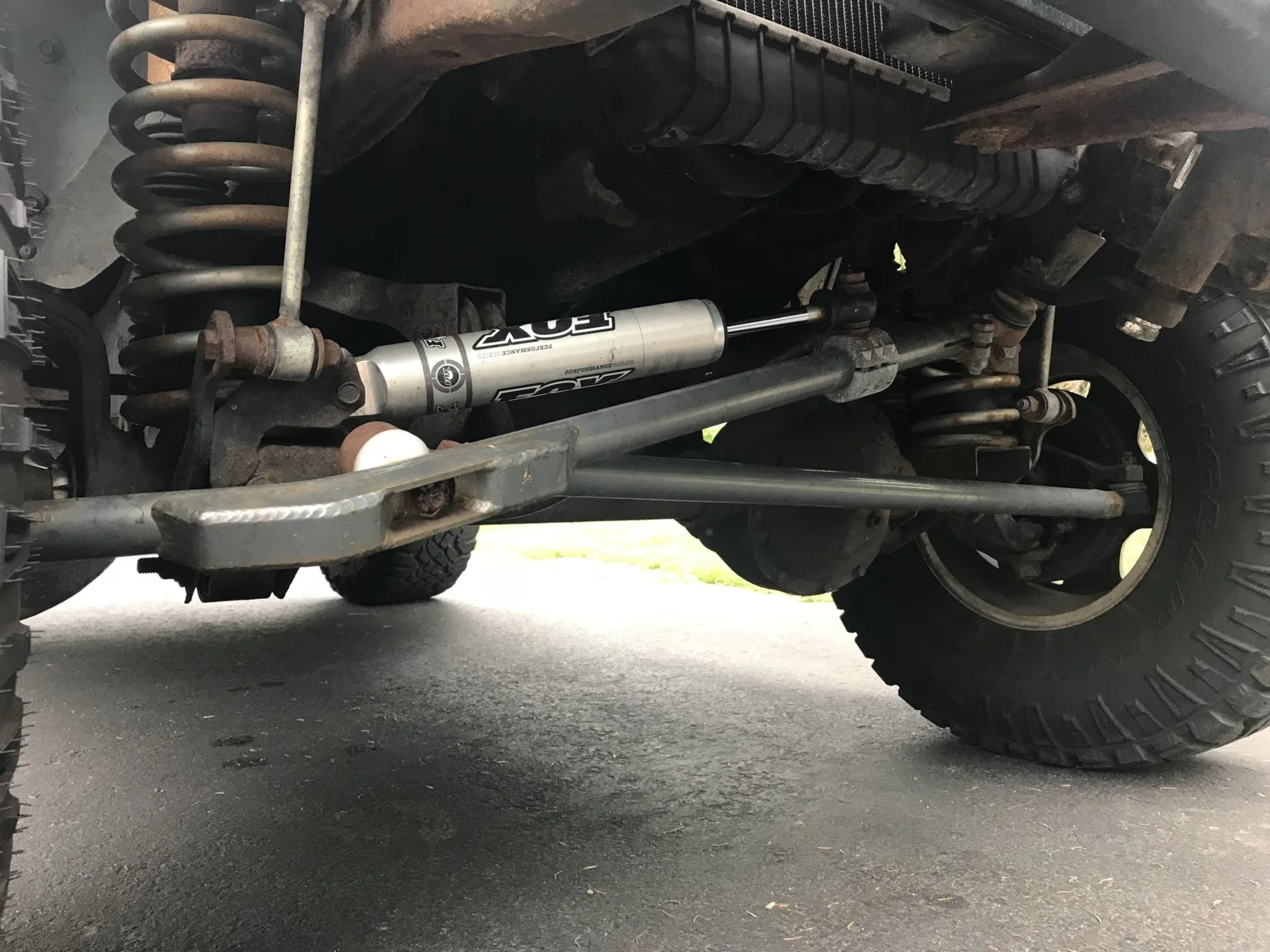

So here is my issue: I have rebuilt my entire front end(to my knowledge), yet I'm still having steering wheel issues. I have a 3.5in lift with 30s, a PSC performance steering box, cross control arms, steering stabilizer..etc the only thing I have yet to replace is the upper control arms, however as far as I'm concerned wouldn't fix the pull I get from stopping quickly(from higher speeds(50 or so) down to a brake happy driver in front of me. I constantly having to catch where the steering wheel has play and drive from there. Any suggestions as to what it could be? Would replacing the Power steering pump be the fix I'm looking for?
Here are pics for reference:

It looks like you have some custom steering linkage.
