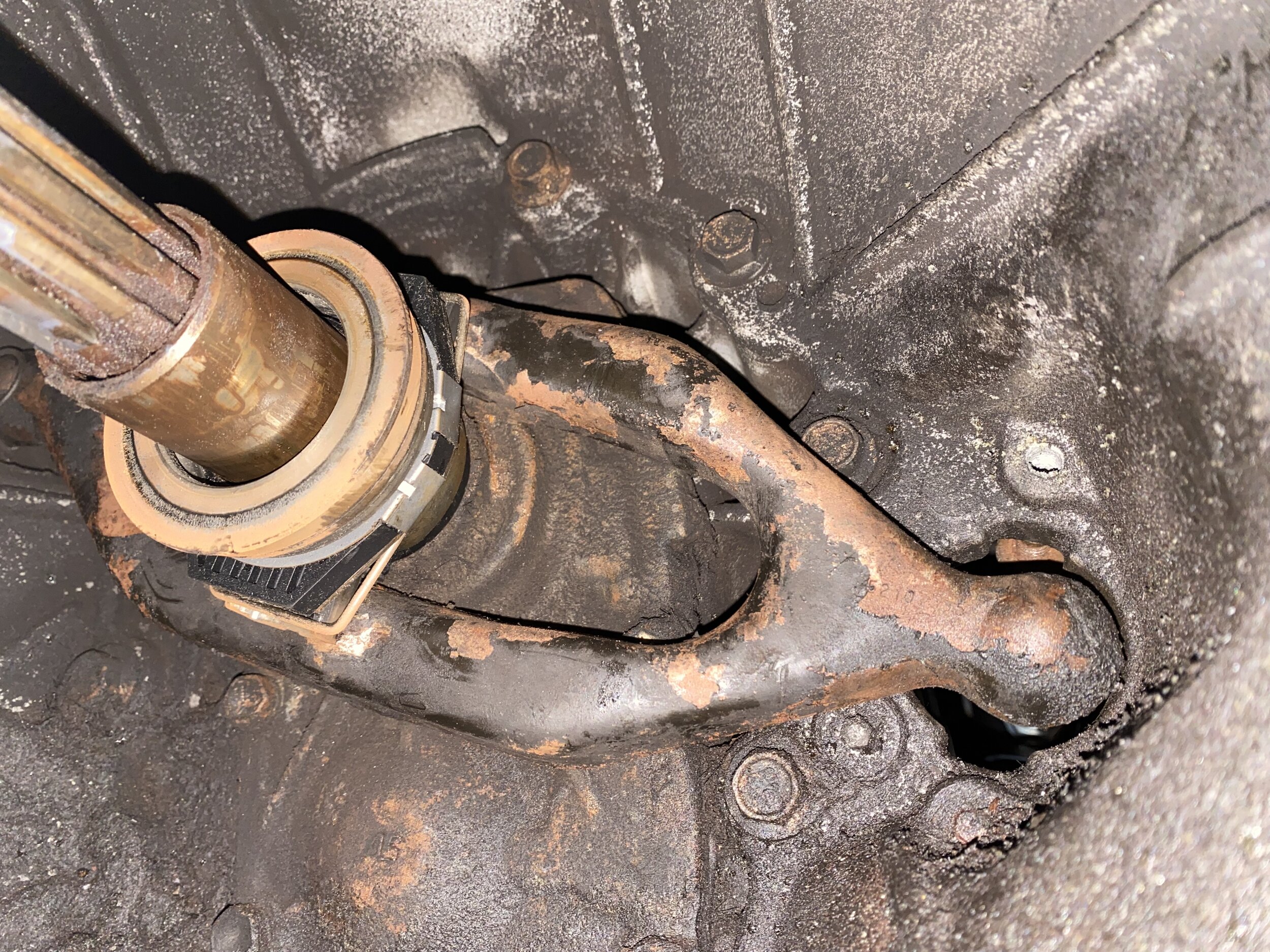

I took the slave cylinder back out again and the clutch fork has a ton of play up and down. I'm not sure what happened to cause that, but it looks like the transmission is coming out. Mother f******. I did all of this while the engine was out of the frame to make it easier, and here I am dropping it in the damn garage now!

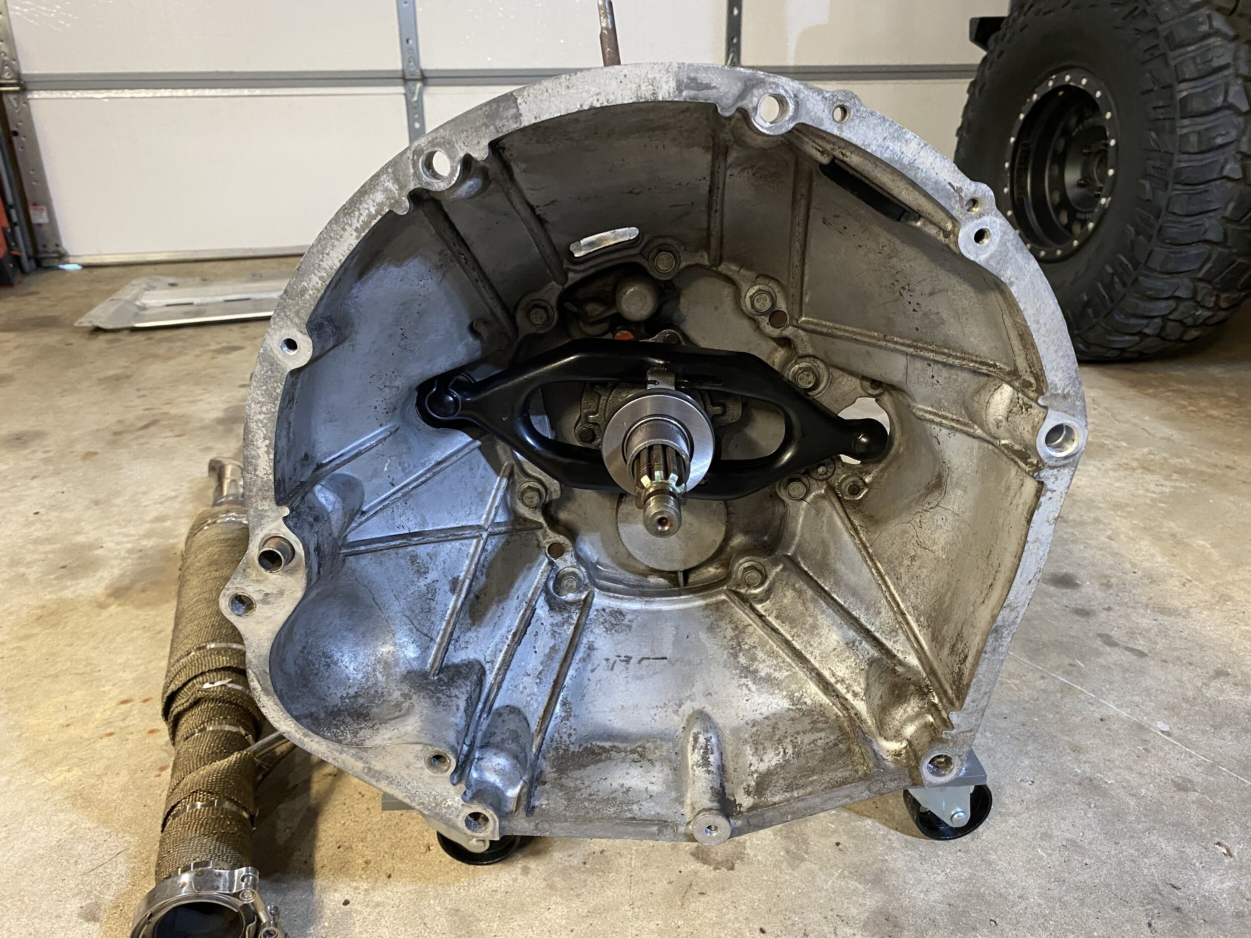

Well this is frustrating. All the work to drop the transmission and I don’t see anything wrong. Clip is still on the end of the fork. Throw out bearing didn’t break. Does anyone see anything I’m missing?
Wow that's a lot of rust on those splines.
I'd clean everything up just to see if it helps.
I'm not sure if you have grease on the ball pivot or TOB.
How does that TOB feel?

I agree with MAC….
Since you have access to the throw out bearing, fork and transmission input shaft splines and sleeve; spend some time and clean up inside the bell housing, the throw out bearing fork and transmission input shaft splines and sleeve. Test spin the TOB feeling for roughness and manually operate the TOB fork and test its operation prior to assembly.
When you ordered the clutch and pressure plate; you did ensure you received the proper parts ?
There was a member recently that installed a clutch assembly and discovered the wrong parts were installed which caused his problems.

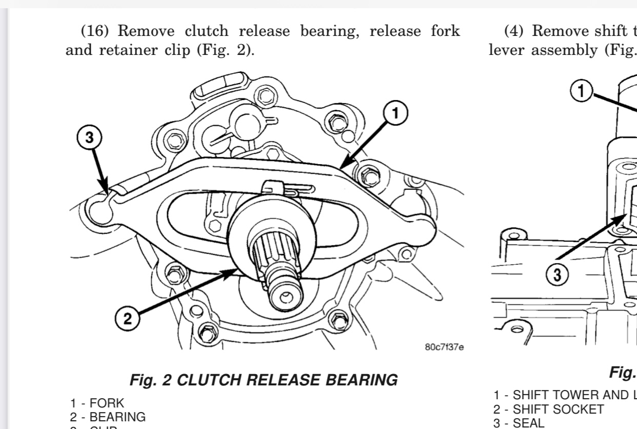

Your clutch fork is also backwards, the spring slots should be on the right side of fork when looking at it. This might cause the fork and or throw out bearing to not pivot correctly.
Edited to clarify, the clutch fork should spin 180 degrees for it to be installed correctly

This ended up being the slave cylinder. The pop I felt after pushing it the first time and then the lack of resistance ended up being the "cup" (for lack of better terminology) that pushes the pin into the shift fork slid back into the master cylinder a ways, and the pin was no longer pushing out when the clutch pedal was pressed. Even after bleeding it for a while, it barely built up any pressure. Eventually that cup popped back up into place and I could feel the pin start to push out a bit when the clutch was pressed. I mounted it back to the transmission again, but after pushing the pedal it collapsed again inside the slave cylinder. Put another new one on and it worked perfectly. Now I can drive the Jeep and everything shifts as it is supposed to.
So this comment isn't correct, or does it work in spite of this comment? Asking for future readers.
Here is a pic of the FSM showing the correct orientation. Also I just went through this same process last week. Taking it apart the spring slots were on the right side looking at it.
Can it work both ways? It might, but my guess is it could cause the springs to fail sooner or maybe cause the throw out bearing to dig into the input retainer more?
