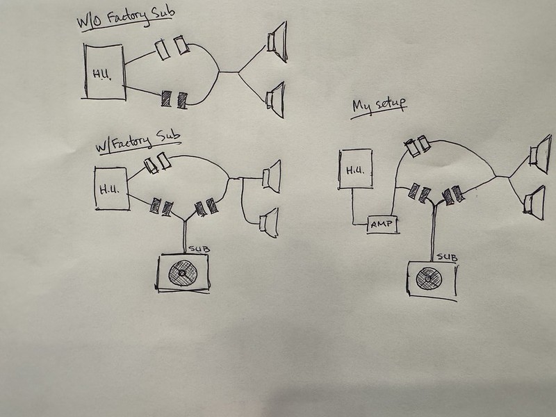

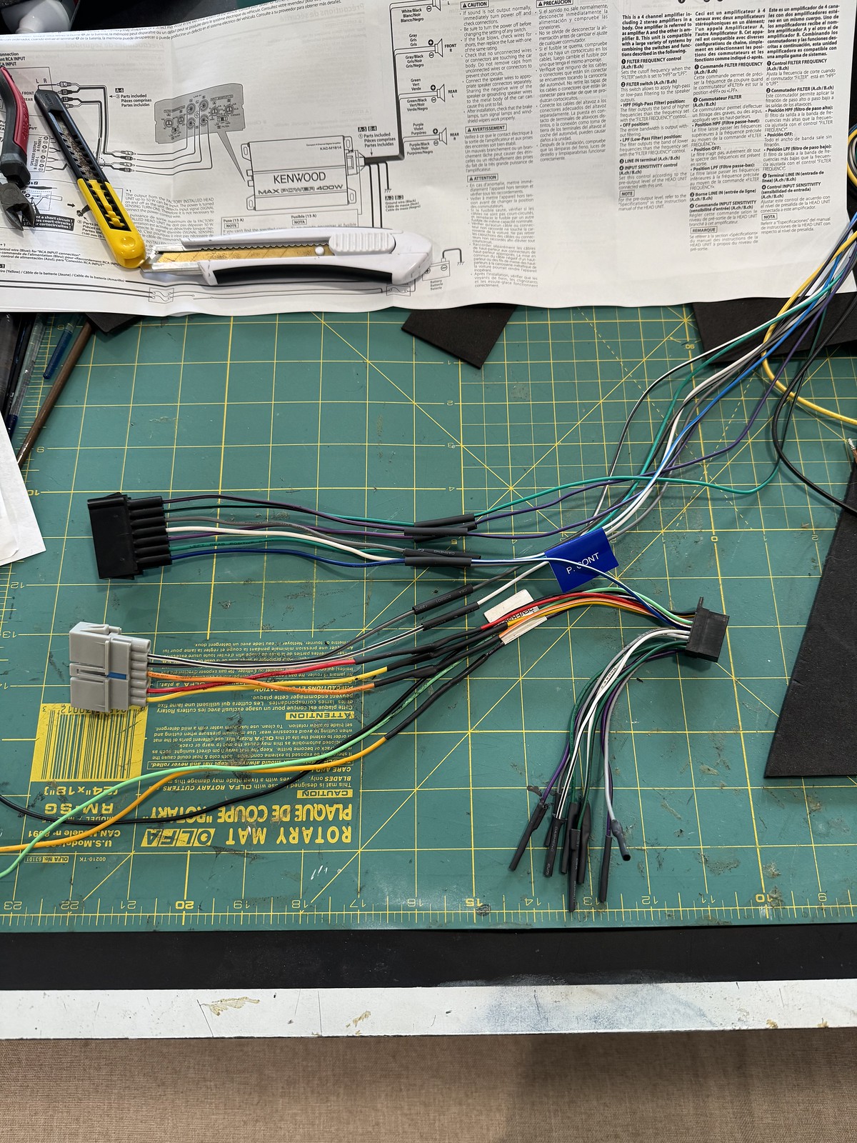

I've tried searching but couldn't find exactly what I'm looking for. I'm in the process of installing a small 4-ch amp in our TJ that has the factory Mopar subwoofer and a Sony AX1000 double-din head unit. Is it OK to splice the amp in *before* the factory subwoofer? This is an amp for the regular speakers in the dash/speaker bar, NOT an amp for a subwoofer.
I know the speaker wiring goes from the head unit to the subwoofer and then back to the main harness before going out to the speakers. I don't want to cut/splice into the factory harness so I was just going to run the amp outputs to the Metra harness between Sony head unit and the factory harness (see photo below) but wasn't sure if this would cause any issues since it's all going through the factory subwoofer before going out to the speakers.
Have you checked out the wiring diagram? If memory serves, the feed for the sub in the stock configuration comes off of the left and right channel wiring, and then hits the sub amp in the console. I don't believe the sub feed comes out of the head unit in the stock wiring.
yeah, I may have done a poor job explaining it. The factory sub wiring harness sits between the black female plug on the head unit harness and the black male plug on the vehicle harness. So the speaker wires/signals go: head unit -> subwoofer harness -> speakers. It's taking the left/right channel signals but it's doing so before the speakers, if that makes sense. Or maybe it just piggy backs off the signal, I'm not sure what the wires themselves look like in the subwoofer harness. I just know it plugs in in-between the head unit and the factory harness going to the speakers.
I don't think the subwoofer modifies the signals any, and its amp only runs the sub itself, I just wasn't sure if I was going to lose any power to the speakers by running the new amp before it goes through the subwoofer or not, of if I would damage the factory subwoofer by running higher wattage line inputs to it.

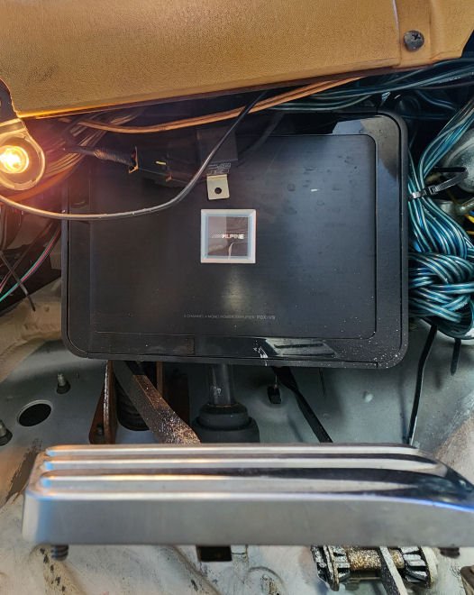

My Alpine PDX-v9 is under the dash. It is way up there around the steering column. There is a special mounting kit for it, and its only about $60 dollars. But, your 400 watt amp is likely going to be too powerful for regular stock speakers. They are probably about 25-30 watts RMS, and less for the front 4x6 speaker. Your amp is 100 watts per speaker. I wouldn't even settle for 100RMS speakers because distortion is what blows the speakers. But, you may get away with 100RMS speakers if you are careful. Regular stock speakers won't work at all.
I also tried the cheap route, and it didn't work. Those amps get really hot really fast, and they shut off. I spent like $400-500 for a five channel amp and the specs were good, but it kept overheating. My Alpine never shuts off or overheats. Of course they all need space. I wouldn't try to mount any amp under your seat.

To answer the original question, you will need to measure the resistance of the speakers that the amplifier sees with the factory sub in line with the rear speakers. If the resistance is in the range of what your amp is rated for, then no harm. Most 4 channel amps are looking for 4 ohms per channel.

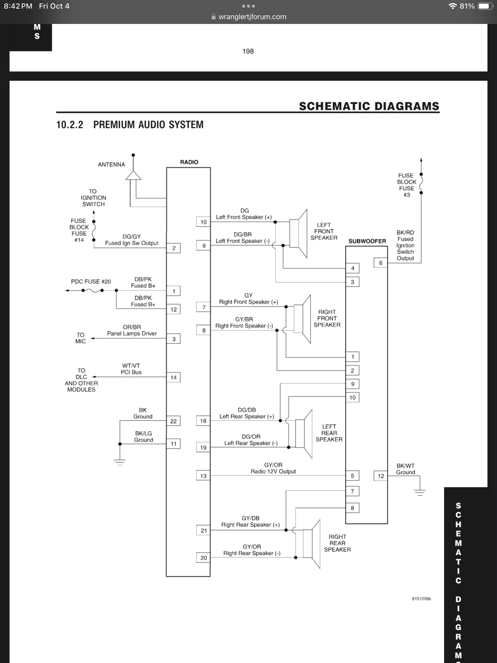

Maybe they are wired different through the years. Not understanding how you wire in a 4 channel and run that amplification through a factory amp. I am wondering if you would not burn out the factory amp. 05 schematic below
Yeah, the wiring harness for the stereo and subwoofer changed in 2003. Our TJ is a 2000, but I installed a 2001 subwoofer center console in it back in 2002. It's got a 6pin connector at the subwoofer and and a flat 7-pin connector that plugs in in-between the black plug from the head unit and the back plug in the factory harness. '02 and older TJs have a 2-plug harness (see my original photo) from the radio, vs '03+ that have a single plug.
Based on the pin outs of the plugs on both the early and late model subwoofers, and the schematic you posted, the signals have to be splitting off the main harness, like inline taps, vs going into the sub and then back out to the speakers. Other than running higher wattage inputs than the factory amp may be expecting, I think things should be fine with having the amp before the subwoofer harness.
