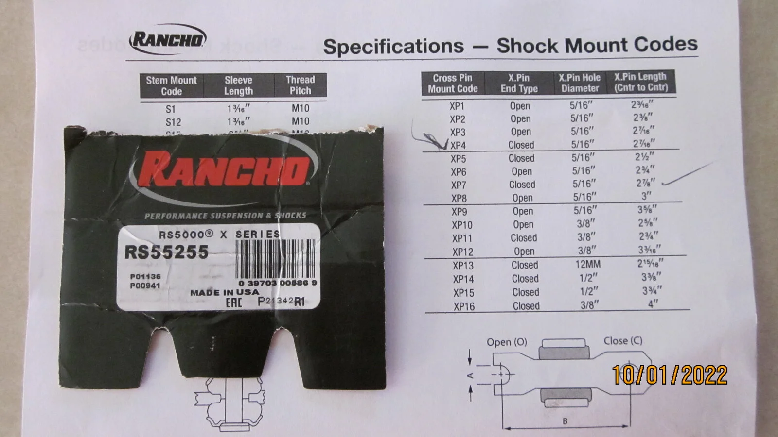

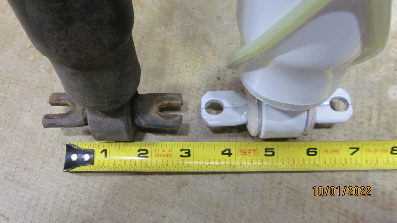

Bought a set of new Rancho RS 5000x shocks from a guy that bought them from 4WP. Front RS55255 and rear RS55256. Got the fronts out yesterday to put on the Jeep and the bottom mount holes were too far apart. They should have been XP4 (2 7/16) but are XP7 (2 7/8), clearly someone at Rancho put the wrong ones on (see chart).

Use a vise to press out the bar pin and press in a replacement, any shop that sells shocks will have them. Or move the old bar pin over to the new shocks.

have done that before, not the best, possible to tear up the bushing ?? Thanks long time ago.
I had the same issue. I swapped the bar pins and put hourglass shaped bushings in mine. Much easier to replace.

Can do, push or grind. Just don't think it is right that Rancho made a mistake and will not make it right. They could have even suggested to send the right mount and have me push it out and put right one in. Poor customer service/quality control. Well non existent, really.

Just pressed out the old pins, it was a pain. Think I will drill the new ones, Not sure about pressing new out and pressing old in.

I wouldn't hesitate to just swap the pins out if it was me. But that doesn't solve your length problem unless you want to bump your lift up to 4"+.
