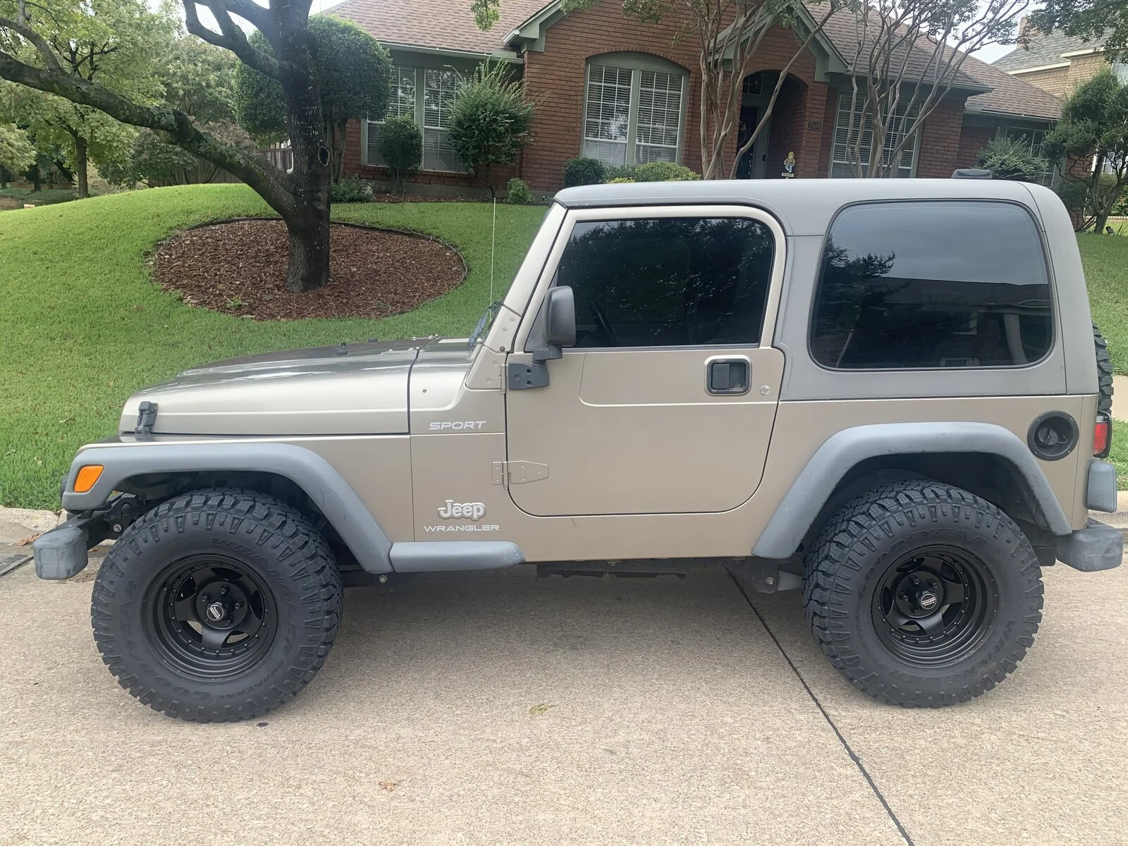

Newbie....... Here's my '04. 31" Duratracs & AR23 wheels just put on. All stock. I'm going to do a 2" OME/Rancho5000x and am following closely what y'all are saying about the 0"-2" vs 2"-3" shocks. BTW, I just scored this Jeep about a month ago. All stock, 55k miles, one owner. I feel very fortunate to have found it. 4.0L, Dyna 44, A/C, 3.73,
