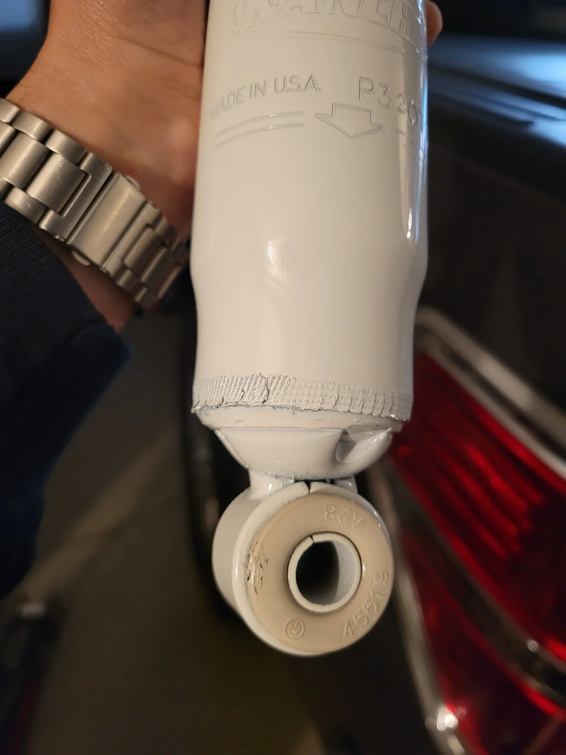

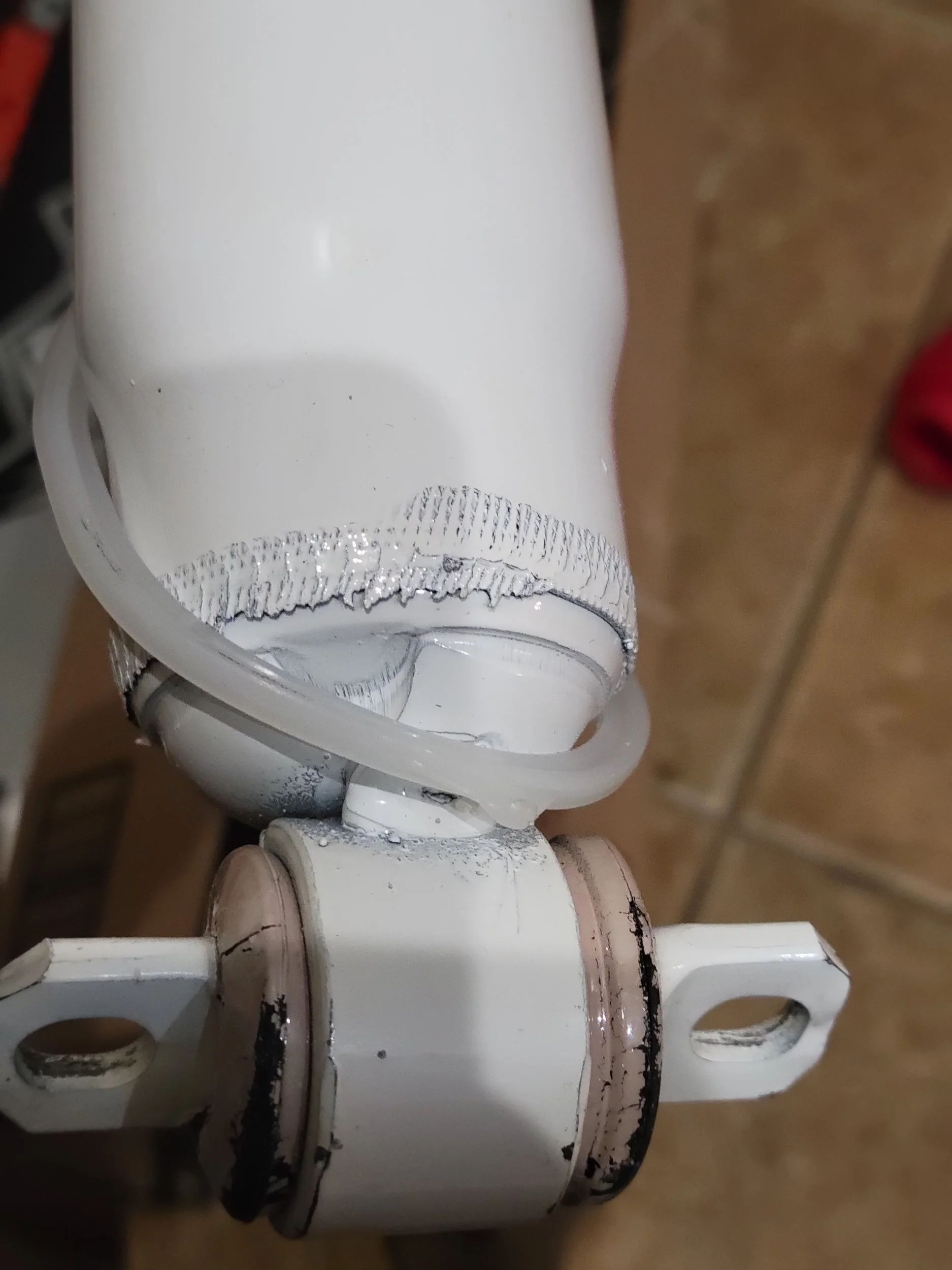

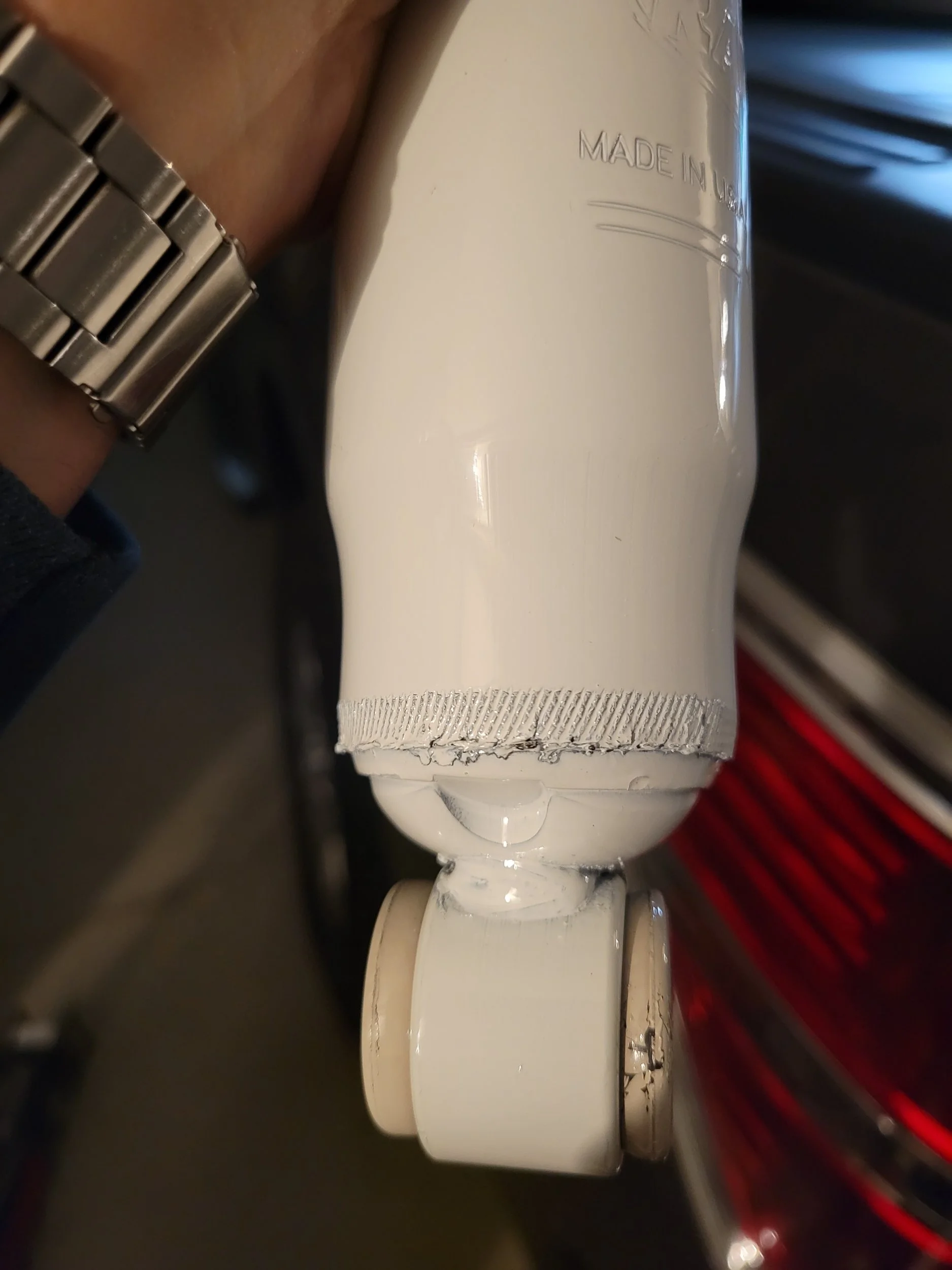

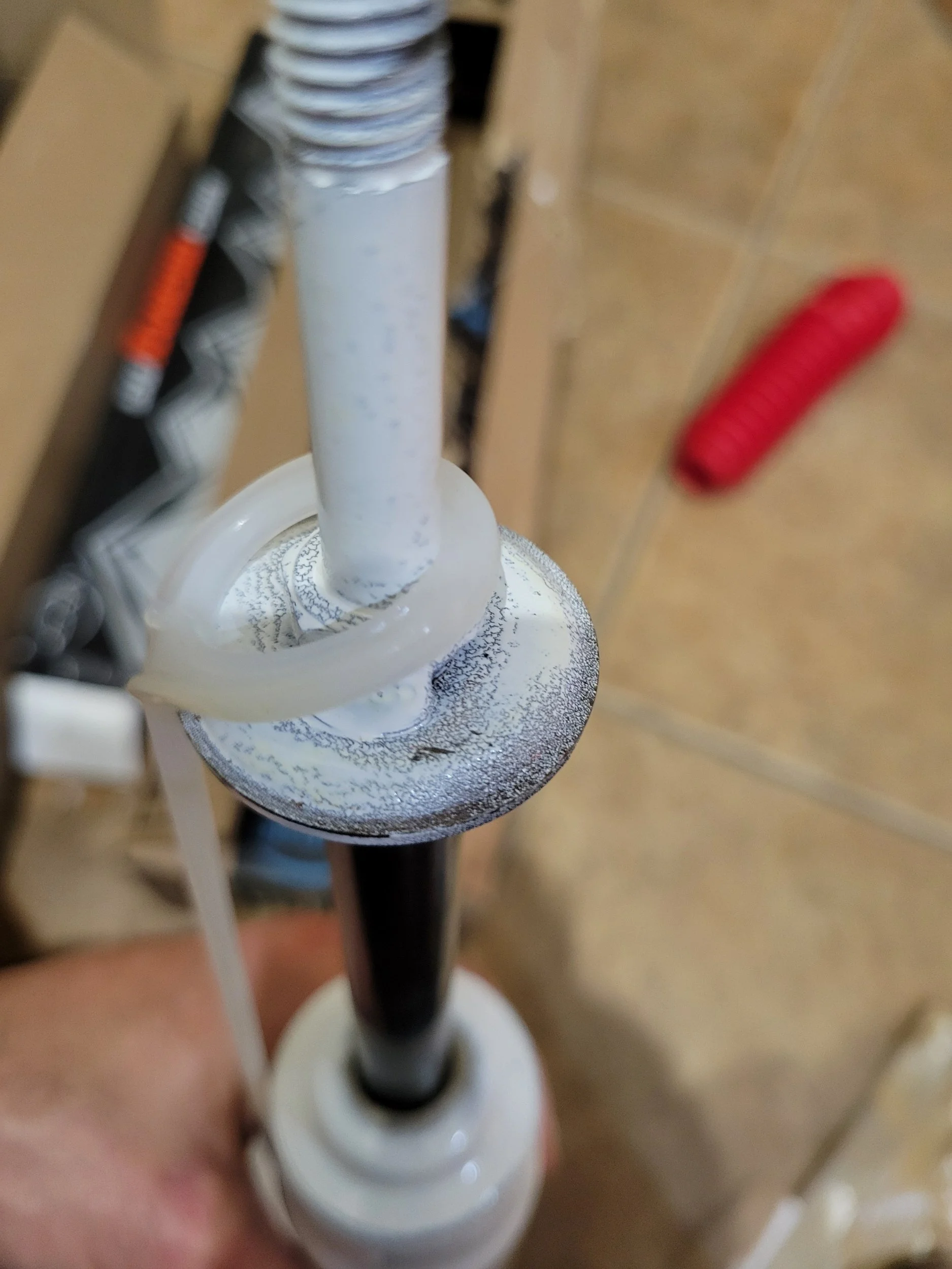

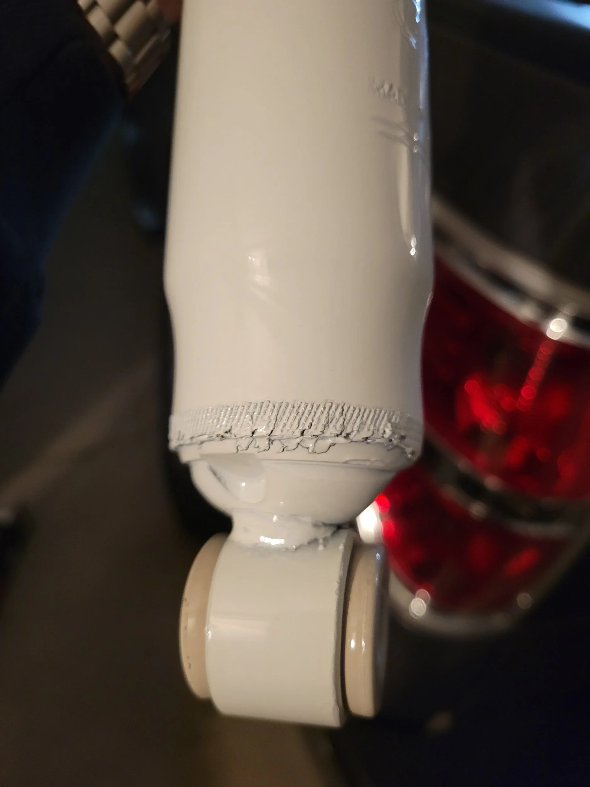

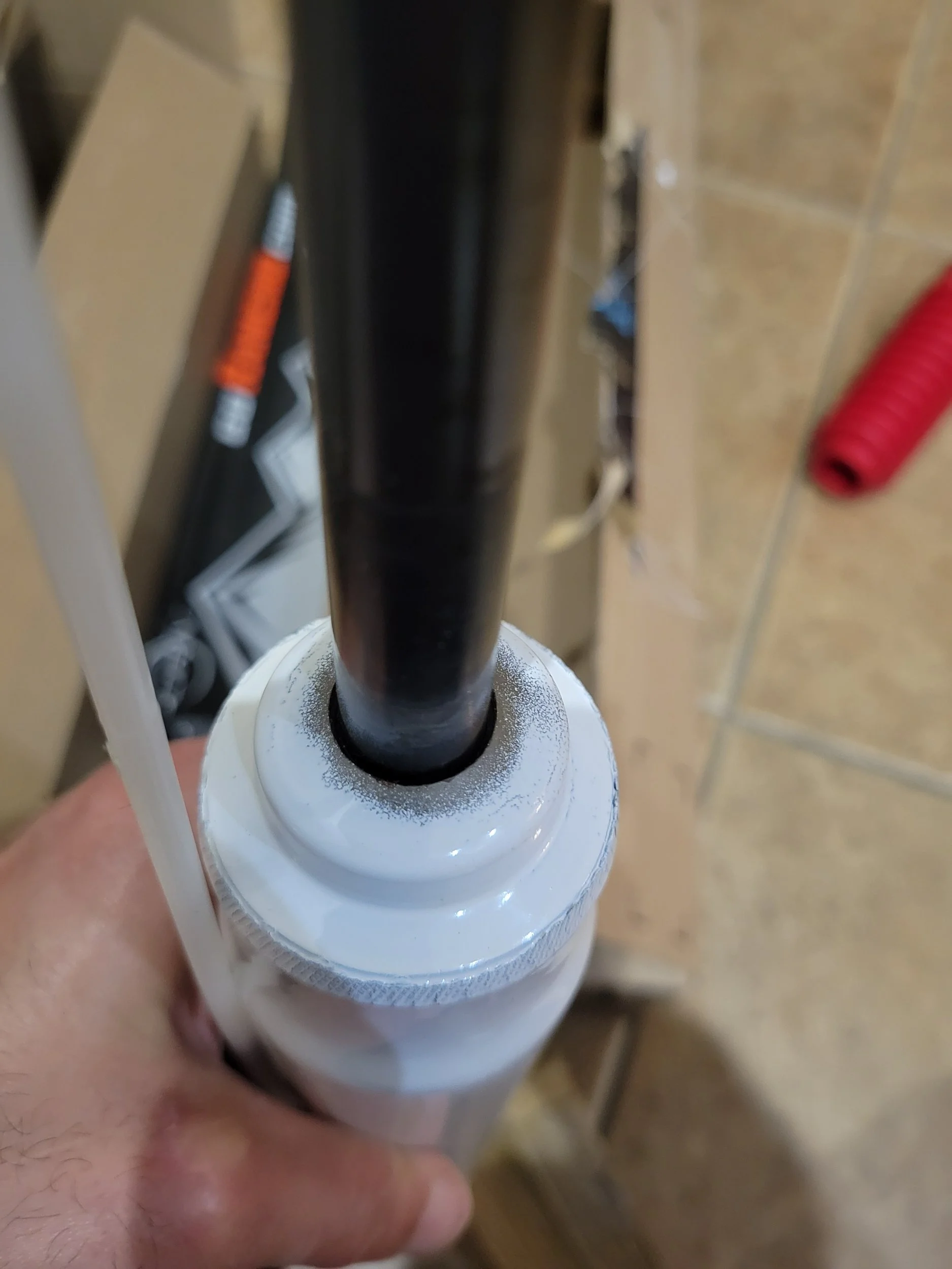

Although I saw many negative posts about the quality of the Rancho shocks, I took the advice on this post and ordered them anyway. I will confirm, the negative posts have some truth. The weld/crimp on the tube of all 4 were extremely rough and crooked and the paint job is a joke. One of the shocks bad to the point it looked like it was used. Most likely, it was a returned item given that Rancho put a yellow sticker on its box that says "new stock." The rear ones didn't even have a tie keeping it compressed during shipping. It's just very disappointing and frustrating that you go out of your way to buy American made products only to see their mediocre quality. Some would say it's just cosmetic but if Rancho thinks the shoddy cosmetic stuff is acceptable, I don't have much confidence that their ride/build quality is any better. I am going to install them to test them out anyway. I hope I don't regret not getting KYBs that I've had in 2 of my trucks.

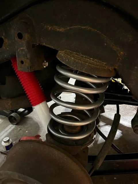

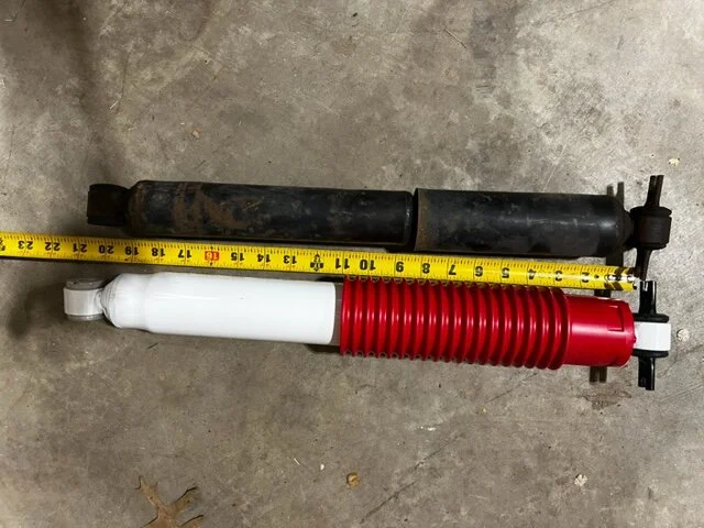

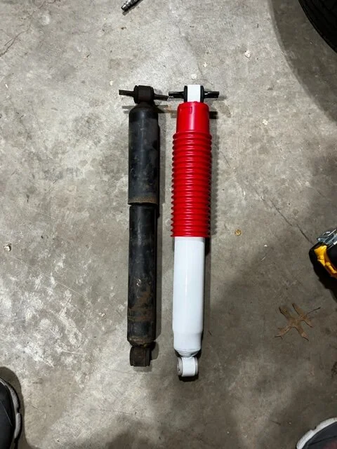

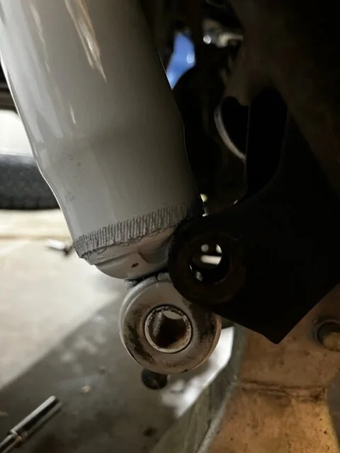

I have been following the recipe that was listed out for a 2.5" lift. Using the Rough Country Springs instead of the Pro Comp since they were not available. The RC springs are the 653 Spring Kit that list a 2.5" lift. I have replaced the springs on the rear and then started to add the Rancho shocks. I know that the suspension has not been driven on or cycled and that the Jeep is still nose down since I haven't started on the front lift yet. However, it appears that the shocks might be too short? Using the Rancho RS55240 for the rear shocks 0-2 inch lift.
The weight of the Jeep is on the jack stands and the jack is not lifting up on the rear of the Jeep at this time. It is a soft top so lighter than a hard top. The Ranchos are slightly longer than the originals that I pulled off. The picture that shows the shock and lower mount: the shock is free and not binding or braced against the lower mount, it's just sitting there for reference.
