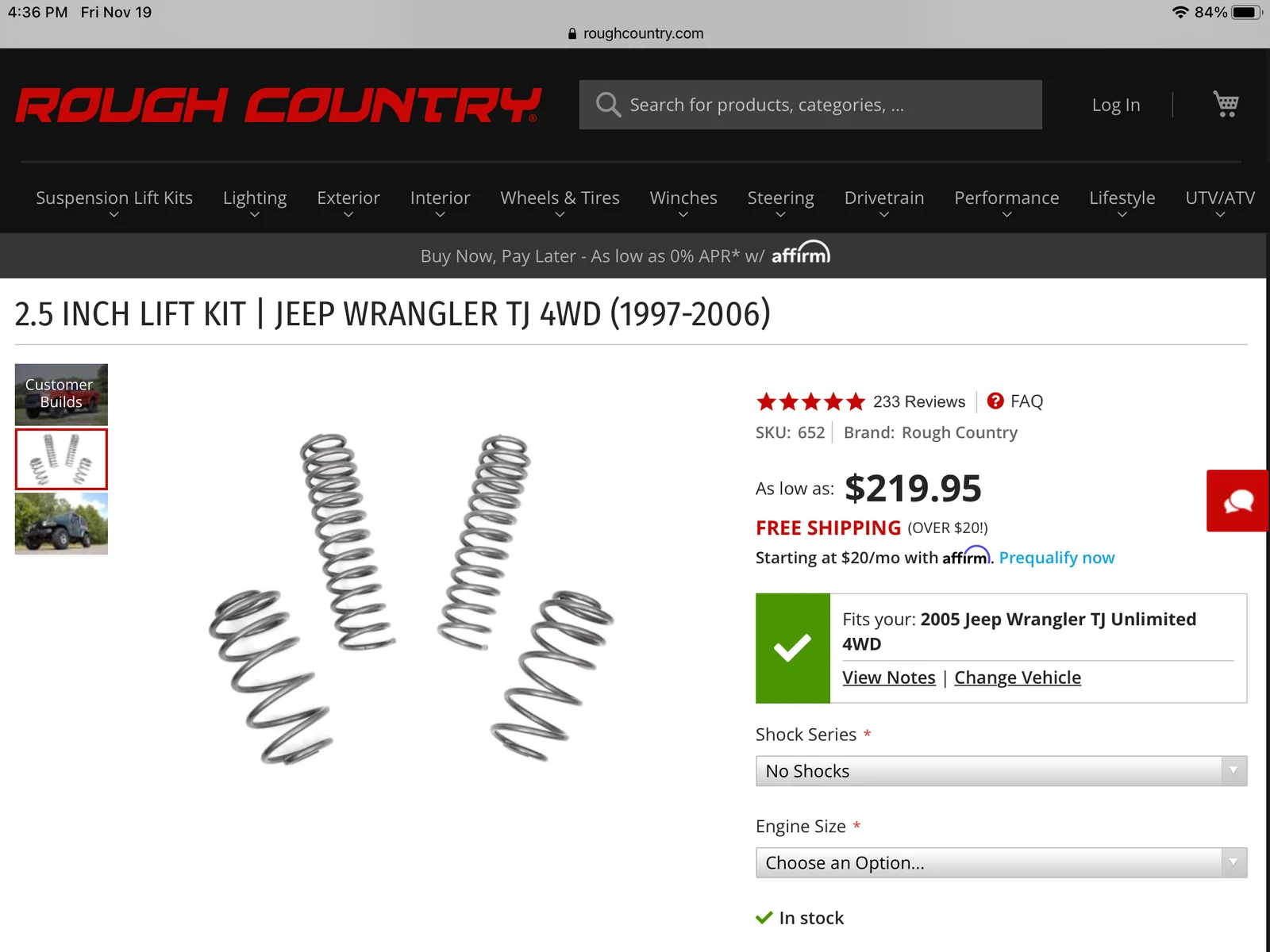

So the Pro Comp springs that @CodaMan suggests with this “kit” have been discontinued. (The front ones anyway). So in searching for something else, I came across these from Rough Country. They advertise them as 2.5” lift.
Since my Unlimited is a bit heavier than a standard TJ, (and I’ve got aftermarket bumpers, & will be adding a winch, etc) could I implement the method described in this thread without concerns about the springs being 2.5” instead of the 2”? I feel like it’s possibly only going up 2” with the RC springs. Anyone have them? Thoughts?

I had a quick look at the springs and shocks resource thread, if the info on the RC front spring included there relates to the spring in this kit I would be wary of using that.
The RC 2.5" front spring is shown as having a free length of 21.00", that is really long for a spring giving a quoted 2.5" lift. By comparison the ProComp EXP55297 has a length of only 17.87". To get to a 2.5" lift that means the RC spring has a really low spring rate. There is no spring rate quoted for the RC, but the ProComp mentioned above has a quoted spring rate of 170lb per inch and as the RC spring needs to compress almost twice as much as the ProComp to yield a 2.5" lift it suggests a spring rate of sub 100lb. That means even a little extra weight is going to result in a significantly reduced lift versus the quoted 2.5".
But, lots of assumptions in this, so I would be checking the free length and spring rate of the RC springs in that kit before ordering.

Wow, thanks for pointing that out. I wasn’t thinking about that aspect, still trying to learn this stuff 🤓
As I said, that is assuming the info in the table applying to the RC springs. I would call up RC and ask for info on the free length and spring rate of the springs in the kit. Some manufacturers seem unhappy releasing that info, but hopefully they will tell you. If they won't give the spring rate ask them what sprung weight per corner they use as the basis for quoting the lift at 2.5". It is the same question phrased differently, but maybe they will share that.

The low spring rate leads to a longer free length coil for a specific advertised lift height. Depending on how you look at it though, this could be advantageous since you will get more travel out of the spring before it unseats.
Of course, if your Jeep is heavy with parts, gear, people, etc. you may sag more. I would say do some research on how much lift other Jeeps net based on their set up to see if it’s a no go for your needs. Don’t forget spacers can get you to where you want to end up if you’re not far off.

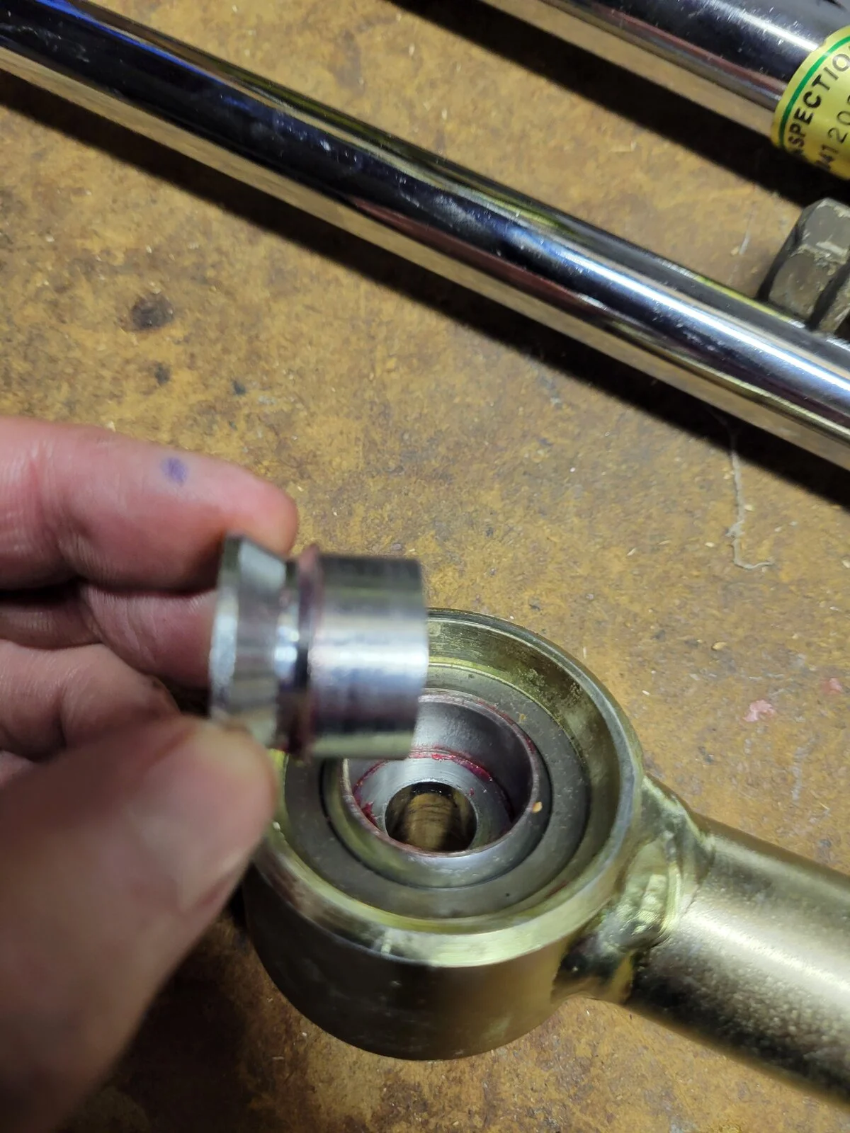

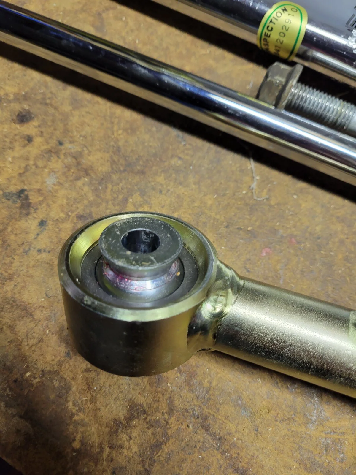

Finally got the adjustable track bar. My question is , do these metal 'sleeves' just sit loose in there? They slip out
pretty easy.
Those metal sleeves get pinched tight when you torque down the bolt. The bearing is the metal ball they fit into.
