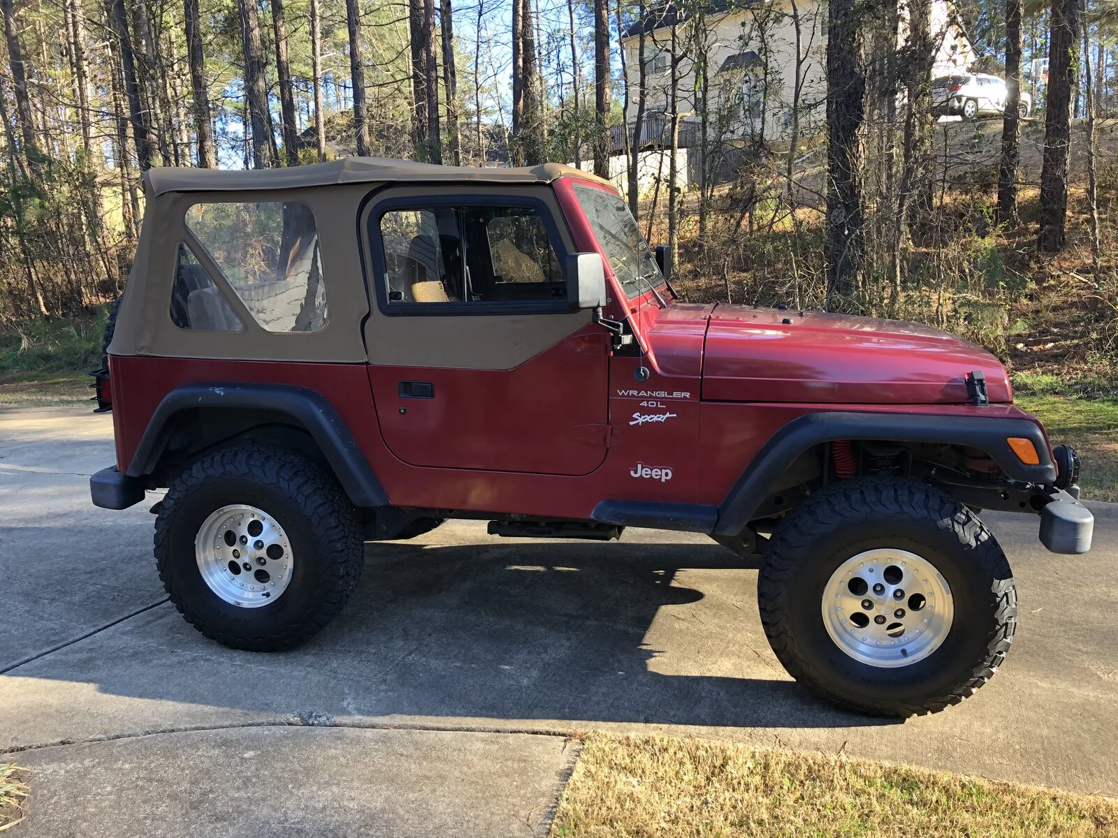

I am real happy with the Zone 2 1/2 lift I installed in 2019, made the ride much better and gave me room for 33"s.
