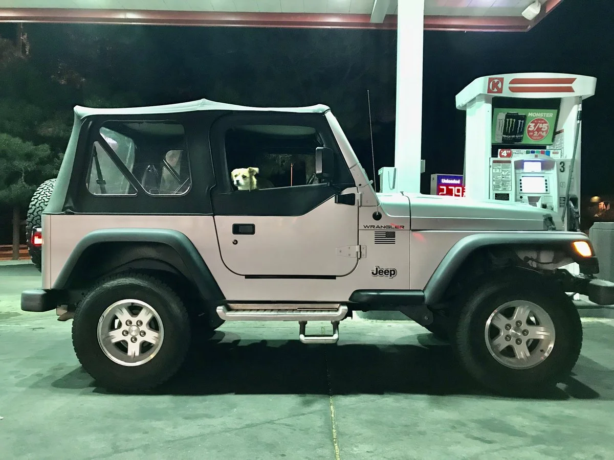

Thanks. Mine is an OME 2 inch kit with HD springs. I added an addition front coil spring isolator on top of the factory one to level it out. The aftermarket bumper, winch plate and winch had the front sitting significantly lower. With HD springs and the additional front isolator, it put me right at 2.5 inches of lift. I’m running 31” BFG KM2’s.
I got the ultimate kit from DPG Offroad that came with front and rear track bars, quick disconnect front sway bar links, longer rear sway bar links, a motor mount lift and a body lift. The motor mount lift and body lift aren’t installed though. DPG has many versions of kits available to suit your needs. I called and spoke to Dirk at DPG and he asked a lot of questions about my Jeep, what I wanted to do with it, future plans, etc and set me up with what I feel was a good lift.
I did replace the OME nitro shocks for Rancho RS5000x’s though For a smoother ride.

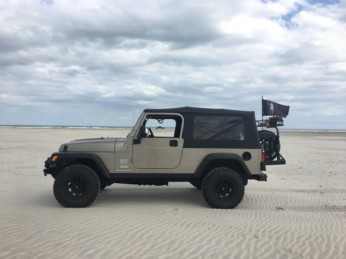

A TJ with 31s and a 2/2.5” lift is a very capable machine, and very easy to build. Here’s mine last year on 31s with a 2” lift.
I used to worry about awkwardly small looking tires too, but that perspective changes when you start to learn about suspension (especially up) travel.
The only, and literally ONLY mods at the time of this picture were 2” Pro Comp springs and shocks, a 2” rear track bar relocation bracket, and 31s on the stock 15x8 Ravine wheels. It took me anywhere that I wanted to go with zero issues. You’ll find many members here run this very same setup.

I really like the looks of that. Thanks for the reply! I was extremely impressed with what my jeep could do after taking it out this weekend bone stock except for 31s, so I bet this did great.
