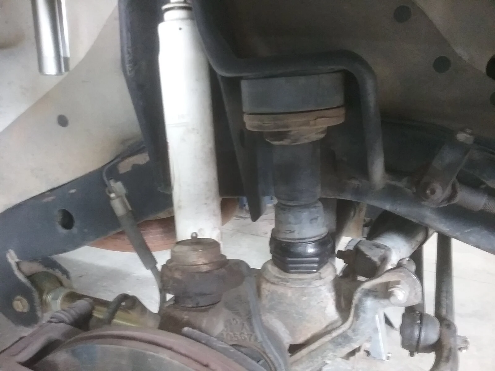

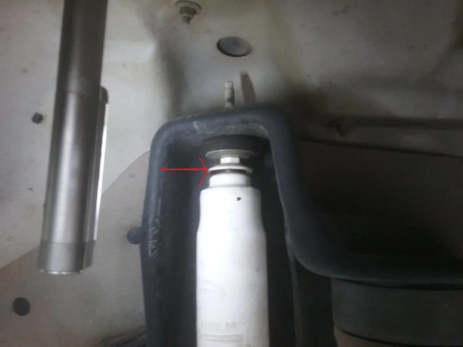

RS55239's with a 3" lift, 1/2" BL, at full bump with 1 5/8" bump stop extension,
Any less than 1.75" of bump stop extension and your shocks will then be your bump stop. So, with that said, how important is up travel to you? If you need 1.75" of bump, and only have a 2" lift, then you aren't gaining much over stock up travel. This is why many would suggest the 0-2" lift shock offering.
How much bump is needed for the matching rear shocks? Everyone says they run long, but you the first with real numbers 1.75”, perfect. Typically need that for 33’s anyways, so no loss. Just gotta be ok with stock-ish up travel or get longer springs.
I went with 2" of bump in the rear, but that was only because my Track bar was hitting the rear cross member in front of the fuel tank at full stuff.

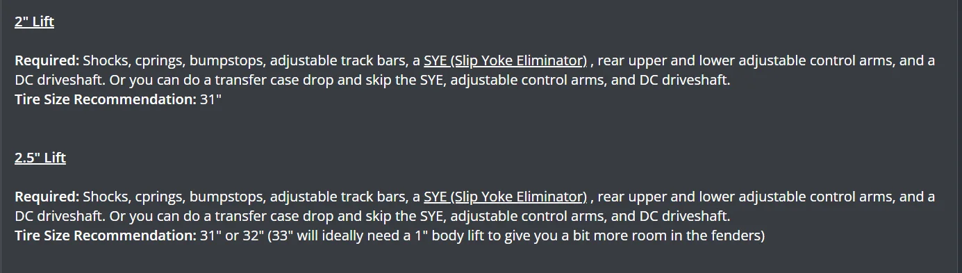

I'm a little confused.(I'm also way more of a noob than I thought at this). I had been reading your other post. Do you not need the control arms, drive shaft or adjustable track bars like in your other thread?
I have an LJR and I recently posted another thread about lifts and got schooled pretty heavily on it. I simply won't have the money to dump into a large lift and 35s for the unforseen future. I started looking into the smaller lifts but now I'm just confused. I have the savvy body lift 1.25", and the 1" MML.
Sorry if I'm being pestery. Here's the part of the post I was referring to:
Control arms are optional at those lift heights.
I am in the camp that I would do control arms regardless because the increased articulation and better joints you'll get from a high end control arm joint (Johnny Joint) are worth the cost in upgrade. In addition, if I'm lifting it at all, I want the ability to dial in my wheelbase and get things back to where they need to be geometry wise.
But for the person on a budget, you really do not need control arms at those lift heights and can do without them. Of course if you want to avoid the transfer case drop and improve ground clearance with a future tummy tuck, you're going to need those control arms.
If you're going for a small lift I'd keep that 1.25" body lift, add some 1" springs or so, and call it a day. Since you have the longer wheelbase TJ you won't need to worry about driveshafts or transfer case drops. That's a major advantage to the longer wheelbase.
I have an LJR ...
Those recommendations are for the standard TJ. With your LJ, the longer driveshaft makes things a little easier. For a 2" to 2.5" lift, you can probably get by without the SYE and DC driveshaft and adjustable control arms. You should not need a transfer case drop.
If you later do a tummy tuck, even a partial one, you might need to add those things, since that will push the driveshaft to an even steeper angle.
Adjustable control arms (good ones with Johnny Joints) will give you better articulation. But the OEM control arms are fairly flexy (by design) and should be okay.
The adjustable track bars are nice to have, but not absolutely necessary. You can run the OEM track bars, with a little bit of axle offset, and put in adjustable ones when you win the lottery.
