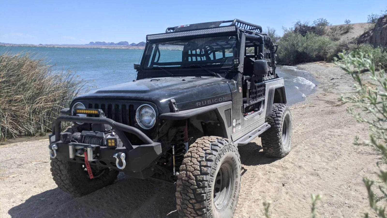

I have been slowly building my Jeep, I recently removed all the rough country stuff and replaced it w/ the Currie Short Arm w/ the double adjustable Jonny joints, Anti Rock, Currie correct links, Currie front and rear track bar, JE Reel Custom drive shaft. 5.13 gears, and now I think I ready for new axles, are these the go too? If not what's recommended? Also should I do the front of the rear first? Or is there somewhere else I should invest this money in the Jeep?
