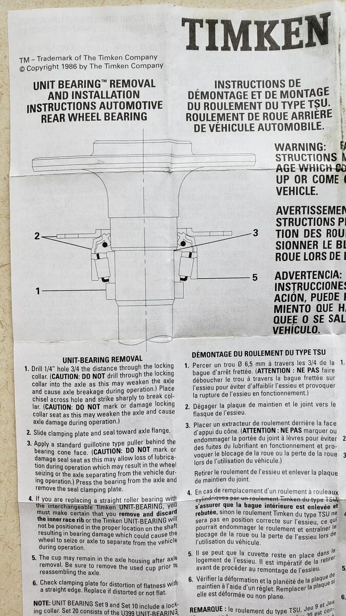

Hi all,
I have a question about the rear axle retaining plate (2006 Rubicon) - is the curved lip supposed to point inward (toward diff) or outward? I can't remember how it was originally, the service manual doesn't specify and I have conflicting info. The Timken instructions have it pointing outward, but most images online have it pointing inward. Does it matter?
Thanks. I have disc brakes, so I guess the Timken diagram is not appropriate. It threw me, since every photo and video showed it pointing inward.
That drawing, which is really about changing the bearing, may be a universal that serves as a generic guide focused specially around the bearing.

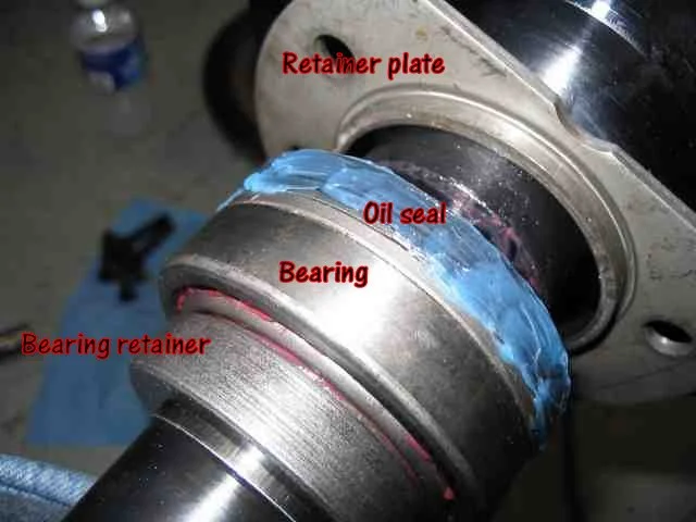

The above recommendations are right on, the raised lip on the retainer definitely faces inward toward the differential.
