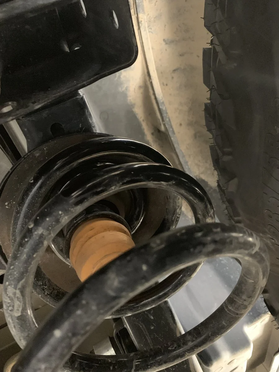

I just noticed the rear spring passenger side still is not quite seated it seems just a bit off still after it already Unseating could this be the cause of it just being off maybe a half inch from seated just right on the rubber isolator

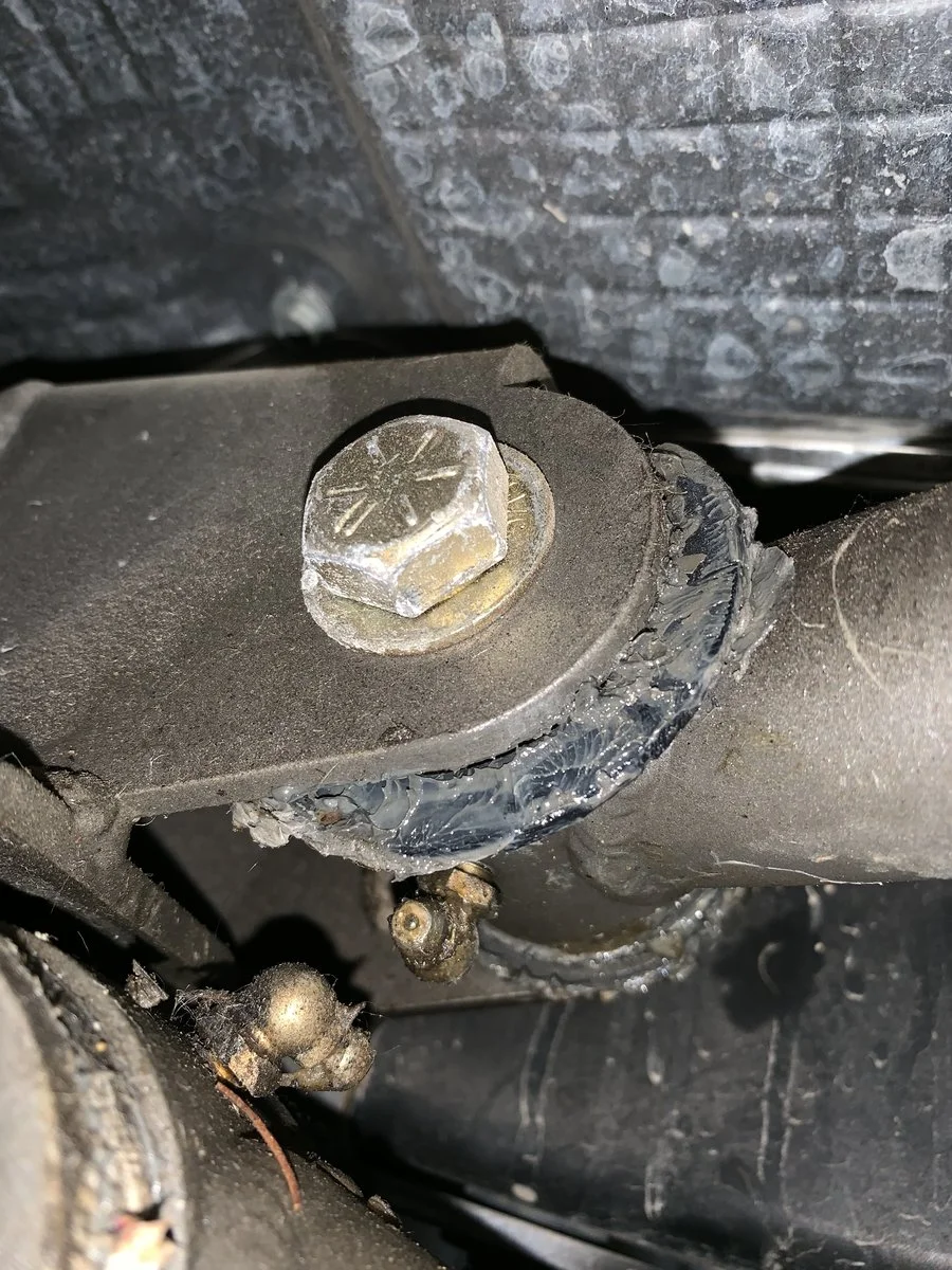

Update found a bad upper control arm bushing on passenger rear and reseating the spring correctly fixed a lot of the issue.
